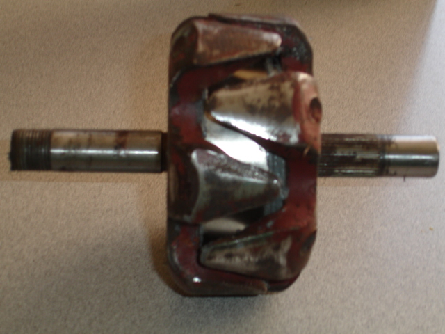

I currently have a very nice general motors car alternator.  It spins very freely, so start up should not be an issue.  Now I know, most of you guys will be smashing your heads against the wall, but I think this might just work.
For every one's knowledge, this is going to be more of an experiment than a permanent machine.
There are two main problems with the alternator.  First, there must be power to the field coils to start the generation process.  I was thinking of making a super mini vawt that will generate just enough power to start the coils.  I have done this before by using a small cheap dc motor.  Once it starts, the alternator will kick in and power the field coils by itself.  This leads to some interesting cut in wind speed theories/ideas that could get around some cogging / stalling start up issues.
Problem number two.  The alternator probably needs to spin close to 800-1000 rpm to cut in.  Obviously any kind gearing would be nasty and hard to work with.  I was thinking of carving some really fast blades, maybe 5-8 ft in diameter,(probably closer to 5 for the speed).  Does anyone here know what the cut in speed of a car alternator would be?
Also, i have 4 neo hard drive  magnets that I could possible replace the field coils with.  Any suggestions?

Very unsuitable in the factory configuration.
Best to look at some earlier work.
Ed has some details,
http://www.windstuffnow.com/main/gm_alt_mod.htm
I like the type with the magnets between the rotor halves.
I can not recall who made a specific one, but it was nice.  The magnets were from microwaves if I recall correctly.  He moved to a place without internet.
Not that I recommend it, but wind-blue makes a rotor.  The photos should show enough detail to understand it.
If in the common sizes, the 4 HD neos will not make much power.
Master Zubbly figured he could get 150W per cubic inch, and there is not many cubic inches in 4 HD neos.  Be quite lucky to get 10W with a good design.

This is pointless, the field needs about 40 W to do much so your mini turbine needs to produce at least 40W. If it doesn't and you use it to kick the thing off you need your main turbine to produce 40W before anything goes into your battery.That power doesn't disappear it has to be produced from somewhere.
Let's take a bit of a realistic look at things. A fast 5ft prop could reach 1000 rpm in about 15mph wind.  With a bit of luck it would  probably produce 60W at 15mph so by the time you have supplied the field you would end up with possibly 20W rather than the 60 of a pm alternator. If you have lots of high wind and you only want very little power then you can get something from a car alternator. For most people on a normal lowish wind site it is a very miserable way to get very little.
In the old days we had little luck with car dynamos and their field requirements were less and the cut in speeds lower. Alternators are a step backwards.
If you replace the wound field with permanent magnets then you loose the 40W of wasted field power but you add iron loss and cogging to delay start up and you remove some of the flexibility of the wound field and ease of load matching. It is still a pretty miserable thing but at least it will do something from about 10 mph upwards.
To replace the wound field with permanent magnets is a fair bit of work and a few scrappy magnets aren't going far towards a decent solution so in the end the whole thing becomes a lot of work for something with mediocre results. If you want to go that way then fine, you will have fun and learn a lot and you will find out the hard way what everyone else has been saying about car alternators for years.

if you are even going to get a fighting chance of making watts with an
automotive alternator, start with a large frame unit, such as one off a truck
and forget anything built by delco
(this coming from a guy who loves delco products
because of limitations explained by all who have responded, you will have to forego
any decent return on power until you get upwards of 15-20mph
now it is possible using a large diameter blade set, of perhaps 12 ft
and using a serpentine belt driven large frame alternator, reconnect in wye rather
than the much more common delta, in 20mph plus windspeeds to get some reasonable power.
folks don't like belt drives because of two things, efficiency hits, and safety when the belt breaks
efficiency can be quite good if done right, even up to about 10:1 ratio, and
if you use a brake drum with the brake backing plate, w/shoes and parkbrake cable
there is no reason that a reasonably industrious guy could not figure a way of making an auto brake for run away protection.
your going to have to remove the oem regulator in favor of a balmar or xantrex controller, both of which are programmable for the amount of power available to drive the alternator. this is very important, without the ability to match the blades power to the alternator it is just a non starter.
personally i think it can be done, but not cheaply. it will take a serious commitment in time and money to make a workable system that makes a reasonable amount of power.
even then in windspeeds below about 15mph the unit is just going to sit there.

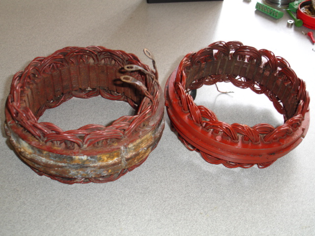

Had big doughnut neo's made, (N-35) 3 1/2 OD, 2 thick to replace the field
windings.  Seemed to be the best.
You will still have to rewind the stator.  My best was 19 turns of #16 per
coil.  Really hard to fit in, but do-able.  That gave me 31 volts, at what
I thought was 300 rpm, until I discovered my tach was on drugs.  Fair to
say less than 500rpm.

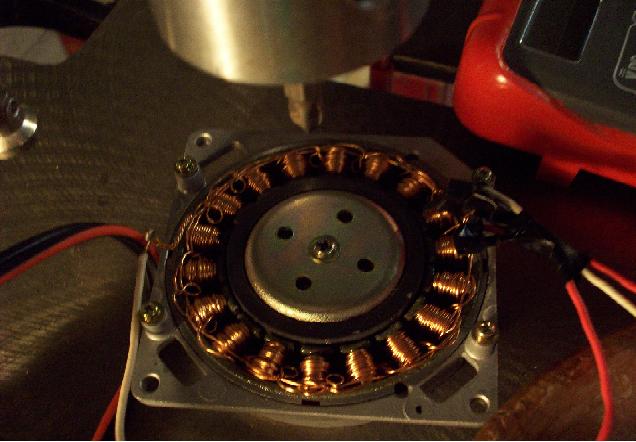

I just finished attaching 3 bridge rectifiers to all 3 sets of coils.  Each phase came to 3.3 volts and when wired together came to 9.92 volts at 2500 rpm.  I didn't see what the shorted amperage would be at that speed because I think I would burn up the diodes.  It must be at least 5 amps.
The motor has a round magnet with 8 poles and 18 coils, 3 phases, 6 coils per phase / all in series.

here is the motor for all of the data

The best output, in a usable form, that I managed to get out of those, is leaving them wired Wye, then feeding it into the low sides of 110:6 wall-warts wired for 3 phase.

Here is a rotor I finished last night.
It's a Delco out of 1986 Camaro, not sure what series it is but I think it's 100 amp.
I cut the shaft and replaced it with n52 3"x 1" disc and n45 3" x 1/8" disc to get the get the same width as the factory core.
Then I glued it all together with JB weld.You probably need the jaws of life to separate these but the glue keeps the two rotor halves from twisting.
It was not easy to make but it only cost about $60 in magnets and is one powerful rotor.
I made one out of a 10dn a while back and it peaked out at about 130 watts with 5' rotor and 6 high speed blades and guessing 25- 30 mph wind gust.
And I think I wound one of the phases bad because it didn't put out like the other 2.
Whith the factory stator, cut in speed was around 500 rpm but I wanted it lower.
As you can see the one stator is much smaller.
I plan on making a second machine with factory stators and connecting the rectifiers in series to hopefully get a decent cut in speed.
So I agree, get rid of the factory set up and go with a good powerful ring or disc magnet.
Its a little work and you need some tools but it will put out some useable power.
