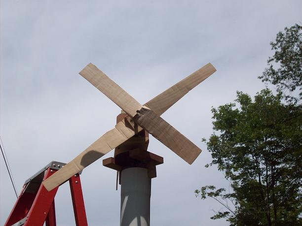

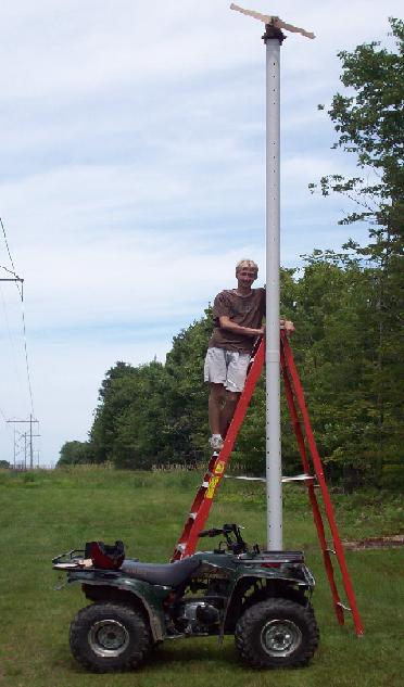

This afternoon, between my twin brother and I, we managed to get our 30" cnc bladed windmill on top of a 20 foot pvc pipe tower.  As you could imagine, holding a 15 lb windmill on top of a 10 foot pole while you are standing on top of a 4-wheeler in flip-flops is no easy task.  Here is the finished product.

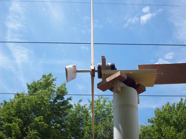

During the last 3 days, I spent about 6 hours carving a new 20" blade for my mini motor.  My goal was to hit 3000 rpm at 10m/s, which after testing was certainly achievable.  The bad thing was that I chose maple as the material, which was way too hard use my spoke shave to cut the darn thing.  So I looked around and found a really sharp 1-1/4" wood chisel.  This worked much better, especially because the double blade was so small.  Here is the finished product, sorry that doesn't show much detail.
As you can see I decided to mount the new blade straight to the old windmill, giving it 4 blades.  I found that this helped start up speeds considerably.  After watching it for a while, I rotated the front blade so it lined up with the back blade, like an old biplane.
In a couple of minutes, I will have a video uploaded of it in action, and the how much the pole was bending.

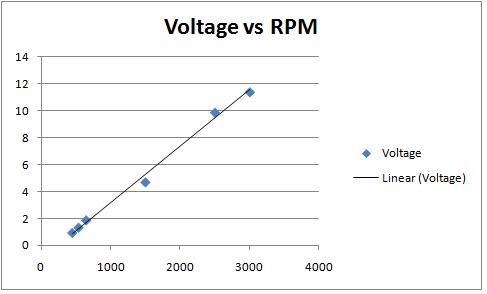

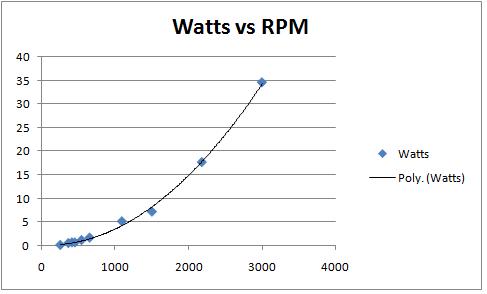

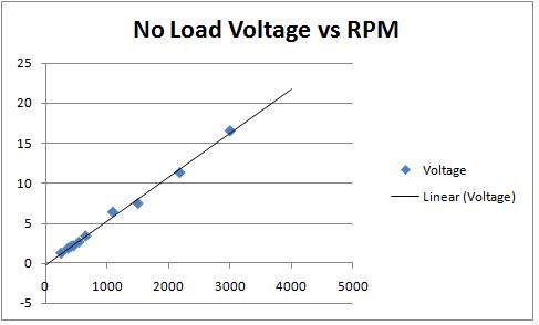

Here are some nice little graphs that I put together with the data that I got from my new brushless 3 phase generator.

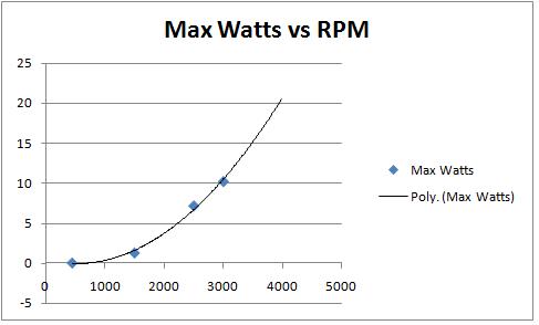

After about an hour of work, I finally got the performance data for my 30" CNC windmill, which would be the most relevant data.  My max output was 20 watts in the wind, which puts the blade rpm at about 2300 rpm.  My testing equipment was basically a drill press that went 250-3000 rpm.  I was a little wary of putting 8 amps into AA batteries at 3000 rpm.
Re: 20 Foot PVC Tower (3.00 / 0) (#14)
by taylorp035 on Thu Jul 16, 2009 at 02:47:58 PM MST
After figuring out the expected wind speeds based on a TSR of 8, the wind speeds should have been...
  1. rpm  - 7.25 mph
  2. rpm - 12.16 mph
  3. rpm - 16.73 mph
  4. rpm - 24.3 mph
  5. rpm - 33.4 mph
Therefore my 20 watt max came at about 26 mph.  Based on that the efficiency would be 4.65%.
