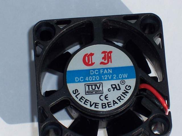

The pictured fan is the stock fan from one of my inverters. Its the only one that didn't make any noise. (Figures, I burnt that inverter up) I replaced one of the bad ones with it... but its noisy now too.
I found a few... that are BB, but the watts are higher... really don't want that. But I'll try some... just wondered if any one had replaced theres. They are very loud and noisy... out of the box.

Most of the fans I found have the CFM on them. I couldn't find that info on the stock fan. I would think the BB fans would be a lower wattage... but they might move more air.

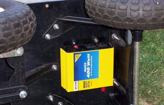

Its been rebuilt, and just about everything is DC now... and I use a 400w at the track (700w at home). The fan in the 400w is twice as loud as the 700w.. was that way from the start.
I'm sure I don't use the inverter to its full potential but I'd like to have some fan in it.. found one, about a third of the wattage... just have to modify it a little to counter sink the nuts.

Its not an "air movement noise", but a bearing/bushing noise. Of the 4, 700/1400w inverters I have, three went bad after a days use. Of the 2 "NEW" 400-500w and 3 used 400w... they are much worse. The 500 maxx (looks like a B&D model) is so loud I might as well have a gas generator running!
Some good ideas but its only a little 40mm X 40mm X 20mm 12volt fan, inside an inverter. Might try a switch, or the resistor.... or maybe both. Would have liked to find the "specs" on the stock fan so I had something to compare it to. I've found fans with 7 different RPM's and multible CFM's, amp, and watt ratings. The fans I have coming are at the high end in RPM, but about 1/3 the wattage.

Vector and B&D are in bed together, maybe with Craftsman.
The 24V fans, rated the same in all other respects, should be a decent choice.
Or a 12V version with a 51 - 56 ohm 1W resistor.
