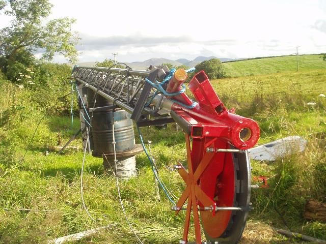

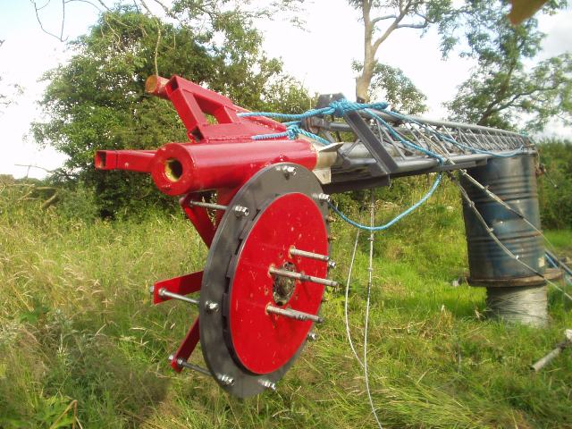

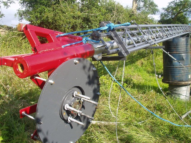

Alternator fitted and assembled

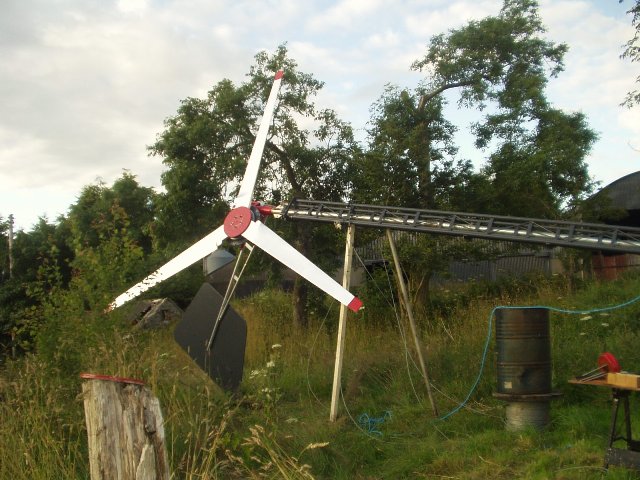

On with the blades and tail

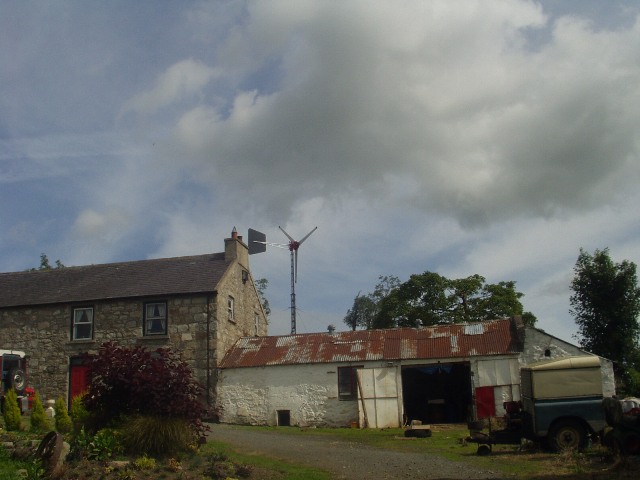

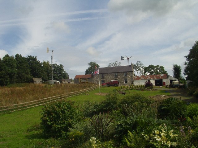

Up she goes

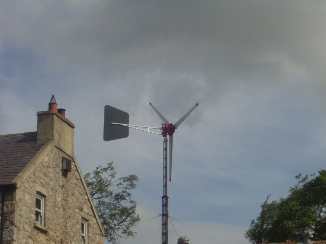

It immediately faced into the breeze and started to generate
With a gentle breeze at about 10-12 mph it is producing about 500 watts

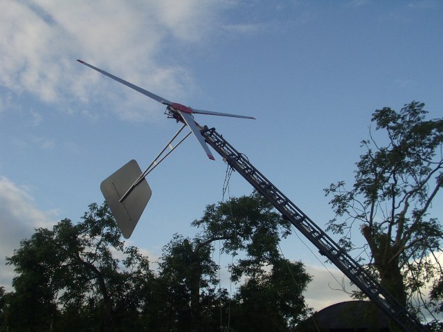

Next day we got our usual 15mph winds with gusts to about 18mph and it is making over 1kw. I have since seen over 2kw at about 25mph with the tail starting to furl. One slight hitch was that the blades were noisy, it sounded like someone swinging a length of hose pipe above their head. The fix was easily found via a google search of this site! I slightly rounded the leading edge tips and this fixed the problem. I was able to do this by climbing the tower rather than lowering it again. While I was up the tower I took a couple of pics of the Northern Ireland countryside
So that's it! Well almost I need to extend the power cables to the tower this will let me extend the tower another 20ft to give a total of 60ft, I also need to refit the upper guys.
Next project is to rebuild the 12 footer, I will do it the same as this one with the land rover stub and bearings and a new 60-70 ft tower so plenty to do.
I will do a further update on performance but so far it is looking good, no sign of stall and the tracking of the wind is within a few degrees, just need to see it furl! but with high winds forecast for  this Wednesday  we will soon know.

This might seem like a dumb question, but I'll ask it anyway... Looking at it, it seems as though the tower is able to telescope?
Steve
Re: Magnets with a capital T part 3 (3.00 / 0) (#5)
by Hilltopgrange on Mon Jul 20, 2009 at 09:40:45 AM MST
Hi Steve thanks for the comments. Well spotted yes the tower is telescopic, I originally built it for a ham radio antenna with 3 sections of 35ft but I lost interest in radio and adapted it for turbines. I had to remove the third section as it was to light but I have now replaced it with a heavy gauge tube. In the pics the tower is only half extended as I need to get more cable, so it is only at about 45 feet but as I am in a very high wind area its not such a big deal. I hope to have the cables extended this week so I can crank her up to about 70ft, this is done with an electric winch mounted on the base post, the same winch also tilts the tower.

Do you have any tilt degree from Hub to Yaw bearing Pipe?
From the pictures it looks to flat...and blades may hit the tower if they bend in high winds.

Hi Goahead, the alternator is tilted by 5 deg there are better pix of this in part 2.

This pic shows it better
