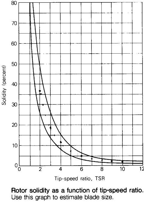

Re: GOE 222 profile (3.00 / 0) (#18)
by SparWeb on Tue Jul 28, 2009 at 12:28:10 PM MST
SamoaPower,
Hey we haven't heard from you in a while.  Good to know you're still out there.  How have your projects been going?
Of course I thought of that graph, but I actually decided to not use it.  It's not a "prescriptive" graph, even though it makes a point about the interrelationship of these two factors.  I would rather point out to the OP that the load imposed by the generator is MUCH more important at determining the operating TSR of the prop, and some given wind speed, than the angle of the blades.  This is counter-intuitive, but there is a way to explain it - it would just get me side-tracked from the point at hand.
Steven Fahey
Re: GOE 222 profile (3.00 / 0) (#19)
by SamoaPower on Tue Jul 28, 2009 at 02:05:58 PM MST
Steven,
Good to see you're still bright and bushy-tailed about RE. Most of my projects have been put on indefinite hold due to some health issues but I still lurk about. Only thing really going at the moment is evaluation of Lithium ion batteries for RE. I'll post something once I have some conclusions.
I believe that graph was derived empirically from existing designs at the time rather than from a hard analytical process. Could be wrong.
I guess I look at that graph from the opposite direction from what you elude to. Rather than determining a TSR from solidity, I think the usual rotor design process picks a design TSR and uses that to select solidity.
I certainly agree that other factors can have a large impact on actual running TSR. I don't quite understand your comment about blade angle however, as solidity is about rotor area.
