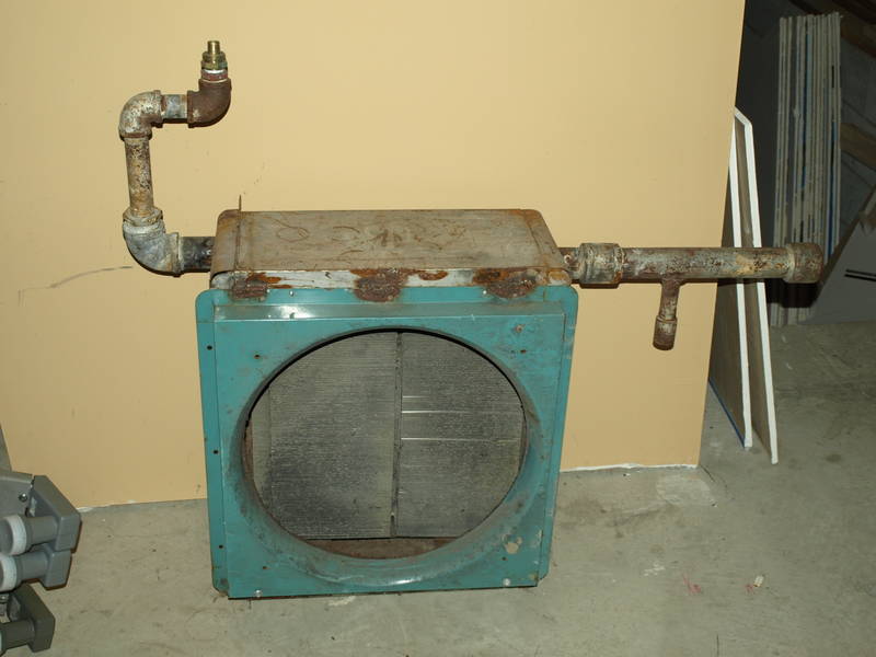

 need a hand with the math. Outside air averages at 25C to 30C I would like inside to be around 21C. Well water is at 10.5C. Im thinking I need about 12000 BTU output so just wondering how many gpms of water i need.
i just found this heat exchanger for sale wondering what you guys think of it would it be a good one?

 That apeares to be a steam heater, getting 12000 btu out with a low DT may have difficuty, but should do something.
As that you do not drink the water, and is most likely surface water, adjust you pump so as to have very little temp rise from in to out, and make sure you are not pumping the well down.
 If you can measure flow and temp of the water going in and out you can figure BTUs,
 It is better it have more HXs in line and have a higher DT on the same water flow than to pump more water. So if you don't get enough cold, add more HXs
 If your garden is for food, test the water and make sure there is no nasty stuff in any parts you use, or it will be in your food.
