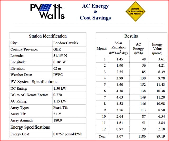

Im currently looking at construction of a 1500W solar array..
Hi I've had a bit of a search etc.. Please be gentle!
My daily usage is 11KWh
I have 1000Ah of 12V...
I'm looking at seting the system up for 24V
so basically my maths are say 7hrs of average 1KW gets me about 7KWh a day..
so at 24V I need  291AH  is that right?  so the remaining 710Ah is usefull for a rainy day...   I read somewhere of a 50% rule.. so really I should never use more than 500Ah
also whats the best way to config the panels... they will be DIY (i undersatnd the pitfalls) would you split the panels with 2 charge controllers? what CURRENt size would they need to be...and what peak current should I espect from my array...
Can you get a seemeles changeover unit??
Im looking at using a 3500KW inverter...
would the syatem work.....? I.e   should I expect an average of 7KWh a day with 1500W of panels in the uk..
What if I add a turbine.. say 500w  would it be enough to then get me off-Grid?

 If you can make 1500 watts of panels, and can get 7 hours of full sun a day, at 24 volts you will see about 64 amps, split in two arrays thats 32 amps per array.  now batteries, you have 1000AH at 12 volts, if you can reconfigure them to 24volts, you will then have 500AH at 24 volts,
 So your math is close, if everything is perfect, no clouldy days, no broken panels, no losses, no other problems,

Your intention of "Seven Hours" is way off mark, with solar the reality is a window of 2-1/2 hours time on either side of Solar Noon is where the majority of power is achieved, calculate for that and anything gotten outside that is a bonus.
Trackers are problematic even if a complete store bought system ie: that extra money would buy more panels so where would the benefit truly be.
Use the calculator provided for your location to get a true picture of energy available!
(**The Gulf Stream warm water currents that keep the UK's temperature mild are cloud makers - I assume opaque cloud cover is calculated into both the following links)
See the "A concrete Example" near the end of the Blog entry.
For 1500W PV array in London England (using http://rredc.nrel.gov/solar/calculators/PVWATTS/version1/)

My god is it really that bad for the uk?
seems like a complete waste of money...

Look up "solar hours".  This is the equivalent amount of noontime unclouded sun generation you'll get per day on a panel at your location which is facing the south, tilted at the latitude angle, and not shaded by clouds, trees, nearby mountains, perched birds, or your neighbor's buildings.
Solar hour averages (summer, winter, and spring/fall) are available for most areas.  They take into account things like atmospheric attenuation from latitude and typical wind patterns.
Around where I am (latitude 38ish in both California and Nevada) we get about 5ish solar hours per day.  You're latitude more like 44 (more atmospheric attenuation, shorter winter days) and have a lot more cloud cover.
Solar power is currently only competitive with mains power in new construction in rural areas, where the cost of the system is low compared to the cost to the customer of running grid power for a few miles.  If the panels get down to something like a dollar per watt - or the price of mains power about quintuples - and the new battery technology gets cheap due to its use in hybrids, it may become competitive for sunny suburbs at my latitude.  For GB, with its higher latitude and non-clear skys, it will take more.
So don't expect to save any money from your installation (short of more of a financial upheaval than we've had so far).  It will cost you something like five times your current power bill for the next seven years.  (Which means you could invest the money and run your house on power bough by the proceeds forever.)  If you get some other benefit from your installation (fun, green pride points, feeling of self-sufficiency) that is worth four times your power bill for the next seven years, go for it.

7kWh per day from a 1.5kWp array into batteries..? Nope, I don't think so.
I'm running with 1kWp and 440Ah of 12V batteries configured as 220Ah at 24V into a 1kW inverter and can get about 1.5-2kWh per day in the summer months and now the days are drawing in and it's getting hard to use 1.5kW and still get the batteries to go up to their absorption voltage for enough time to get a full charge.
Like others said, peak generation is about 4-5 hours around solar noon.
I still have to judge my evening use of the 28" LCD TV by the next days weather forecast...
You'll find you have to use a chunky grid charger in the winter to avoid the batteries rotting through partial charge. An overcast day (not stormy black) means you'll see about 1/10th the usual peak "sunny Amps".  Rainy day?  Maybe 1/100th of peak "sunny Amps".

You need more battery, maybe double!
