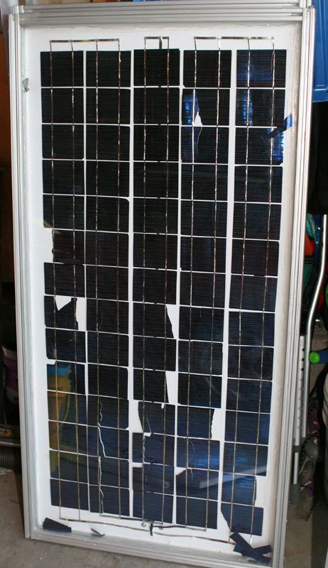

by ghurd on Thu Oct 01, 2009 at 01:04:06 PM MST
Potting is almost a requirement, for solidity if nothing else.
Notice the upper right, and the bottom...
http://www.otherpower.com/images/scimages/12186/_Strider1_my_pictures_digital_cam_Damaged_package_IM G_6268sml.jpg
The nitrogen thing has been done (professionally) a few times.  It didn't work.
Re: Better Homemade Panels (3.00 / 0) (#9)
by springgrove on Thu Oct 01, 2009 at 06:46:15 PM MST
Great picture, hope it wasn't your panel.

Today I picked up some 1/2" aluminum U channel and attached it to the edges with Silicone II.  It's just the right size.  This is a rear view.
So another day or two of drying and I will take it outside.
One other note.  The unit seems very solid.  There is basically two sheets of glass with a solid core of silicone between them and I wonder if tempered glass is really required?????

The panel is finished.  Here is a picture.
With the u channel frame it feels even more solid.  Next step is get it mounted and see how it handles the elements.  The days are getting shorter here (North of Chicago) and winter is on the way, so it will not see much heat for a while.
I feel confident it will hold up, we shall see.  I think I am going to build another one.
Will update how it works as time goes by.

Thought I would throw in the cost.
Cells   75.00
Glass   50.00
SiliconeII  and Such  45.00
Aluminum Channel 15.00
Total  185.00

great looking panel how many watt panel is that ?

Don't know yet.  When I get home from work it's already dark (6:00 PM).  I hope to do some testing this weekend. Hopefully we get some sun.  Winter is on the way.
Re: Better Homemade Panels (3.00 / 0) (#36)
by springgrove on Sat Oct 17, 2009 at 11:30:35 AM MST
Saturday 10-17-2009 1:00 PM (Testing Time)
The sun was in and out so I decided to do some testing.
Open circuit voltage 21.1 VDC
Max shorted current 3.79 Amps DC
Happy with the results.  Again the unit felt very solid as I carried it around.

Oh, forgot to add that the outdoor temperature was 48 degrees Fahrenheit.

   Nice looking panel. I hope it lasts. I have the cells and have been debating on the best way to make a panel. I was a process engineer for an electronics company and used many types of potting compounds. There are 2 types of 1 part silicone, one type releases Acetic acid when curing - this is your everyday silicone. It usually says it on the package and has the vinegar smell. The other type is for electronics. Both absorb water from the air to cure( and release a byproduct), which is why they recommend a max layer thickness of 1/4 inch or so. In a sandwich construction like this the silicone away from the edges may never truly cure which affects its mechanical and electrical properties. The specified properties are for a fully cured product.
   A 2 part silicone such as Sylgard would be a much better potting compound. Also since the black cells will heat much faster than the front glass, a very soft silicone is preferred over caulking type silicone to prevent cracking due to thermal expansion. Also if there is an impact or deflection of the front glass, there is less chance of cell damage with the softer silicone. We have large hail here so I have been hesitant to use any design which places in contact with (or bonds) the cells to the front glass.
   My plan was to bond the cells to the rear glass with a dab of silicone in the center, leave some of the tile spacers in place to support the front glass, put in some desiccant seal with silicone.
   I will be watching your thread and hopefully you will have some results by the time I actually build mine.

Just making similar panels using qsil 218 from ACC silicones...
http://www.acc-silicones.com/products/encapsulants/opticallyclearsiliconeencapsulants.ashx
 its a 2pack Optical clear silicone encapselent for solar cell encapselation.. it works excellent.. wil post spme photsos soon... had 2KG as a sample :-) for free!!
