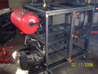

Well, this is my first diary entry and I promised
some of the vawts guys some pic's of my project.
But first I had to get a camera, last one broke.
This is the bottom half of the frame, and one of the rotors I was playing with.
This section bolts to the bottom half, I can go up higher if need be
just add another section.
Dang don't you just love a water jet. Oh yeah and somebody to guard the parts.
More water jet parts, and one of the most inportant parts N40 Neo's
Now you know what they are for.
Got to keep the batteries warm. New battery box with a built on charger.
Had to throw in the tickle charger for the Hawt's Guys
Still waiting for the rotors from the water jet Guys, so that's all
for now.

vapmk , yours is exactly the sort of geni i,m working towards, that is, a large diameter rotor with lots of poles hooked to a savonias type. i'm very interested what your output will be even at the test coil stage. please do keep us up to date as the machine progresses.nice fabrication,a very strong and stable support platform. the modular feature is great and i think your gonna' need it!

« Reply #7 on: February 18, 2006, 05:32:51 PM »
electrondady1,
Will do, on the coil testing stage. Been keeping an eye
on the jerryrig debate, I think it could be advantageous,
with the torque and slow rpm of this type of setup, with
the large and many pole/coil rotors.
« Last Edit: February 18, 2006, 05:32:51 PM by zapmk »

« Reply #10 on: February 19, 2006, 02:05:46 PM »
Yes, the Alt rotors are big 24" and no data as of yet.
Going to be many things to work out.
DanB had point out that with rotors this big
I'll have to watch out for
bearing play and rotor wobble (plate flatness) so I'll
have to wait till they get back from the waterjet and
mock it up to the spindel and then go from there.
Might need to have the rotors surface ground for
flatness.
Flux had pointed out that the inturnal resistance
for a 8 coil prephase wire in star is going to be high.
So as you can see, I'll have my work cut out for me.
But it going to be fun trying :)
