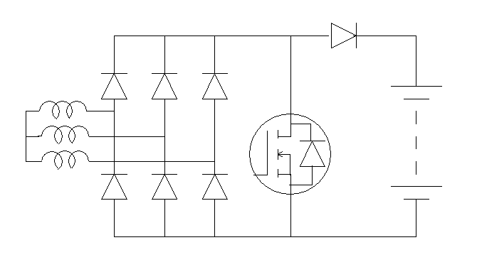

For anyone wanting to boost a motor conversion or a smartdrive you may like to try this way.
The inductors are the winding leakage recatance of the machine so you don't need to add anything. You will have to switch at a fairly low frequency to prevent serious iron losses and to cope with the slow bridge rectifiers (less than 5kHz at a guess).
If you want to avoid the drop of the series diode you can leave it out and replace the 3 bottom diodes of the bridge with mosfets and gate all three together. Your mosfets now have to be rated to carry full load bridge current.
I don't think you have enough inductance to do it with an air gap machine. You will have to add inductors. To do it without introducing lots of resistance the inductors will need to he high frequency ferrite ones and you will need fast diodes in the bridge and chop at a high frequency. You may need capacitors across the machine output but before the inductors to stop the high frequency producing losses in the magnet faces. I haven't tried it, it means a far less robust bridge but should be possible and you have the prospects of a lower harmonic rectifier. With clever sinewave pwn to each mosfet you could make a true low harmonic force commutated rectifier, but I think driving all fets together would be more practical.
More ideas to think about.

I'm missing something here, If we took out the series diode and replaced the lower three diodes with fets, wouldn't the "main" fet short out the battery, and as such turn rather sickly.........
What did I miss here?.............oztules

Sorry. I was trying to save having to do another drawing. I should have made it clear that the 3 fets in the bridge replace the single one.
