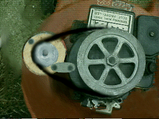

The starter and engine turn clockwise, if the starter turns counter-clockwise, then the starter is turned pulley downward and it is connected to the blade end.
When the starter motor is energized it automatically pivots to the left and tightens the belt, When the engine starts it pivots back to the right. a return spring keeps it in parked position while engine is running. I know this is a crude animation, but I guess you get the basic idea. Hope a few of you guys find this useful! It's a TurboCharged starter for a 3.5 even an 8 or 12 HP engine for that matter! Have Fun! (:>) Norm.

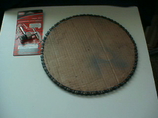

I've just come up with an idea that will work for you. (1) Cut
a 12 inch diameter disk out of cardboard.(2) Cut a standard
bicycle chain to fit exactly or just slightly loose, if it is
loose, cut another disk slightly larger until you have one that
will fit inside the chainly snugly, now you have a template
that you can use to....(3) Cut a 1/4 inch plywood disk and (4)Fit
the chain around the disk, preferrably it shouldn't quite fit
take a hard rubber mallet and tap the edge of the chain into
the edge of the disk all the way around until you can connect
the chain link, you now have the middle section of your secondary
flywheel ....A Chain Gear (The small chain sprocket (
Briggs & Stratton that has chain drive for a self-propelled
mower will mesh quite nicely into the Chain Gear.(you can then use a regular Briggs & Stratton starter from  an 8-12 hp. Briggs after you replace the starter gear with the small chain sproket)(4)Now cut
two more plywood disks 1/2 inch larger diameter than your first
plywood disk, these will be the top and bottom plates of your
secondary flywheel ...with the Chain Gear sandwiched in between
them (like an Oreo cookie). (5) Remove the blade and blade
clutch(the hub that the mower blade bolt onto) take the blade
hub centering it over the plywood disks marking the bolt holes
and drilling holes in the disks so this flywheel is bolted on
in place of the blade. I will be making this also so I'll have
pictures in a couple of days to show exactly how to do this
any questions just E-Mail me (peppysue@suite224.net) Norm.

Here is a couple of pics to get you started the 12 inch diameter template was trimmed down about 1/8 inch for the 38 link chain to fit. Chain tool kit can be bought at Walmart for about $2.84, if you don't have one.(Remember to use standard chain, not multi-speed chain) from this template that you have made you can cut your plywood disk.http://www.fortunecity.com/marina/titanic/664/index.htm .I will put this project with more pics as I progress.Norm.
« Last Edit: September 06, 2003, 08:33:14 AM by Norm »

Okay.Now it depends on one thing, if looking at the sprocket end of the starter, which way it turns as a lawnmower engine turns clockwise as for the one way clutch, the engine already has one...its the rewind starter clutch, simply bolt a sprocket to the reel that holds the windup rope. I suppose if the starter motor turns counter-clockwise you could put it upside down. Sounds like those starters have a built in reduction similar to Chrysler starters. Well anyhow this has helped me with the problem of providing electric start. I expect to have pictures of the setup in about a week. Keep posted and Have Fun! (:>) Norm.

BTH: You were right on that part about it not being a biggie, had a starter motor for a 12HP Briggs, just had to put the brushes in the opposite holders and bingo turns in the opposite direction. Replaced the starter gear with a 6 tooth chain sprocket driving an 8 inch bicycle sproket that replaces the plastic reel that the rope wound up on. This ought to be big enough to start this 3HP Briggs. (Which answers the question that was posed by... Jubalearly? How do I put an electric starter on an engine that never had one?)
