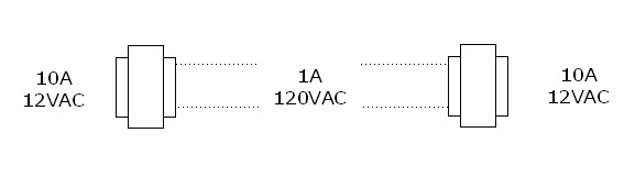

Hi TomW,
Thanks for this diary - I also have the same sort of distance to conquer. It will be interesting to see the cap/induction circuits that show up here.
Please don't shoot me for this idea - I'm playing now with a couple of 120 to 12 volt, 10 amp transformers which are quite cheap - thus:
No caps I realize, but a pretty cheap way to reduce amps on the main lines.

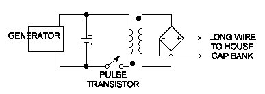

Inductor current-handling capability is more important than it's inductance value.
This circuit is essentially the same thing as a high-efficiency 1:1 DC-DC converter, just a much larger scale and you're only transferring high voltage emf spikes, not primary current.
Scavenge a microwave oven transformer and dispose of the windings.
Rewind it with a bifilar winding of something like #12 magnet wire, as many turns as you can fit on the core. The exact number of turns doesn't matter much, just fill it up.
What's important is that both windings are basically the same impedance and the overall inductance ends up being very high.
Just about all the basic circuitry needed is already posted on this list.
Charge a large cap directly with the generator. Use a 555 based pulse circuit (PWM) to drive an optocoupler. The optocoupler controls a power transistor(s) in a darlington arrangement. That power transistor pulses the capacitor across the transformer primary.
First use a low pulse frequency and adjust the pulse-width for maximum emf output. Then turn the frequency up.
The first phase of the secondary output will be at the same voltage as the input capacitor. The second phase will be the inductive pulse, after the transistor shuts off.
Use a 1kv full-wave bridge rectifier directly across the secondary. The DC output from the bridge is the sent down the long wire to the HV caps at the other end. Those receiving caps need to have at least 400v tolerance. The more capacitance this HV cap bank has, the better.
You then connect the HV cap bank to your larger discharge bank through a heavy inductor so that no HV spikes can hit the LV bank.
As long as your receiving capacitor bank is never drawn down BELOW the generator voltage (at the cap on the primary), ONLY EMF will travel the long wire. This means the wire can be pretty thin.

Ok, here's the deal.
The series-inductor method still uses primary current on the wire. That's a bucking configuration and it's a very efficient way to directly step down the power from a high voltage source and efficiently charge caps at lower voltages. Say, you have a 110v generator in the house. Just full-wave rectify the output into a cap. Then use that bucking inductor to charge your discharge bank using PWM before the inductor and a rectifier to collect the emf which also goes into the cap. The caps charge at nearly 100% efficiency and you can stop at any voltage below your generator voltage.
This is why I've posted that DC-DC converter tutorial page in various places in this message base. I stuck another diary page in with that page linked.
http://www.fieldlines.com/story/2004/2/18/64547/3106
The idea behind what I'm really talking about is PURE EMF TRANSFER.
All these PWM DC-DC engineers don't seem to understand the full power transmission potential of what they're working with. They build these into small inverters and assume that emf collection behaves just the same as DC in resistive circuits.
This very similar to the way RF oscillators can send huge wattages down a hair-fine wire with almost no loss.
The main difference is that these simple PWM systems transmit power not as  "oscillations" or AC. It's a steady stream of uni-directional impulses that are almost pure potential with no "current" involved. This is Tesla's "longitudinal wave" discovery. It's the method of energy transmission that caused him to declare all of his own AC systems a complete failure. Nobody paid any attention because they were already wired fully for AC. Tesla would have been better off if he'd just left all of Edison's
Anyway....Tesla method....
Isolate your low-voltage, heavy current to a very small, low impedance circuit (1:1 transformer primary), in impulses that are of a width just short of building a full-field in the transformer core.
On the secondary, with a scope, you'll see the primary input pulse as a half-wave of the same voltage as the primary. When the primary pulse cuts off, you then see an emf "needle" on the secondary that can go up to some pretty extreme potentials. This is why you need a 1kv full-wave rectifier. You don't want to lose any of the emf if you can help it.
If you have two batteries of exactly the same voltage, one feeding the primary and one receiving power DIRECTLY from the full-wave rectified secondary, you would see no current flow DURING the input pulse on the primary.
Making sense now? Same voltage on both sides of a 1:1 transformer means NO CURRENT FLOW in the secondary winding during the input pulse to the primary.
BUT, the EMF is a much higher potential and ONLY IT is able to go higher than the recieving battery voltage in order to pass through the battery and the 1.2v rectifier voltage-drop. But, the EMF spike from the inductor is NOT what you want to hit the battery with. The EMF will charge the battery. But, not efficiently at all because of the impedance mismatch. The battery has difficulty translating pure potentials into real charge.
So, you dump a bunch of emf spikes into a cap, ramp-charging it very efficiently, until it's high enough above your battery voltage. Then dump the cap across the battery. WHAM! The caps easily translate the emf impulses back into usable current.
The rectified EMF from the secondary will easily travel a long way down a thin wire since it's not ANYTHING LIKE inverted AC power. AC power still has an "electron current" and is subject to wire resistance.
This system is really a "transmitter", not an "inverter". The capacitor is your "receiver" in this case. Very high efficiency.
You could do this with nothing but a simple "buzzer" circuit on the primary and still have fairly high efficiencies. But, Transistors make a lot less ozone and they last longer!

I just noticed the schematic posted by charged in here in Toms diary  and it shows almost exactly what I am doing. The main difference is I am currently using a mosfet instead of a transistor it may not be the best choice but its what I have at the moment. One thing I have to do is give (charged) the credit for getting me started on this idea. Anyway, Tom, I really feel that this particular line of experimentation has great potential.  Keep it up.

I added another link in the diary. Just substitute the 1:1 transformer for the HV coils they're showing. Basically what we're doing here is building a sort of CDI ignition system, but with low voltage.
