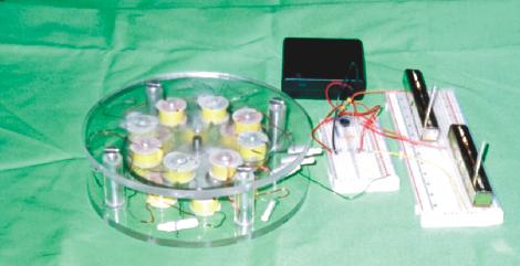

Here's a photo of Permogator 1.
Tested the tachometer and found it was spinning about 650 RPM. Way more than I thought. The tach works good. It generates a laser beam and counts reflections from a little piece of shiny tape you have to stick on what it is you want to measure.
I rebuilt the bearing, using some roller skate parts. The abec 7 bearing made a nice hub and the plastic spacer fit nicely around the 1/4 in shaft, resting on the inner ring of the abec 5 bearing (1/4" bore, 5/8 diameter) that was inserted into a nylon shaft collar, glued to the unit. One thing I don't like about it is the set screw. From now on I'm using aluminum, one piece shaft collars, which fit around the bearing evenly and don't torque it on one side.
Nevertheless, hardly any friction on this set up. RPMS went to 950 with the same input. I added two more AA  batteries in series and coaxed it up to 1250 rpm. That generated 1.7 volts!
I ran an endurance test with two 1800 mAhr and two 2100 mAhr batteries. Average rotation for 8 hours was 941 RMP, average output volts were 1.48. At 8 hours and 10 minutes the batteries output was 4.4 volts, which wasn't enough to fire the 555 chip and ended the test. Based on my previous calculations, 1800 mAhrs times 4 batteries is 7200 mAhrs used. 8459 mAhrs were generated. Efficiency, threfore, on this test is over 117%. I think that is conservative, since I didn't drain the batteries completely. So, I found this encouraging.
Received the Kikusui 5630 oscilloscope I bid on at EBay and it works. I contacted the factory for a manual. They let me download on from their server in pdf format, which I printed out. Then I ordered two 60 Mhz probes from All Electronics for 19 dollars each. So now I have a working dual trace 60 Mhz oscilloscope for 150 bucks. It's way more than I need.
The next comment will have a trace diagram.

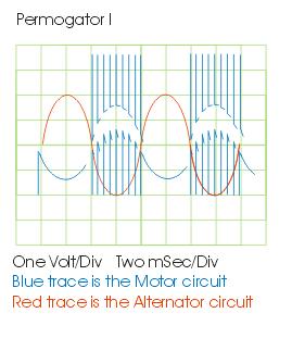

Using both channels of the Kikusui 5630, I tapped in at B and C. Here is the drawing of the image that appeared on the scope.
The blue trace is at B and the red trace at A. Freshly charged batteries had the RPMs up to 1015 at start.
I don't know what to make of it. The sinusoidal wave on the alternator looks nice. The motor circuit looks all confused and not what I expected. First the 555 pulse is way faster than the specs for the chip say it should be, using the R1 and R2 values I have. Those calcs return about .002 mHz, or 2 Hz.
Can someone help me here. What's happening?

Where did you connect the ground lead?  I.e. What voltages specifically are you measuring.  Since you have a circuit with energy storage devices (inductors; capacitors) its not easy to determine power in and power out.  For instance, the energy stored in a capacitor is a function of the voltage:  E = 1/2CV^2.  Again, check my posting on Bedini Motors for a discussion how to use this.  You can determine the energy in, however, by putting a small resistor in series with the battery to measure the current.  Plot the product of battery voltage times that current versus time (seconds).  The area under that curve is the energy in.  Do a similar thing for the load.  The pulsing nature of the waveforms is going to make this difficult, but that's life.  You need to find the energy per pulse and then multiply by the number of pulses per second to get each data point.

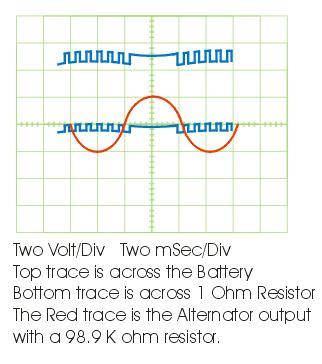

The ground lead on channel one (the motor) was connected at point 4 and the other lead connected at point 3. (3,4) in my new scheme is called B. (1,2) is A and (5,6) I now call C. It's simpler to type and keep my notes with.
Sorry I wasn't clear about the July 29 test.

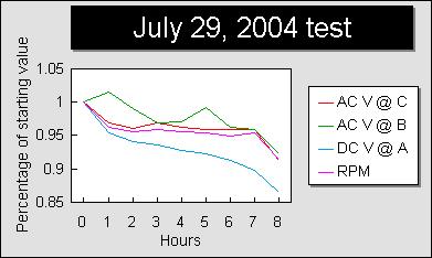

Here is a graph of the percentage declines from the start to the end.

Puzzles me why you didn't put the scope on the output since you are claiming a power gain.  I suggest you do so to see what kind of waveform you're getting.
Inductors also have resistance and do consume power.  You can measure the resistance of your coils by using an ohmmeter.
An ac voltmeter only measures accurately for sinusoidal waveforms with no dc component.  In general pulse trains will give erroneous readings.
Battery amphour ratings are given for certain rates of drain.  They are no substitute for measuring the actual current.
Power (joules/second) is given by volts times amps only when the voltage and current are in time phase.  With inductors in the circuit they are probably not in time phase.  Read up on this.
The difference in frequencies may be simply due to the fact that the 555 is triggering the "motor" faster than it can run.  Slow the 555 down and see what happens.
What you will accomplish by following the procedure I gave is greater accuracy and believability.  If you were going to submit your findings to a scientific journal this is what you would have to do.

Note that the ground leads for the three channels of the scope are probably connected together internally.  If so, you need to be careful how you connect the scope so you don't short out across the circuit.

Actually, the red trace is the output sine wave. Sorry that isn't clear. There are two circuits; the motor circuit is the blue trace and the red trace is the alternator output trace. It is a very clean sine wave and there is no DC intermixed with it. They are shown overlaying each other, just because I didn't want to upload two drawings.

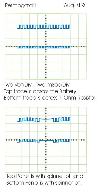

I may have mentioned, I am rather new at this, and I don't understand exactly what calculations you are asking. Here are the scope images with the connections you describe. The top trace is across the battery and I installed a one ohm resister in series on the ground. It looks like this:
The top panel is with the power on, but the rotor is not spinning. The bottom panel has the rotor spinning. If you are able to decipher an amp reading from this, I certainly would be interested in following your logic and calculations. By multimeter readings the battery channel returns 4.68 Volts with no rotor spin and 4.86 Volts with it spinning. The one ohm resistor returns 345 mV either way. It appears to be 1/2 Volt on the scope and negative as you can see.
I've known for some time that the alternator will stop when I short the leads, and putting a very small value resistor there stops it as well. It will continue to rotate, though at a reduced speed with a 10 ohm resistor. It slows to about 500 RPM and produces 500 mVolts. So, do you measure fuel consumption in a new car by attaching it to a 9 bottom plow?
I did some research on how AC voltmeters work and I think the one I have works this way. It has a bridge rectifier or Op Amp circuit that converts the AC current to DC, then measures the magnitude and multiplies that out by .707. Thereby coming to an average DC voltage due to the half ellipse of the wave. If that is true, then the AC voltage is in DC terms and the input and output I am measuring are apple to apple.
I'm calculating the output power under no load conditions for my efficiency test. That should have been obvious from the start. Certainly if you add different loads you will get different results.
If I put a 10K ohm resistor load in place of the LED, there is no obvious reduction in the RPMs of the rotor. If I put a 10 ohm resistor in place of the LED, there is a dramatic fall off in RPMs. If I put a LED in series with the 10 ohm resistor there is no fall off. Weird, huh?

First I'd like to point out that if you have no load you have no output power.  Why?  No load means no output current.  Zero times any voltage is zero.  That's why you need to hang a resistor on the output.  The effects due to different resistors are to be expected.  The led effect is not necessarily weird as an led may have an internal resistance in series with its light emitting diode.
You would run tests on a car with a dynamometer, which corresponds to a load resistance in your circuit.  Unless your device can provide energy to an external load it's totally useless.  A car provides mechanical energy to the road for example.
Expand the current trace by going to 1 or .5 volts per division (calibrated).
Now the power calculation.  Your trace shows a lower frequency waveform imposed on the input which is probably feedback from the output (stray 60 cycle can also cause such a trace).  Since that's a lower frequency than the pulse train that becomes the cycle to use.  Even so, you're lucky, because when the battery voltage is high the current is zero.  No power out.  You only need to calculate the power for a non zero current.  So multiply the voltage for each current providing pulse by the current for that pulse and by the time duration of the pulse (in seconds).  I see seven such pulses.  Add them up and you have the energy provided by the battery per cycle.  Now the cycle I'm using is from the beginning of the trace to the end of the flat zone (hopefully the output frequency).  It's 8.4 msec long.  Do the same for the output resistor.
For the first pulse I read a voltage of 4.4 volts, a current of .6 amps (.6 volts divided by one ohm), and a time of .6 msec. total energy = .00158 joules.  Do the same for the other six pulses and add the results.
It would have helped if you had shown a trace of the output at the same sweep setting.  I'm concerned about 60 cycle leakage.  Since you are claiming a power (energy) gain you should show the input and output traces for some reasonable values of resistance.  Yeah, the ten ohm would be fine.

Points on power taken and understood. Here is the scope image with the alternator trace superimposed over the two DC traces from the motor.
I reran the test, since I now see what you are looking for more clearly. This drawing is now diagramatic since I don't get exactly the same readings every time I run the device. I hope you understand this is because the device is fairly crude in precision.
This time I see 8 pulses in train instead of 7. This I assume to be because the load of the alternator resistor slowing the unit slightly. This resistor measures 98.9K ohms.
The pulse train must be caused by the 555 chip, since the timing of the beats are identical. The wave cycle seems to be feedback from the induction coils as the magnets pass over them generating an alternating current in the motor. It should have very minor leakage to the alternator, however, as you can see the two currents are 90 degrees out of phase from each other and stand pretty much on their own.
GeoM wrote: >>For the first pulse I read a voltage of 4.4 volts,<<
I'm with you so far. I see that too!
>>a current of .6 amps (.6 volts divided by one ohm),<<
I don't see where you came up with the .6 volts. Are you looking at the 1 ohm trace for this figure? If so, it measures .5 volts by zooming in on the scope.
I do see how you derive the amps: Ohms Law.
>>and a time of .6 msec.<<
I was able to zoom in very close to the trace. The length is .5 msec and the time between the pulses is .1 msec. This appears to be a function of the 555 chip.
Help me out here. What is the formula you used, for the record?
Why not just multiply by the number of pulses?
RPMs on this test were 988. One cycle therefore is 7.59 msec. I hope you can excuse the inaccuracy of the drawing.
Sorry I sound so ignorant about this. I really do need all the help I can get.

Energy (joules) = voltsxampsxtime = 4.4x.6x.0006 = .001584.  The numbers I used were the best I could read off of the trace.  I still count 7 pulses (the negative values of the  current waveform).  I didn't suggest multiplying by 7 as the battery voltage changes slightly during the time of the output waveform.  Multiplying by 7 gives you .o11 joules, an estimate.  If you divide by the time of the output cycle .0084 sec you get the average power, 1.3 watts.  I'll let you work out the power or energy going into the 98.9 kohm resistor.  I predict it will be less than the power provided by the battery.  Have fun!
