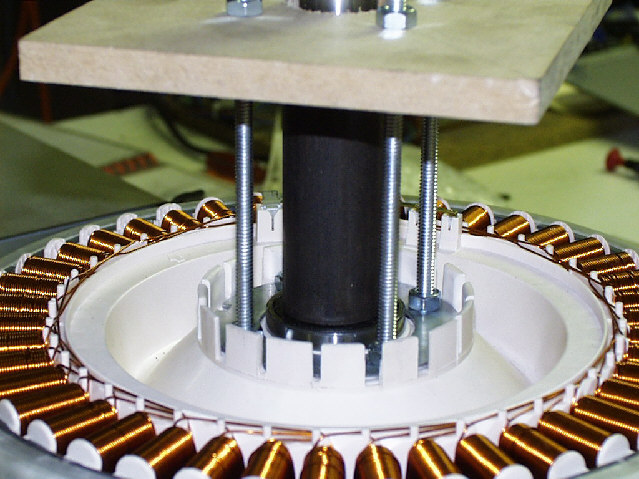

I threw together a bearing carrier today, rough & ready it was. Too rough & ready it turns out. The balance is terrible. But I got some data none-the-less.
The first photo shows a close up of the clamp assembly. The problem lies in the piece of tube I used as a spacer between the two bearings. It's internal diameter is 27 mm, not 25 mm (which would fit snugly against the shaft). Also, the ends are hand finished, whereas they should be squared off in the lathe.

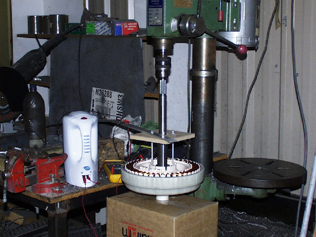

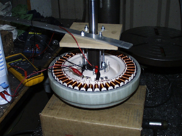

The next two photos show it sitting in the drill press, with a long aluminium bar used as a torque rod to stop the stationary bit turning. You can also see the two multimeters, and the jug I used as a dummy load.
The drill press is a somewhat dilapidated 1/2 hp unit. It's slowest speed is 280 rpm, which I used. One winding on the alternator, that is, from the neutral point to one free end, gave 79 volts open circuit. I measured the frequency at 137 Hz, which leads me to believe the true rotational speed of the drill press is 293 rpm.
I then connected the jug, full of water, as a load. The dc resistance of the jug element was 27 ohms. I then measured the voltage from the alternator at 49.5 volts, and the current at 1.8 amps. This equates to a power output of 89 watts.
It also gives me an internal impedance of (79 - 49.5) / 1.8 = 16 ohms. Now, since the DC resistance of that winding is 6.5 ohms, this warrants further investigation.

I actually did some more testing today by inverting the assembly in the drill press. I think my imbalance problem is actually the bent shaft in the drill press.
I managed to get readings at 280, 350, and 450 rpm. I've found that the drill speed slows considerably when loading up the alternator, making the calculated internal impedance appear much worse than it really is.
I then went back & repeated the tests, this time measuring the ac frequency loaded & unloaded in an attempt to calculate the relative unloaded rpm & open circuit voltage which would correspond to the loaded frequency & rpm. I messed up somewhere, because my calculated open circuit voltage turns out to be less than the measured loaded voltage, which is clearly impossible. That's why I haven't written up todays results. I'll redo it all again tomorrow, this time using 3 meters so I can simultaneously record voltage, current, and frequency.
