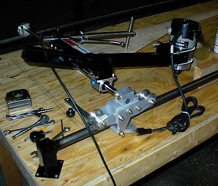

  I use guitar string for foam cutting, an "E" string I believe it is.   Works quite nice, it seems to have just about the right resistance to maintain heat yet only draw a couple amps from the battery.  You have to go at a steady even pace, and make sure your follower is smooth otherwise you'll get vibration from the string.
  I use a ball end mill on my machine and a ball end follower matching the size.  It would be nice to have a CNC machine but I don't know enough about them to convert...
  My modest but functional blade duplicator...
Its done me well for quite a few years although you still have to hand carve the first blade.  Some of them I've kept the pattern for future use.
Can't wait to see a couple blades from your "sit back and watch the blades be made" machine...

do you have a picture of your foam cutting head ?
Is that handbrake to switch the router on and off ?
I'll post some pictures later today.

   My foam cutter is about as primitive as it gets...  I don't have any pictures of it but if you can imagine a 1" x 1" square piece of wood with 2 3/8" holes on a slight angle in the ends.  Now add 2 lengths of 3/8" wood dowels in the holes and drill the ends just larger than the wire going through it.  String the wire through and tension it by slightly bending the two 3/8" dowels.   By adding enough tension or bow to the dowels they will flex back and forth as current is applied maintaining a reasonable amount of tension on the wire.  If you set it up with out a tensioner ( either spring or bowing the wood ) then the wire will go slack when its heated.
   I use it for making small parts, its only about 2 ft or so.   I've seen some extreemly nice ( and expensive ) CNC foam cutters and there are alot of plans on the web for them.
   I used it to cut foam "D cells" for the wings I was making at one time...
Have Fun
