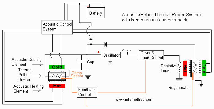

Many times I think of things in a strange but particular and interesting way, I find it opens up other pathways of thinking outside the box.  When I meet a challenge from a mechanical viewpoint I sometimes will convert this viewpoint to an electrical or electronic viewpoint which I can then understand the problem better. It's nothing new to make electronic circuits that will imitate mechanical devices. However I have stumbled into something which I am having trouble with and am in a sort of do loop and need some assistance.
The challenge was to produce an electronic equivalent circuit to imitate a Stirling motor.
At first I approached the problem from a refrigeration or heat pump device. Whereby a compressor; would by way of pressure changes a fluidic or gaseous movement produce both a hot coil and a cold coils thereby moving heat from one point to another most efficiently.
I immediately thought of several electrical equivalent electronic circuits of a mechanical device which would imitate such a simple process. But to my surprise, I could not come up with an equivalent component of the common "expansion valve", and it became difficult to figure out what could be used to create a cold side of such a circuit. The secret component was a "thermal Peltier device or junction" for the cold side, but an expansion valve is something else.

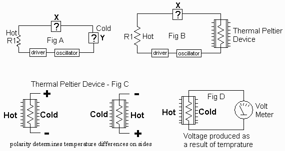

In Fig A, I began working out the problem rapidly for the hot side, easy, a resistor solved this. X-device is the expansion valve still in question. Y-device was the question which turned out to be a thermal Peltier device. But then I ran into a new problem. The Peltier device produces both hot and cold in the same device, in essence it is a self contained refrigeration/heat pump all it's own from an electronic standpoint. Opp's back to the drawing board on that one.

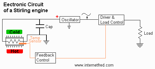

Anyway; as I was mentioning. The idea is to create an electronic equivalent circuit to imitate a Sterling motor.
I figure it's a basic oscillator with regeneration. Any idea's????
Why do it, because if a mechanical device such as Stirling Motor has such a high efficiency ratio can you imagine what an equivalent electronic circuit could be??
I'm open to thoughts....

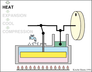

   If you think about how the stirling works, its simplicity alone allows it to reach higher shaft output power by utilizing the power more efficiently.  A standard non pressurized stirling will create about 13psi in the displacer chamber.  If you have a 1.125" piston this means there will be 13lbs of force on the crankshaft.  The same engine with a 5" piston would have 255 lbs of force on the crank and a 10" piston would yield 1021 lbs of force.  The difference between the steam engine and the stirling engine is the volumn of heated air used.  The steam engine uses alot of volumn and wastes the balance, the stirling uses it's own swept volumn over and over.   The gas, diesel, and steam amoung others waste a great portion of the initial heat input through the exhaust which could be recaptured and used again... and again at a lower level until.
  The presurized stirling engine creates a much higher output but only because there is more volume of gas to be expanded.  Unfortunately that pressure must be on both sides of the power piston in order for it to work properly.  So you really haven't gained it's actual potential.  Some stirling engines running upward to the 2000psi range... some have gone higher.  Sounds like a bomb ready to blow to me...!  Of course the 700 hp torpedo engines were going to blow up anyway... they didn't have to worry about any longevity or safty as long as it made it to their destination.  GM's stirling auto engine worked out very well but was scrapped because you couldn't get into it, start it and drive away within 7 seconds... it took 2 or 3 minutes to get enough heat in it to move the car sluggishly then came up to full power within 5-10 minutes.  It achieved 45 mpg with a V8 style engine... pretty good for a prototype... I thought (back in the 70's).

iFred
  • Posts: 470
Re: Electronic Stirling
« Reply #3 on: October 17, 2004, 05:22:21 AM »
When a problem bug's me enough I know I'm onto something major.
Today I hunted down the principle of the expansion valve.
Evaporator; A device in which refrigerant changes from a liquid to a gas and absorbs heat from its surroundings.
The expansion valve is the replacement for the old manual or automatic governor. The expansion valve of today measures flow of gas or liquid entering the evaporator at a rate that matches the amount of liquid or gas that is being boiled off in the evaporator, it also provides a pressure drop in the system by separating the high pressure from the low pressure; Thus allowing the low pressure liquid or gas to absorb heat onto itself.

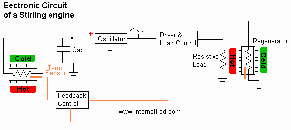

An electronic equivalent to this would be a couple transistors, a load and a couple sensors to control current flow and temperature to adjust output/input and load accordingly. So, no big deal here. Once I understood this I could now build a block diagram of the circuit. That I beleive was the hangup or do loop I was missing.
So here it is ... what I believe it basically looks like...An electronic equivalent of the mechanical version of a Stirling Engine. The Peltier device creates voltage from being hot and cold, the cap acts as a flywheel, the Oscillator output would behave in the same manner as the output of the flywheel in a sine wave output fashion, the temperature sensor provides feedback control and adjusts the driver/load control which adjusts the load according to the amount of temperature that there is and thus determines the amount of power to deliver to the load without being overpower or underpowered. Load/power compensated.
« Last Edit: October 17, 2004, 05:22:21 AM by iFred »
inode buddha
  • Posts: 73
« Reply #4 on: October 17, 2004, 05:49:21 AM »
Fred, that's fascinating! For the electronic equivalent of your expansion valve, have you considered "Avalanch" diodes? IIRC from my old TV repair training, they exhibit a so-called "negative" resistance when they break over, with large current flows. (This being what they are intended for). I have seen similat techniques used with neon bulbs to make simple "oscillators": a cap charges at a given rate through a resistor, until the neon flashes over (about 90 volts IIRC).
Hehehe, you really got my creative juices going, thanks for a great post!

iFred,
Ah-ha, I see what your doing. The problem of the "regenerator" in stirling engines is a serious issue. Quite interesting approache to hybredizing an electronic circuit, with pelter juctions, and a working fluid. In reference to "expansion valves" take a look in "Mark's" its a reference book for mechanical enineering. In Marks check,-the definition of what is called "wire-drawing"... Also have you ever heard of what is called "thermo-acustic cooling"? Seems to me it was on the cover of physics today(magazine) in the early 90's. Would be iteresting to incorperate some moving parts in reference to the regenerator, and your electronic hybridization ideas. Keep at it, Nice work...
JW

iFred
  • Posts: 470
« Reply #6 on: October 17, 2004, 05:06:07 PM »
« Last Edit: October 17, 2004, 05:06:07 PM by iFred »
iFred
  • Posts: 470
« Reply #7 on: October 17, 2004, 05:10:29 PM »
Yes, I remember reading about the acoustic heating and cooling experiments that where going on, something that started in a test tube and went to Nasa and some other Labs, they are doing some heavy reseach on it.
Yes, you got it! keep going.... Your almost there...
« Last Edit: October 17, 2004, 05:10:29 PM by iFred »

iFred
  • Posts: 470
« Reply #13 on: October 17, 2004, 10:40:27 PM »
As stated the problem was regeneration. Therefore I believe this is the fix.
Since the Stirling process is a variable thermal system, why not have the entire circuit variable based upon changes in load and production thus regenerate by collection of the resistive load heat? I think that even a sensor on the resistive load would help.
A regenerator connected to the resistive load means a variable efficiency regeneration system. Oppinions?
