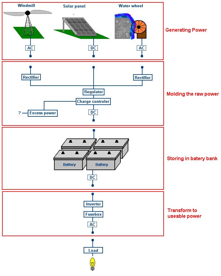

Planning the power system
I've decided I want a wind turbine, a hydro plant and some solar panels.  I also need a complete power storage and distribution system.
I made a "nice" little diagram about it (well I like it anyway).
This is the process as I see it at this time, I'll change this view step by step in other sections.
These are the steps I'm going to take to make the power system.  This is the initial planning, and it will without any doubt change later.

I'm sure you've either accounted for this, or will at some point.  But I don't see any reference to battery and inverter efficiency.  For a well managed wet lead acid system, most authorities quote overall efficiencies of 70-80%.  Under ideal circumstances, the inverter might do a bit better than that, but in the real world, I also figure around 80% on the inverter. So overall system efficiencies hover around 0.8 x 0.7 = 56%
And if history has anything to recommend, it is that power requirement virtually never go down and almost always go up, so expandability should also be considered.

Sven, unless you have a very effecient refrigerator, I think 25 watts is quite a bit low. Sunfrost has a model that uses about .9kwh per day, however most effecient ones in the U.S. use 75 to 100 watts per hour.
  I noticed that no waterpump is included, so hopefully the spring is uphill from the cabin for gravity feed? Great start in planning! Will be interesting to see the mix of power choices you eventually decide on.
  Hugh Piggott has plans (in a book format) that is worth every penny to build a 6' and a 12' windjenny. Most if not all is on his website for free, however it is nice to have a hard copy.
 Wishing you all the best, and have fun! Gary D.

Re: Planning the system
« Reply #4 on: November 12, 2004, 09:20:21 PM »
Hello Sven,
You made a very nice diagram.
Make the most of the water available.  Water power is easy and not expensive to maintain.
Solar power and wind power are often oposite in a season.
Making more power than needed is a good design.
Excess power is good for hot water.
Also consider some devices run with battery power, and no inverter.  Items like 12vdc or 24vdc CFLs (compact fluorescent lights).  Bad 12vdc items in the US can be coffee pots, blenders, mixers.

I did know there was some efficiency loss, but I had no idea it was so steep.  I will better try to run everything in 12V, and only have an inverter for occasional stuff.
In any case I am planning on trying to produce more than needed.
Thanks for the input.

You are probably right for the refrigerator, I seem to have bought some salespitch too easily, it's indeed more 60W for the more expensive low-energy refrigerators.  After some consulting on the IRC channel, I decided it would probably be better to run the fridge with gas.  More certainty of a continuous running fridge, and more power available for the rest.
The spring is indeed uphill.
For the book of Hugh Pigott, I bought it, it arrived 2 days ago.  I was planning on designing my own windmill eventually, but I feel it better to first try and build a time-proven design, which was well thought out.  I plan on starting to build Hugh's windmill in the coming weeks.
Thanks, and I am certain I will have loads of fun.

I was planning to first make a windmill, then get solar panels, but you are right, I might be better of trying to harvest the waterpower before spending big $$ on solarpanels (it is more fun to build a waterwheel anyway :-) ).
After talking to people on the IRC channel, I am also more convinced I should be planning to run more on 12Vdc, you're absolutely right.  I'm still planning on having an inverter, but only for occasional stuff.

Im not sure if i understand. The diagram says "waste" not water.
      If waste is the case, you would be wise to run a pump off batteries/PV or direct wind-drive.  (IMO)
      So dedicate one system to support your 'main' and use the other for a laid-out set of tasks. Not all of life is electronic and realistically a PC is almost all you need to get radio/phone/tv/vcr/etc. Then you have to deal with the appliances. From what i understand, fridges work (most) by compressing gas to make it cold. Why cant the water wheel do that directly?
   The more you convert, the more you lose. If this wasnt the case, we could all have miniature mills linked by hydraulic/air trannys.
 Think of it like this. You have an apple orchard and want to get wine. You might go sell your apples and then buy wine, or you could just settle with cider; which in my opinon is much more rewarding.
  If this sounds out to lunch, i must apologise. The others are much more experianced! :p

I thought it said waste... i went back and looked at it again and realised it doesnt. sorry.

I absolutely agree that as little as possible conversion should take place.  However I do not see myself making my own refrigerator.  More so, a refrigerator one makes himself will far lack in efficiency compared to one from the store, so I fear efficiency loss will be greater.
I think it is best to find a balance between all things, and for the moment I would set up a system that can be changed in the future, but is functional anyway.

Have you considered a propane or kerosene powered refrigerator?
They don't use much fuel.
