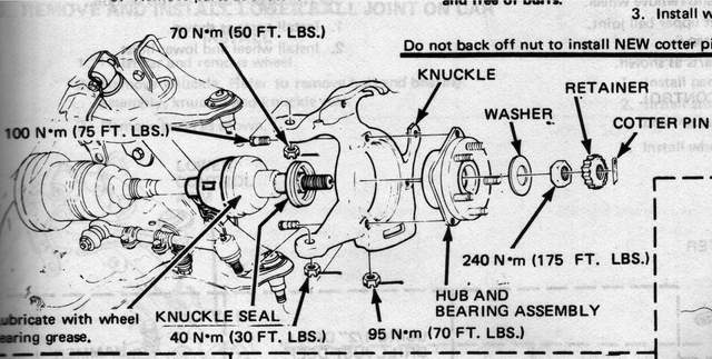

The 50mm shaft probably will handle the loading from the prop etc. - not to belabour the point, but an elegant solution for divorcing the prop loads from the motor would be to use a hub and bearing assembly from a full size front wheel drive car. They're flanged with bolt holes for mounting, hollow with a splined shaft inside, and plenty strong enough to handle lots of torque, axial, and radial loads. Also cheap from the wreckers.
You could use half of the driveshaft with a flex coupler to the motor.
Or if this was used in a jackshaft arrangement, you could arrange a hollow splined shaft for the low speed shaft, and pass a rod up through the middle to do the active pitch control. The activator could then be on the non rotating side of the prop.
This is an example from a GM FWD car:
