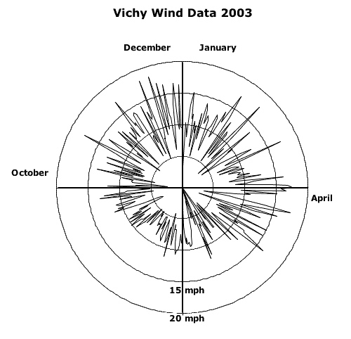

I cobbled together a method to chart wind data from NOAA (National Oceanographic and Atmospheric Administration).
Below is a map of the wind speed throughout the year for 2003 at the airport in Vichy Missouri.  It reads like a calendar wheel with January - March in the upper right quadrant, April - June in the lower left, etc.  The radius at any given point is the wind speed in mph.  This tells me what to expect in terms of available energy throughout the year.

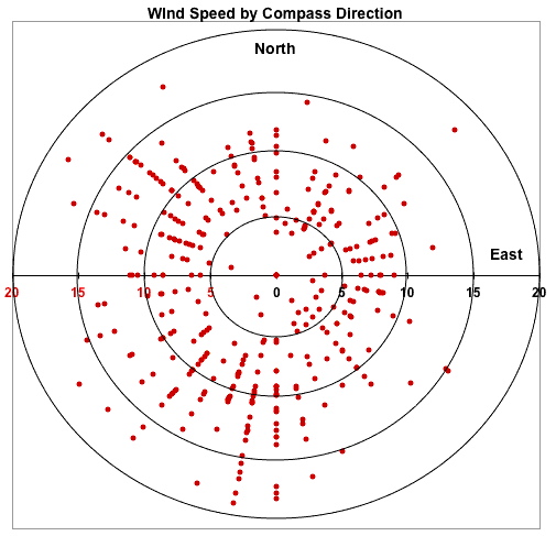

The next one shows wind speeds by compass direction.  Each data point is plotted by compass direction and speed telling me where most of the energy comes from.  This would be usefull in selection a tower site to get a clear shot at the wind.
I haven't done it yet but it would be a simple matter to convert to data to energy units taking the cube law into account.

By now you should have a spreadsheet with columns containing wind-speed and direction data for the whole year.  This data should be numerical (using the =VALUE function).  The data below is for the first 6 days.
NOTE: NOAA monitors average and Max wind-speed so you can choose which one you want to use.  I use the average.
Dir    Avg. Speed
70    9.4
-40    0
-80    3.4
-50    10.3
-60    9.2
20    8.1
If you are using Microsoft Excel then you've already done most of the hard work to get the circular calendar chart.  Simply select the wind-speed data column (the direction data is not needed for this one) and create a "Radar" type chart.  Since the data is already in chronological order, the result should look like my example above.  Any charting program that can do a Radar chart should work.
Set the scale for the gridlines however you'd like.  I chose 20 mph max with 5mph divisions because it provides an easy visual representation.

Okay, on to the second chart.  Excel doesn't have a chart type to create the wind dorection type chart so we have to to use trigonometry function to make one.  Here's how to do it:
At this point you should already have set up two columns that have NUMERICAL values for wind direction and speed using the information above.  They may look like this:
What we have to do is use the Sin and Cosine functions to convert the direction angle into coordinates around a circle.  I won't go into a trig primer here but I'll be happy answer questions if it's not clear.  What we're going to do is treat our direction and speed data into X,Y coordinates giving us angle and magnitude for each data point.
The direction is the angle on the chart and the speed is the magnitude which is the radius from the center of our chart.  The basic formula is this:
X=COS(ANGLE)*speed
Y=SIN(ANGLE)*speed
In other words take the SIN or Cosine of the angle and multiply by the magnitude to convert angle, magnitude to X, Y coordinates.
Now, in reality there are a couple other things we need to do to make this work in a spreadsheet.  First, almost all spreadsheet functions expect angles to be in radians instead of degrees (kind of like centimeters instead of inches).  To get the NOAA data (in degrees) into radians we simply multiply by pi (3.14159) and divide by 180.  So now we have this:
X=COS(ANGLE*3.14159/180)*speed
Y=SIN(ANGLE*3.14159/180)*speed
The other thing is that trig function assume that zero degrees is a line pointing to the right and since we're dealing with compass directions we'd like zero degrees (north) to be pointing straight up so for our chart we need to rotate the data by 90 degrees CCW:
X=COS((ANGLE-90)*3.14159/180)*speed
Y=SIN((ANGLE-90)*3.14159/180)*speed
Note the extra parentheses.  These are important as they tell the spreadsheet to do the calculations in the paren's. first, then use the result to finish the rest of the math.
In all we take the NOAA wind direction, substract 90 from it to rotate the data by 90 degrees counter clockwise, covert it from degrees to radians and take either the Sin or Cosine of the resulting angle and multiply that by the windspeed.  This gives us a set of X, Y coordinates for each day of the year.  By plotting these we get a visual representation of where the wind comes usually comes from and how fast it's blowing.
To do this using functions we go to an empty cell to the right of our NOAA data and put in
COS((ANGLE-90)*3.14159/180)*speed    (actually this needs an equals sign in front of it but its messing up the html when I put in the text here)
but substitute the address of the direction cell for ANGLE and the address of the speed cell for speed.  These might be F10 and G10 for example.  In that case it would be:  COS((F10-90)*3.14159/180)*G10
Use the fill down technique again to copy the formulas down to match the length of the NOAA data.  Mine looks like this:
Now make an X/Y scatter chart from the two columns of data.  Your spreadsheet or charting program may call it something else but it puts a point at each pair of x,y coordinates.  If you want to be fancy you can add some circles using a drawing tool like I did.
