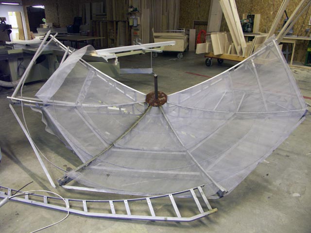

Then, we put the base and pole in my truck ready to go. We figured we could put the "8ft" dish in our box truck we have. Unfortunantly, my guestimation was WAY off. The dish was actually 12ft wide. We had to take out dozens of bolts on the spot to get it out. The whole process took about 4 hours.
When I did get it back to my shop though, I started to go at it. Here's what it looked like after un-instalation.

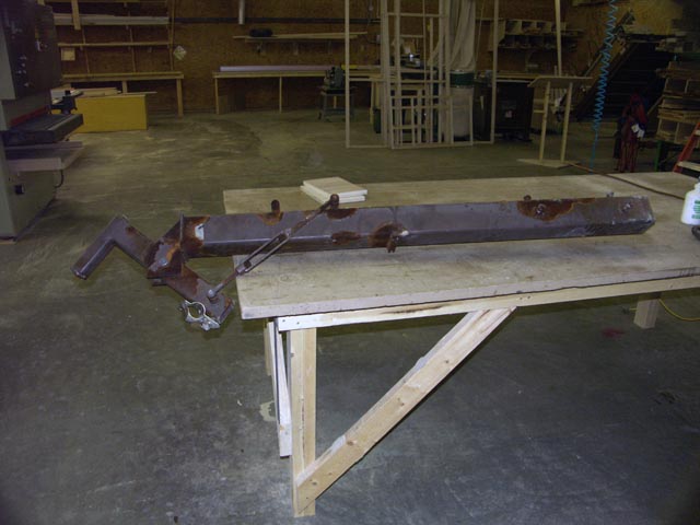

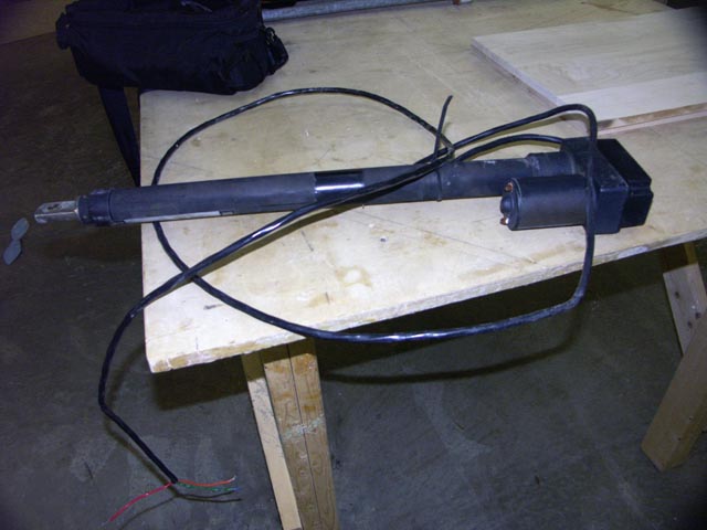

Ok, so I started taking apart and sanding down the base, because that's the parts I was wanting anyway. Here's what I started the whole thing for... The actuator...

While that's drying I head over to the dish itself and start the disassembly. Half of the bolts broke off, half came out. Tear off the screen, salvage the middle bracket and I'm done for the night!
Now I have a nice little pile of parts I plane on dropping off at a metal yard to Monday, to see if I can get a few bucks out of the couple hundred punds of aluminum.

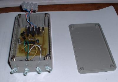

I did the same thing. I've got a couple of 80W panels on an old satellite mount. Had to steal the actuator for my dish that I watch TV with so the solar tracker is currently stationary. Are you planning on using one of these LED devices for tracking?
http://www.redrok.com/electron.htm#led3
Keep us informed as to how this project turns out. The one thing I haven't researched very much is how to get the thing to turn back east in the morning. In my part of the country, a guy could get a dozen of these satellite dishes for free, just for the asking. I've picked up three of them now and usually try to finagle my way out of taking the pole. Either that or see if they'll let me torch it off at ground level.

Yes actally I should have mentioned that. The Led3 is the one I'm getting from RedRok.com. I'll probably order it today.
As for the turning back in the morning, that does sound like it would be a problem, and I thought I would put a little blocker(wood, tape, something...) on the right side of the tracker device. That way, it will turn back the right direction in the morning, but the blocking plate will off the device enough to follow the sun. I just dont know how long it will take in the morning to get enough juice on the panels to power the thing back. I dont want to hook it to the battery, because that's more wire I have to run, less voltage, and if this Led3 device is very sensitive than I dont want someone's barn light or headlights draging my panel around at night.

I finished my tracker last year using the Redrock circuit and it performs very well. I didn't buy a kit but built the circuit on a homebrew pcb and used higher power discrete mosfets rather than the smt ones. The circuit has the facility of auto return at the end of the day (just involves adding two resistors) and this also works perfectly. Great fun to see it working!
