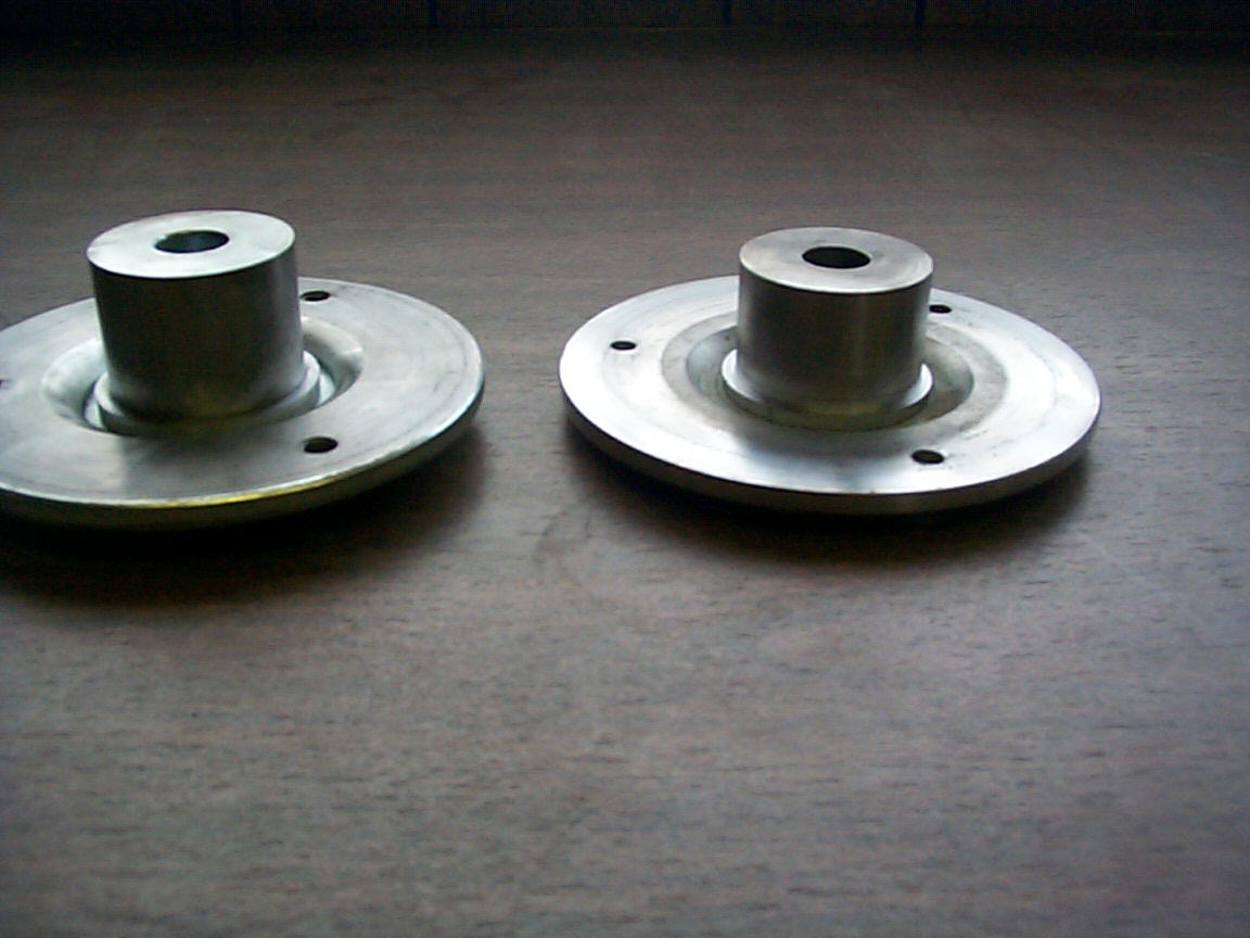

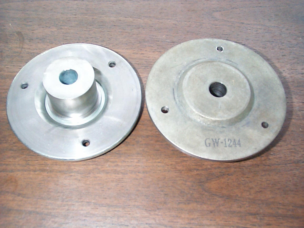

These saw blades are thick enough that 3 stacked up make one rotor a liitel over 1/4" thick.
I needed a hub to mount the rotor to. I used the magnet end cap from a 12" speaker. I machined this to fit the 1.5" hole in the saw blades. I also used the 3 holes in the saw blades as a guide and drilled 3 holes in the end caps. I drill a hole in the side of the hub and tapped it for a set screw to keep the hub taught to shaft. Pix shows shaft, hub, saw blades shaft coller and end bearing.

These are the speaker end caps after machining.

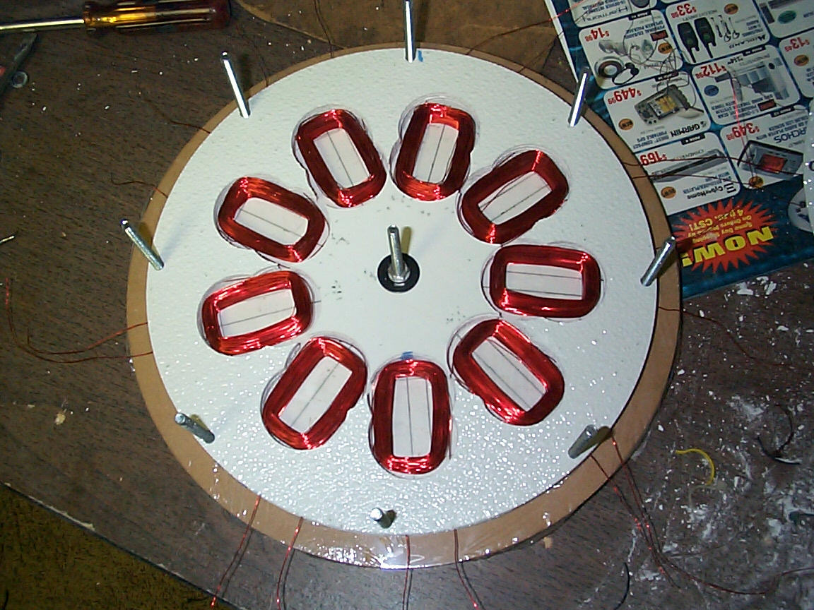

« Reply #7 on: January 29, 2005, 10:23:41 PM »

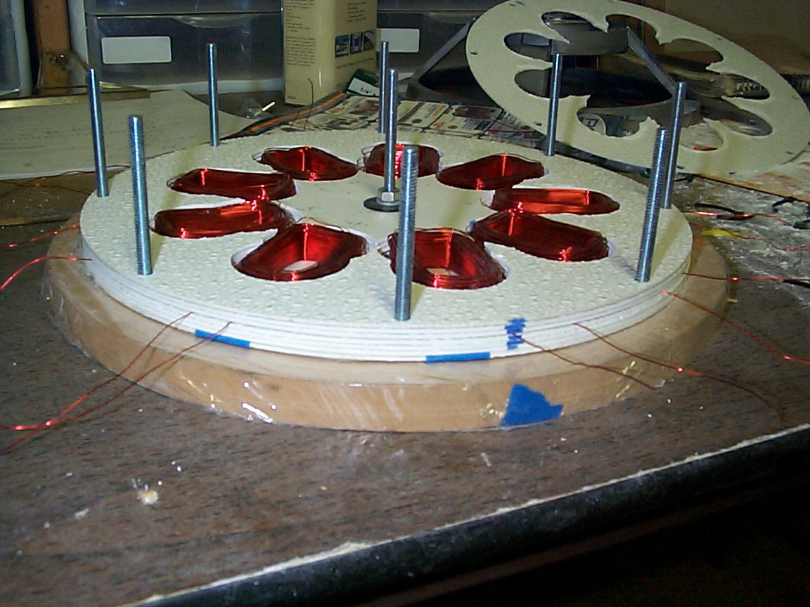

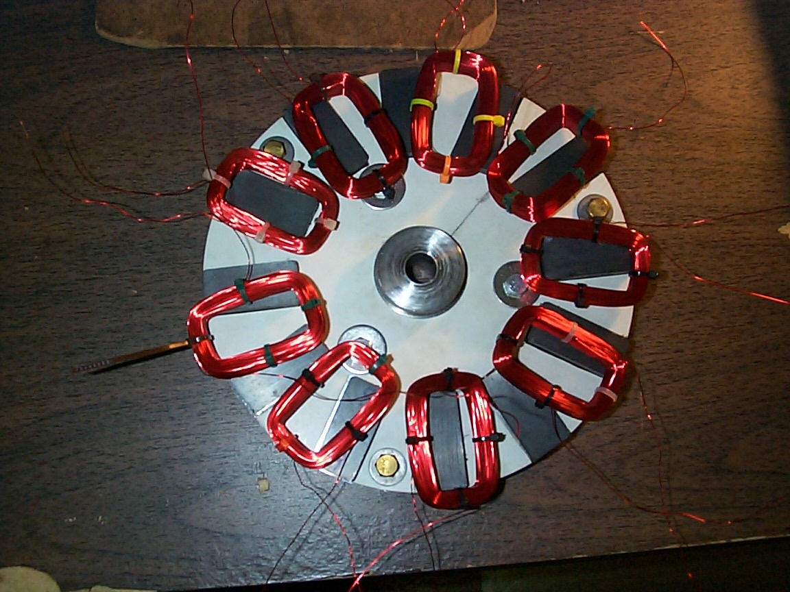

Time to wind some coils. My coil winder is a qwicky. After winding 9 coils at 300 turns each I'm going to buld a much better winder befor the next alt and it will have a counter. I lost track of turns too manny times ( interuptions?). So I just wied the coils to see how close they were? The 300 turns was do to, I had the wire and to get as much voltage per coil posable with the wire I had.
Now checking coil fit on template.
« Last Edit: January 29, 2005, 10:23:41 PM by Jerry »

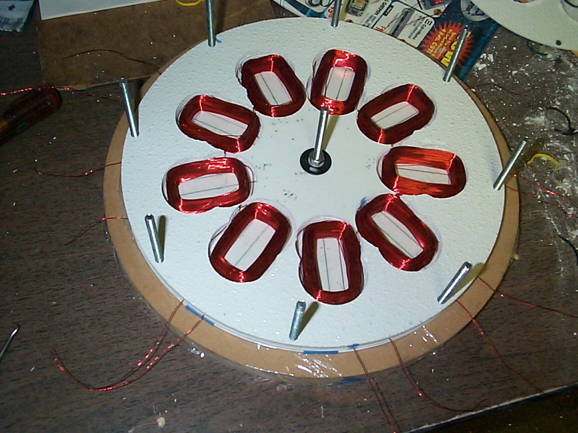

Re: Jerrys first dual rotor.
« Reply #8 on: January 29, 2005, 10:33:27 PM »
Next I checked to see how coils and magnets set next to each other.
« Last Edit: January 29, 2005, 10:33:27 PM by Jerry »

A couple notes. The blue carpeted boards on the winder put tension on the wire to keep it taught for a tight coil. It just opens up then closes to pinch the wire.
I used a scrole saw to cut the fiberglass sheet. Cut real easy. Now a sires of pix on the stator. The thin wire just goes between the layers of sheet. If it were thicker I'd just drill a hole for it to come through.I placed the coils then poured in the resin. This method only took 16 OZ of resin. With out the fiberglass shett it would take a bunch more. After the resin was poured in a top and bottom board was clamped over the stator. I wraped the boards in sandich wrape to eliminate sticking of the resin to the boards. The boards are MDF. These rounds were left over from our speaker box making.
« Reply #10 on: January 29, 2005, 11:00:40 PM »
A few more pix of stator construction.
« Last Edit: January 29, 2005, 11:00:40 PM by Jerry »
« Reply #11 on: January 29, 2005, 11:11:01 PM »

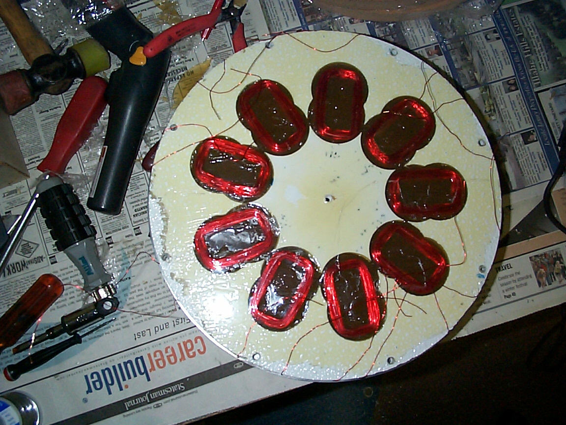

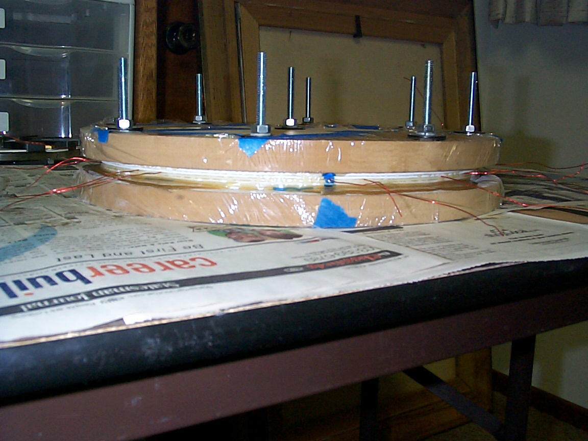

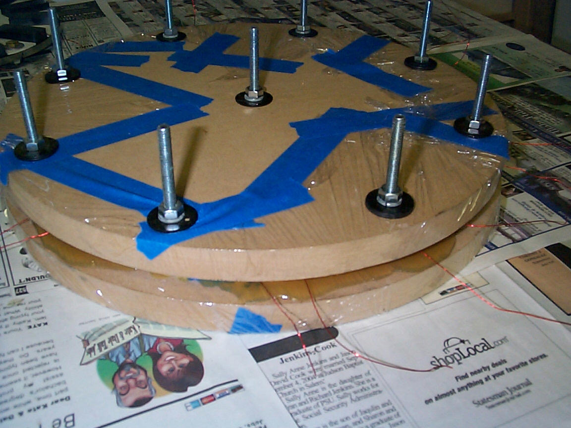

Stator now in press. The big squizes. This made the resin squish out between the shetts. This made it a littel hard to cleal up after casting. Next time I'll glue the sheets together befor the resin goes in.
Stator out of press.
« Last Edit: January 29, 2005, 11:11:01 PM by Jerry »

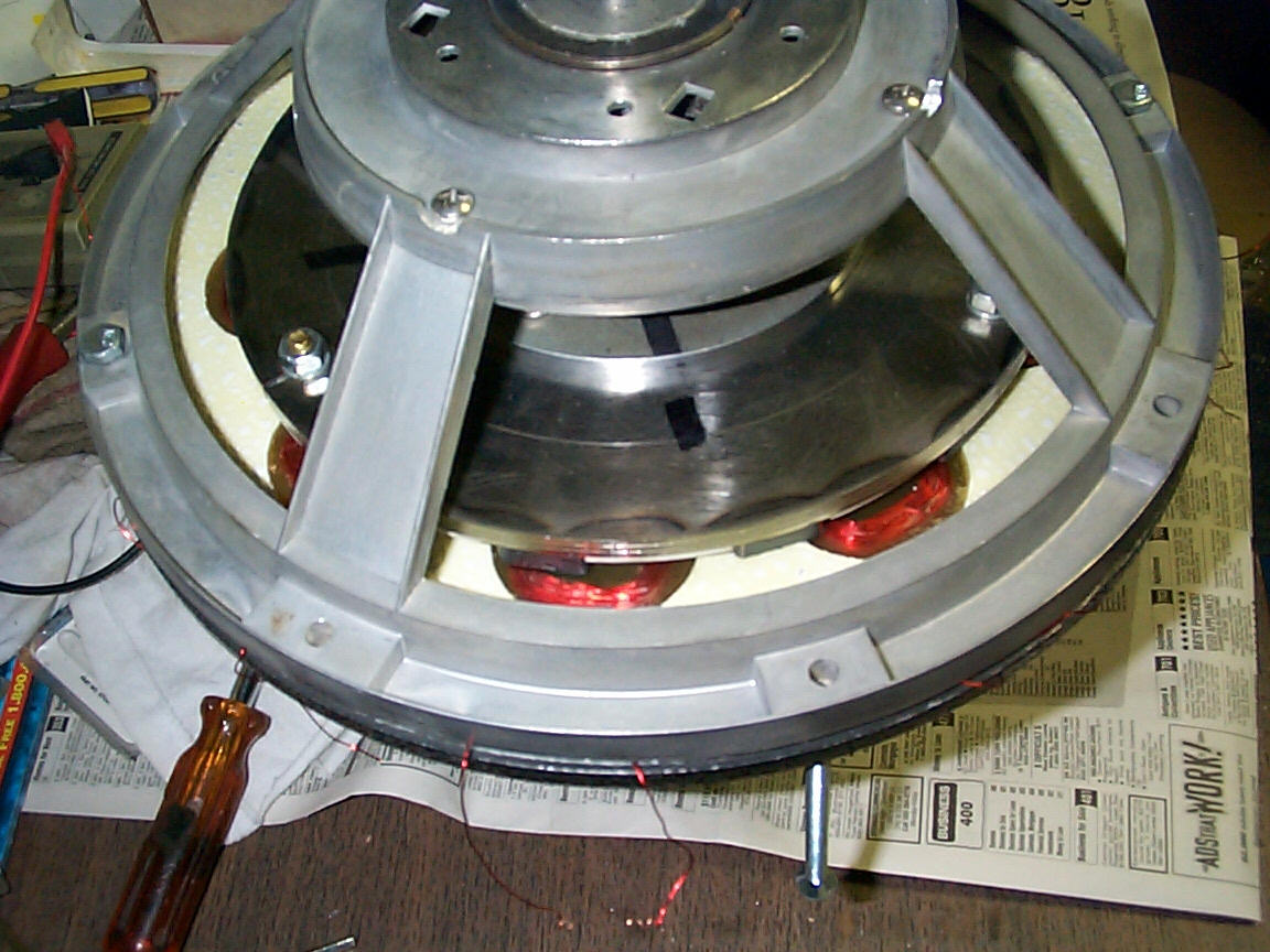

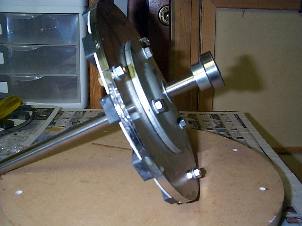

OK stator is done, magnet rotors are done. I now need a way to hold it all together.

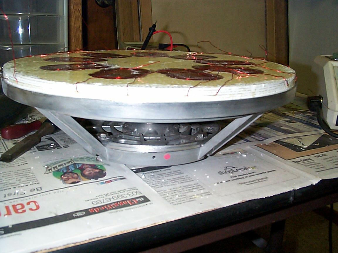

I'm using a shzft so I need a bearing on each end of the shaft. You may have noticed the old emty speaker baskit in an above picture?
Being in the audio biz for 40 years I've acumulated 100 or maybe much more than that speakers.
The speakers that gave up there magnet backing plate will now become the holder for this disc alt. I've also collected 100s of ac motors for motor conversion. It worked out to just mount motor bearing end plates were the magnet asemblys were.
The magnet discs are 8.75" diameter so I used cast aluminum 12" speaker baskets. It saw easy to router out the fiberglass discs. They turned out extreamly strong.
Cleaning up speaker basket in lathe.
More basket pix.
« Last Edit: January 29, 2005, 11:31:02 PM by Jerry »

« Reply #13 on: January 29, 2005, 11:59:26 PM »

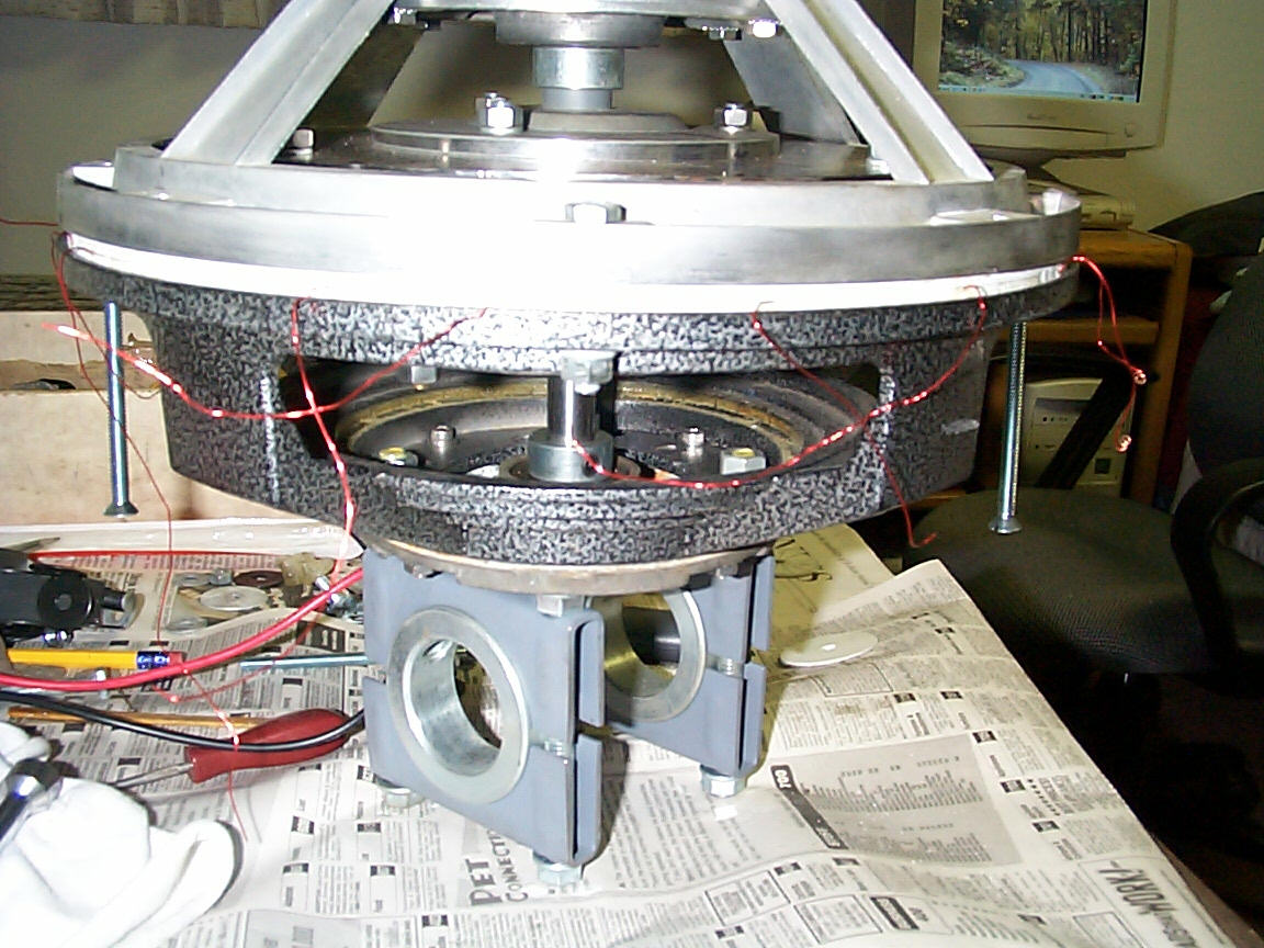

Pix of complete unit ready for wind testing.
« Last Edit: January 29, 2005, 11:59:26 PM by Jerry »

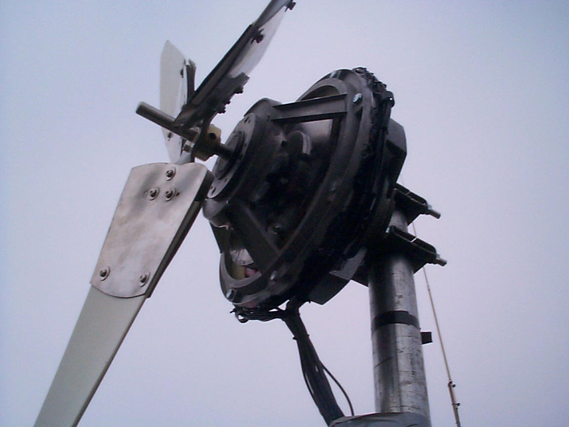

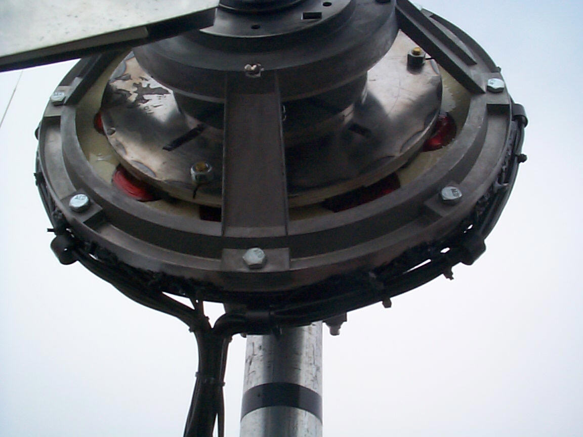

OK heres the ready for test pix.

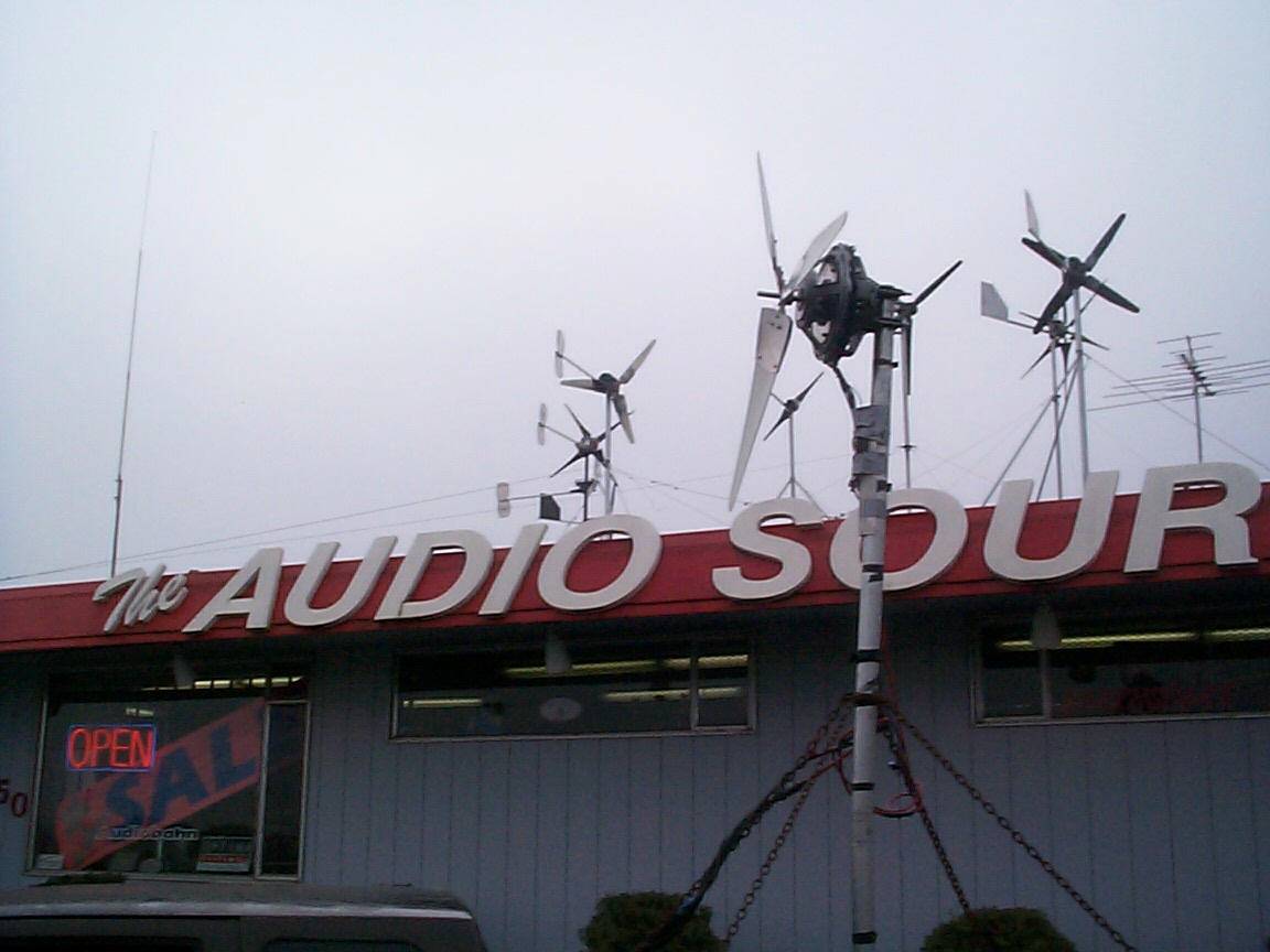

« Reply #15 on: January 30, 2005, 12:34:59 AM »
I've learned a bunch from this project. I will now build another with these changes, NEOs not ceramics, larger gage wire fewer turns, 2 fullwave bridge diodes not 9, 3/4" shaft instead of 5/8", solid mild steel rotor discs. However it was fun. It takes much longer to build disc alts compaired to motor conversions.
I have some 15" speaker baskets and some NEOs and bigger wire so all I need is time. Next rotor will be 12".
I only expected 100 watts max. Here are the wind test numbers it did. All 9 of the diode bridge were wired perelell.
5 mph 1 amp 12 watts, 10 mph 2.5 amps 30 watts, 15 mph 5 amps 60 watts, 20 mph 10 amps 120 watts, 25 mph 12 amps 145 watts, 30 mph 246 watts and 35 mph 22.5 amps 281 watts.
These numbers trac almost the same as the 50v Ametek with the same blades. Blades were 49" tip to tip 3 blade Jerry blade plastic.
Want to try the Ed Windstuff type wave coil arangment next.
« Last Edit: January 30, 2005, 12:34:59 AM by Jerry »

I'm going to leave this one as is. It will be easyer to just build a new one with the upgrades.
I will weatherize this one and fly it as is. It is a 12 volt. There are some voltage readings for it in my First poured stator post from a few days back.

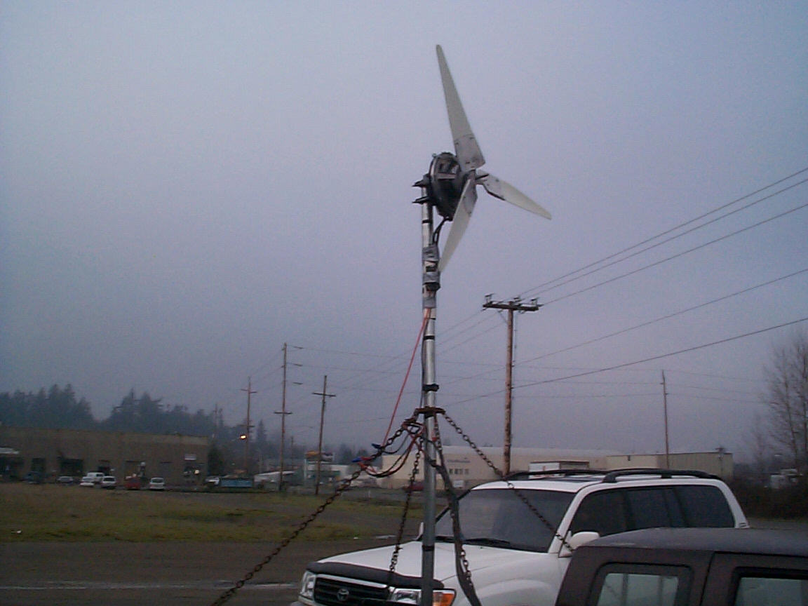

Thanks for the kind words. Yes this unit turn out very strong and the 360% support on the stator helps that stringth.
The 2 very large 1.5" shaft colers at the back side will make the yaw bearing. I'll mount the genny on EMT conduit. I use a shaft coler on the mast and let the genny just pivot on the mast. This is the same as pipe over pipe. I also use a shaft coler on top to keep the genny from lifting off the mast. I grease the pivot part up with bronze never size. Works great.
I'll post a (small if I can) picture when I get this one flying.
« Last Edit: January 31, 2005, 12:32:54 PM by Jerry »
