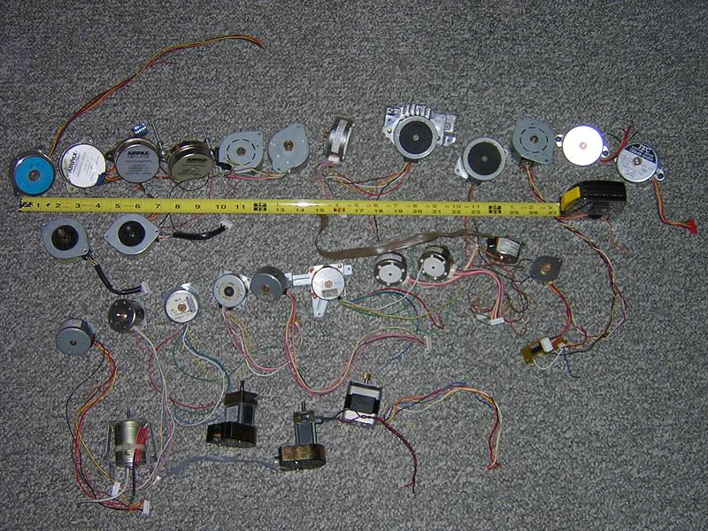

I got these for cheap a couple of weeks ago.
Didn't really have any project in mind when I picked them up, but couldn't pass on them.
What would you do with these little guys?
A bank of pinwheel gennies?
Combine with a dremel to make a homebrew cnc?
Robotic flamethrowing spider sentry?

I would build one of each, since it looks like you have enough.
Really though, I would probably do a pinwheel wind farm. Although they wont produce much, I dont have a genny and it would be fun to play with. :)

-Hmmmm ,  Thats very interesting
I have those very same motors here at my place
My imagination was telling me to make a small wind farm from those little motors using the ZubWoofer PVC props from small free easy to find small pvc pipe

What did your little steppers come out of?
I'm guessing mine came out of old dot matrix printers.
« Last Edit: February 13, 2005, 07:23:38 PM by Big All »
Re: Now I've stepped in it!
« Reply #5 on: February 13, 2005, 10:21:15 PM »
I got mine out of printers, Cassette Decks and toys. Plus some stepper motors from some robotic lighting instruments.
« Last Edit: February 13, 2005, 10:21:15 PM by wooferhound »

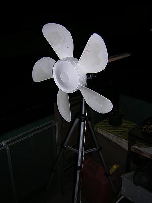

Last night the wind was really gusting by my balcony.
Soooo I ductaped one of the 24V steppers to my tripod and stuck a box fan blade on the front of it.
I was seeing 8 to high 9V AC on a single phase.
Picture was last night, as it was spinning.
I guess next time I'll use no flash so it looks faster.
Tonight I'll be looking for diodes to canabalize from the gadget boneyard.
On a sad note no breeze tonight.
