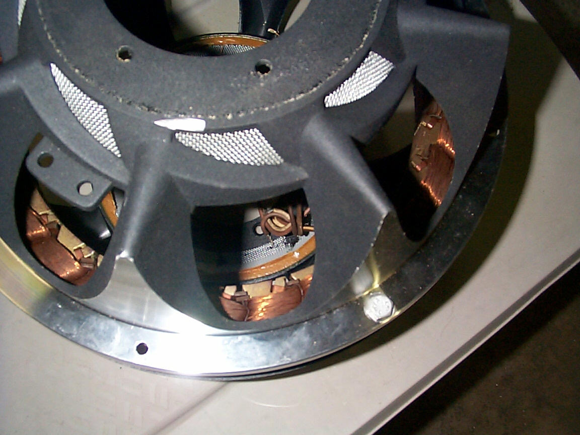

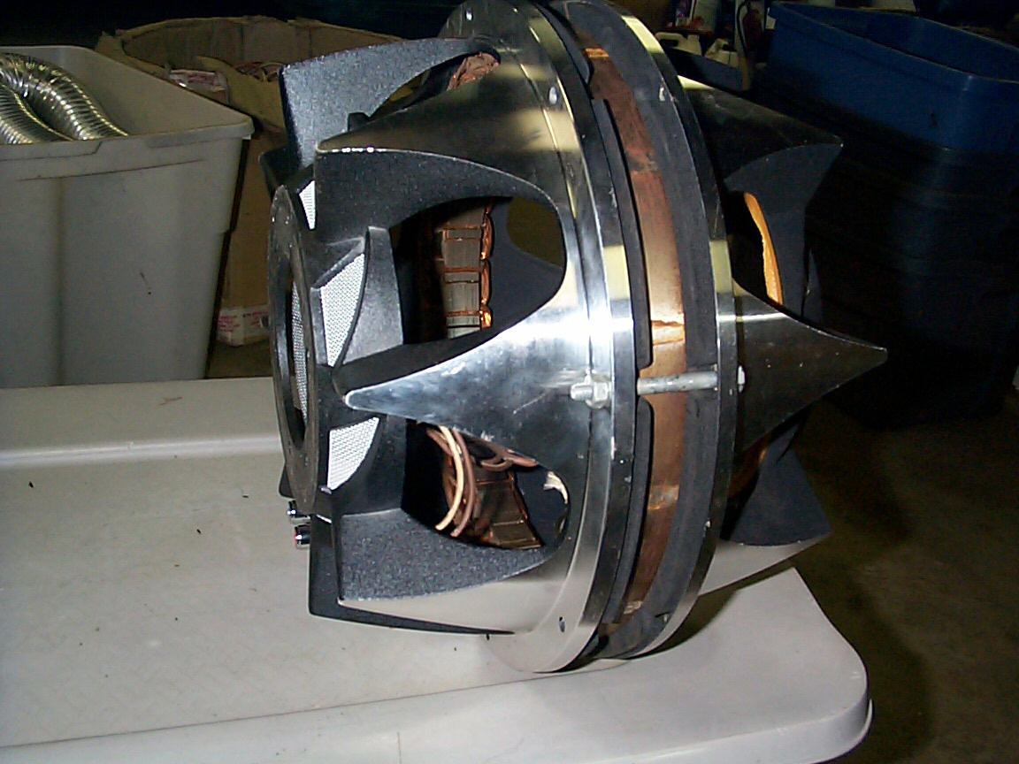

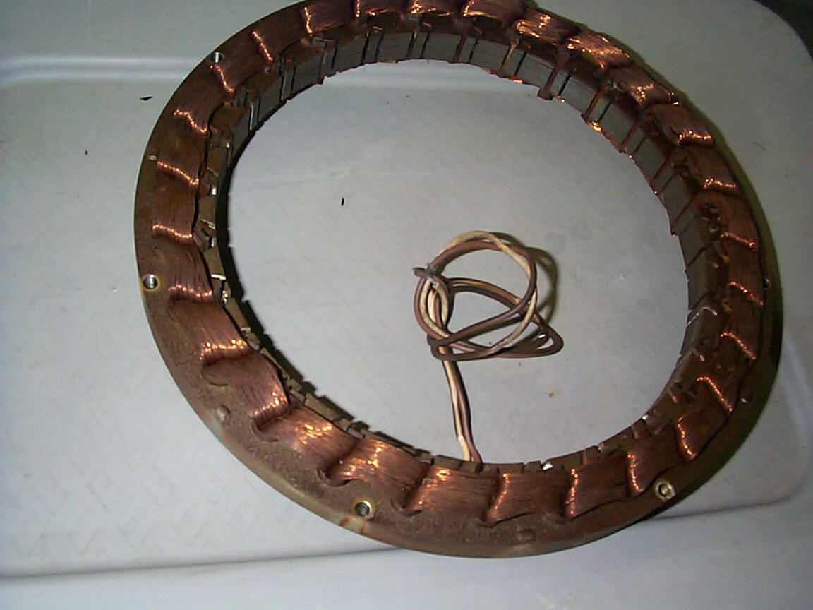

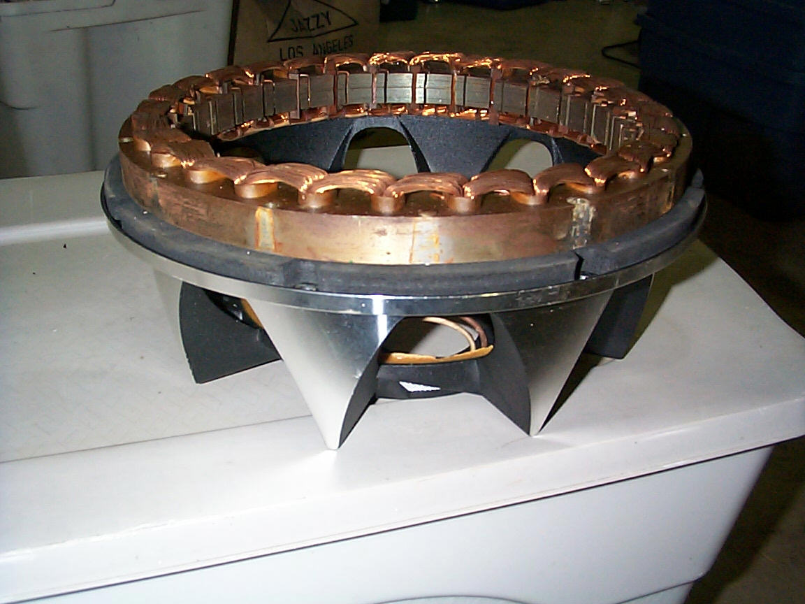

I took the big ceiling fan motor apart. I removed the stator ring.
I'm going to use 2 speaker baskets as I did in my first dual rotor. This will make using a shaft easyer. Since I'm buiulding a new solid steel rotor and my blades mount to a shaft.
Heres a few pix.
This is the stator ring.
Stator ring sitting in speaker basket.
Both baskets sandwiched around stator. The stator fits perfectly just inside the 1/4" bolts that hold the 2 baskets together. This should center the stator.
You can see the stator between the 2 baskets.
I'll be picking up the steel discs tomorow. I'll be adding the bearing end plates and magnet rotor.

Those speaker baskets look really cool.  Like art.  The good kind of art, like without Elvis or velvet.
The coils look big / heavy to me.  What Ga is the wire?
Do you expect the AL baskets to have eddy currents?

The wire is fairly small. 24ga. ? or smaller? Shouldn't be any eddy curents. The original housing was aluminum. All the flux should stay in the laminations?
No its just me and my HF lathe,mill drill press combo. I'll make a 3/4" hole in the ruff cut steel discs. I'm using a 3/4" shaft. I'll make a hub from a speaker magnet backing plate. The discs will be bolted to this. I'll true the outer edges of the discs with the lathe. Then glue the squewed cut magnets to the discs.
I think the voltage may be high? I may use it high voltage or reconfigure the coils perelell for higher amps instead of higher voltage?

I would call 24ga big, in a ceiling fan.  The biggest I found in one is 30ga.  The one here now is even smaller, 32 or 34ga?  You find all the good stuff!

Hi Jerry! Pulled open my Hunter's to see. Same diamentions as yours, 9" rotor, but the laminates are only 1/2" thick, so I think since I have two of these I will try to stack the laminates, and perhaps try and see if I can find a break drum of the correct diamention to use as a rotor.  I also think that the magnets from an outboard motor fly wheel will have about the right curvature and so for free may give these a try.

Looking at that stator if you were to rewire it
but stack 2 or three stators together you could build a monster.
