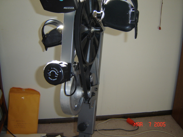

You can see that the crank drives an aluminum flywheel.  You can just see the row of ceramic magnets which can be moved closer to the flywheel to adjust the 'magnetic resistance'.  I stopped using this bike originally because there wasn't enough resistance and the high RPMs was hard on my knees.  You can also see that the belt is one of those mini-v belts and the $9.99 motor has a similar pulley head so this made the project easy.

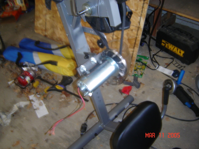

Here I've taken off the flywheel and mounted the PM motor in its place.

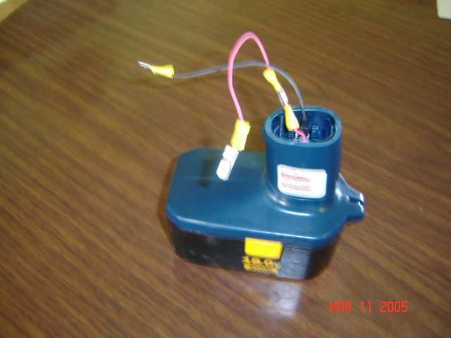

I have a set of Ryobi 18v cordless tools.  One of the pieces in the package was a flashlight which never worked very well.  I cut off the flashlight head so I had a handy battery holder.
Hooking up my multi-meter and turning the cranks by hand I see 20+VDC open voltage.  Shorting the leads makes it hard but not impossible to turn.  The large pulley is just under 11" in diameter and the motor pulley is just under 1.5" so the gearing ratio is just over 7:1.
The charger for these 18v batteries must have some circuitry which prevents them from working on weak batteries.  I had one battery pack which had dropped to under 11v and the charger wouldn't charge it.  I hooked it up to this unit and cranked it by hand for about 10 minutes.  The battery read 14.8 vdc so I put it in the charger and the charger recognized and started charging it.  The battery may well be dead but I have a small hope that it will recover.

There's a label on the belt that says : CONTITECH 430 J6
It is a 6 ridge/5 groove belt that seems to fit the pulley on the motor perfectly.

a lot of those old nicad batts can be brouht back to life by --just zapping them with
high volts for a few secounds--use a auto batt or batt, charger...it breaks up the crud that builds up inside of them--or the memory barrier...
« Last Edit: March 11, 2005, 03:51:58 PM by hiker »

I played with this setup a little today and have some rough numbers.  Cranking the pedals by hand and charging an 18 volt battery I see around 3 amps into the battery and the voltage of the battery right at 19 volts.  Estimated RPMs (by counting them for a minute) were around 100 which makes the generator turning at about 710-720 RPM.  A little higher gear ratio would be nice because the cranks turn too easily even when turning by hand.  Would be much too easy pedaling with legs and the turnover would be too high.
I might tear this down and set it up to drive off the rear wheel of my mountain bike.  Might also be interesting to make a set of 6' blades for it and put it into the wind to see how it does.

I have some 8 year old ryobi 18 volt batteries that are like that, when I put them in the charger they won't charge.
What I have found is this, plug the charger in, you will see both yellow and green lights come on which means the batteries are no good. Unplug the charger and very quickly replug just when the yellow light goes out...you may have to repeat this 5 10 or 20 times to get it right but pulsing it like that makes the charger start and the red light will turn on and start charging...works everytime.
Basically you are glitching the charger, just hold the plug up to the wall socket but don't plug it all the way in, this will allow you to be faster between glitches, takes some practice but it works on those ryobi chargers.

Thanks, cdg378, putting the bad battery on my bike driven charger straightened the battery out enough for the charger to get a bite on it.  I'll remember your trick for the future, though.

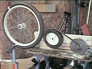

 The way I'm going to have it set up will be about 20:1 ratio...like this
I think it might work like this, the crank would be direct drive, like a tricycle wheel.
The tire is actually driving the belt, the lawnmower wheel just keeps the belt tight around
the generator pulley.

That should get you some reasonable power, Norm.  You might need an idler though since I'm seeing a fair amount of slippage in that mini-v belt once you get up to 80-100 watts.
