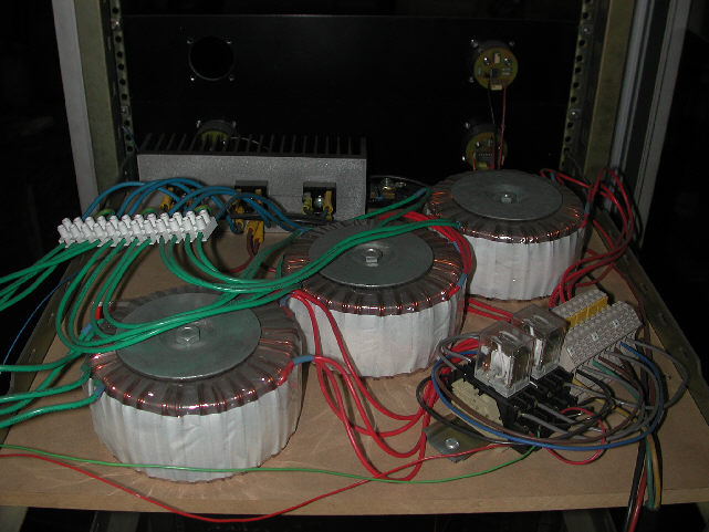

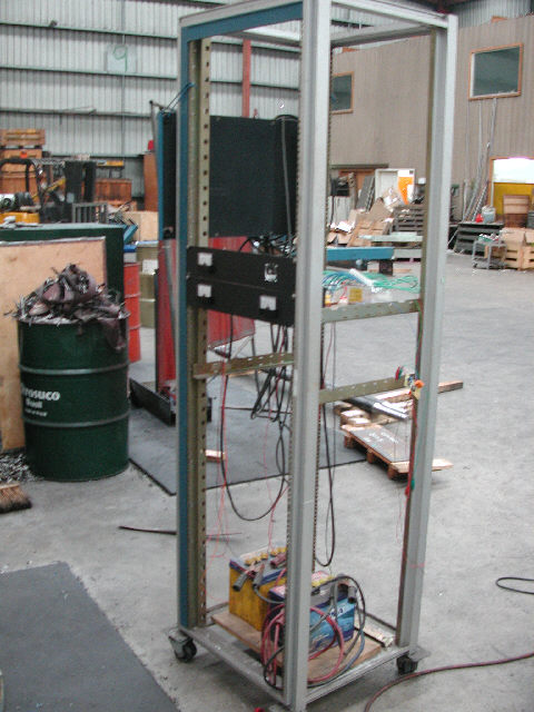

And here's some photo's of my test rack setup.
My batteries, a pair of retired automotive batteries, have deteriorated since I last played with this back before Xmas. And I've yet to cut some copper busbar and wire most of this up a bit more professionally. But you can see the 3 toroidal transformers, the terminals where the transformer primaries terminate, the 2 relays for the star-delta switching, the 3 bridge rectifiers, and the back of the meters (volts, amps, rpm).
