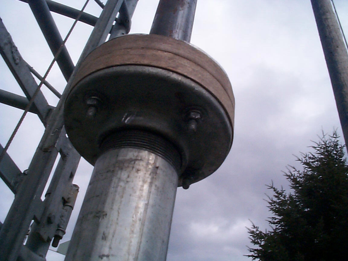

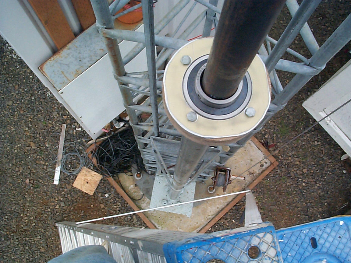

Here are some pix of my dual mast. This one has replaced to single 1.5" schedual 80 that bent at 4 ft above its support. I'm flying a set of 7ft Lakota blades on a 2025 watt motor conversion.
This is the under side of the top bearing.
This is the top side of the top bearing.

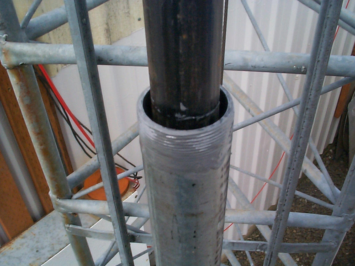

This is the black schl. 80 that will come through the top bearing. Top bearing is removed.

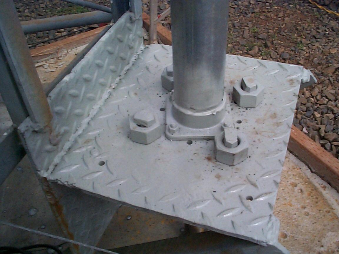

This is the platform at the bottom of the mast. The "A" hub keeps it secure to the platform.

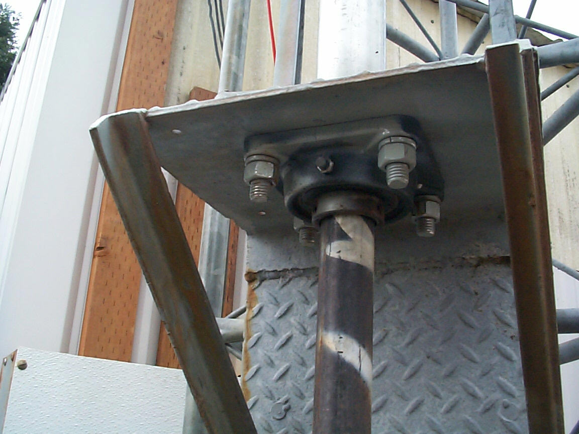

This is the big flange bearing under the platform. The 1.5" mast is supported by this bearing and the top bearing. The hole mast turns and yaws with the wind. The genny is mounted solid to the 1.5" at the top. Wire will come down the center of the 1.5" #80 pipe.
2" pipe is 8 ft long and stationary. The bearings alows the 1.5" #80 mast to turn inside the 2" pipe. The 1.5" #80 pipe is 10 ft long.
The 2" pipe is supported up to 44" from the top and the top bearing.
OK thats my update. Had very strong wind today and its working very well.

Whoooops that second picture is wrong. I hope this is the right one?
This should be the top veiw of the top bearing?

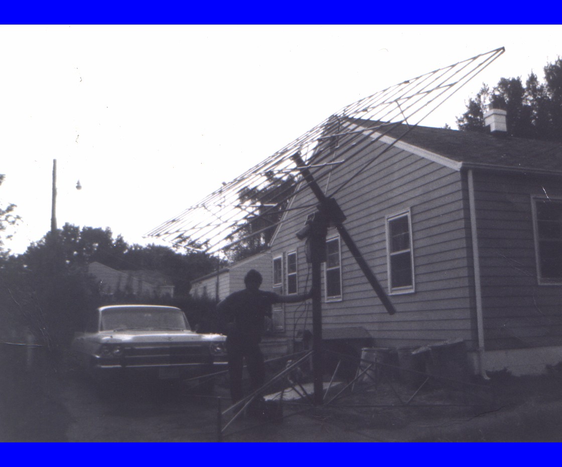

This picture was takin from a 10 ft step ladder. You can see the crank/wench at the right at the bottom. Behind the pipe mast on either side you can see the littel rail road tracks that take the platform to the top. the platform is resting on the ground at the bottom of the tower.
I just crank the wench up and the hole thing goes to the top. When it reches the top a click is heard and its locked in. To bring it down just turn the crank a littel tighter, another click is heard and then you just uncrank it and it comes back down.
An old radio ameture built this free standing tower in the 70s. It was originaly 70 ft. Now it 40 ft and I have about 6 ft mast above that.

This is a very neat setup! If I understand this correct, the two bearings  support the weight of the generator and the pipe, right? What size cable do you use in your winch? And this is still a freestanding tower right?

Yes the bearings hold the weight of the 1.5" pipe and the genny and 45 ft of 4 each 8 ga. wire.
I think this is a fairly light load for bearings of this size and the rpm is basicly 0 just back and forth slowly depending on wind direction.
