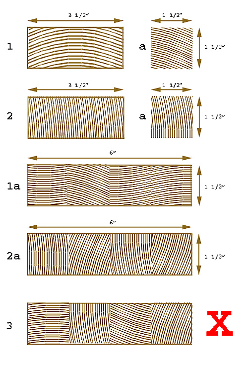

Below is an illustration I made up to try and describe grain orientation and what is considered common practices. The names are also common names although by no means an exaustive list of all the potential names used. The opinions expressed by me are in the context of what I would consider best practices for blade construction using commonly available wood at a moisture content of 12% or less. Other restrictions and conditions may apply.
 1 - Horizontal grain/Plain sawn
 2 - Vertical grain/Quarter sawn
 1a - Prefered layup method for horizontal grain. Alternate curvature but maintain horizontal grain orientation. This layup will be more elastic through its thickness than a vertical grain layup but is more prone to warpage and will experience its greatest deviation through its thickness as the moisture content changes.
 2a - Prefered layup method for vertical grain. Alternate curvature but maintain vertical grain orientation. This is commonly considered the most rigid through its thickness and least likely to warp layup. It will on the other hand experience the greatest deviation in its width as the moisture content changes.
 3 - Umm, just don't do this. As wood expands and contracts seasonaly the most through the growth rings this yields unpredictable and potentially undesirable results.
Conclusion:
Editors Note:
On request of the author the following was updated
as noted in this comment
Comment
 2a - is considered best for blades due to its rigidity and its resistance to warpage.
 1a - is next best
 3 - is the least desirable
Disclaimer: Wood used to be a living breathing organism before harvest and processing as a result every single piece is as unique and diverse as the human race. It is only possible to try and predict woods behavior based on collective observation, labratory tests and an understanding of woods structure at a cellular level. There will always be exceptions to what is considered "normal" behavior for different species of wood.

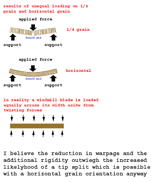

With 2a, won't the thin blade tips be subject to spliting?
« Last Edit: March 25, 2005, 09:32:46 AM by ghurd »
rotornuts
  • Posts: 537
Re: Wood grain orientation
« Reply #5 on: March 25, 2005, 02:11:15 PM »
Short answer gurd is yes. If you support the edges of a 1/4 sawn board and load the center it will split easier than a horizontal grain board but in a blade the wood is loaded equally across its width aside from aerodynamic forces which I highly doubt would split the board. Checking(splitting) of wood due to seasonal movement(moisture changes) typicaly occurs across the growth rings putting horizontal grain wood at risk of splitting anyway not to mention across the growth rings is a weak point anyway when the wood is thin.
1/4 sawn stays the winner in my point of view.
It's a good observation though and likely subject to debate.
Nuts
« Last Edit: March 25, 2005, 02:11:15 PM by rotornuts »

am i mistaken, or did your conclusion of the first post suggest that plain sawn was better, but now you say quartersawn? or can i just not read?
allan
« Last Edit: March 26, 2005, 02:13:49 PM by kitno455 »
rotornuts
  • Posts: 537
« Reply #7 on: March 26, 2005, 06:29:32 PM »
Your right I goofed it up. the conclusion list should read as 2a best then 1a and three as least desirable. Anyone know how to edit posts?

If you look up at the origonal post, in my conclusions I stated that layup 1a was considered best and 2a was second best. This should be reversed to read 2a as best and 1a as second best. This of course reflects my preference for vertical (1/4 sawn) grain orientation when looking for resistance to warpage and stength through the thickness of a lamination. My conclusion list is contrary to that statement and I'm sure could easily lead to confusion.
If you could swap the 1a and 2a headers I would appreciate it.
