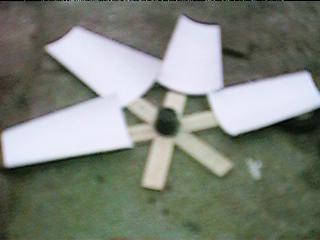

  Me thinks this might be an answer to the amtec-motor generator thing I tried last year.This is a 50vdc motor its geared about 3 to 1....Spining it by hand I get about 14vdc into a batt bank.Cant wait for the wind,so I can see what it will do...

I too have done the same arangement only into a 24V system, the six blades are the answer, insuficient torque with only 3 blades.
From what I can see yours should work a treat, lotz of angle on the blades, how did the static ballance go?.
There apears to be no furling on the tail as was mine, the blades seem to be adequatly self limiting on their own.

  Now this is a sad story,the faint of heart cover one eye while reading this....
     And it came to pass that the chain was not staying on.While trying to make some adjustments I droped the amtec...It hit the cement and now the rotor wont turn.I got upon it with all four feet, no turn....I took it apart and what do I see ? The ceramic magnets had broken in several pieces...I am trying to replace the old mags with some new ones...Moral of the story dont drop the amtec-motors.....

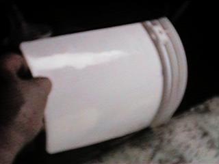

Something like this for that little treadmill motor I'm working on in my diary...going to use
that belt drive ...about 5:1 ratio automatic variable tension and clutch...won't have any cogging problems!(...If I ever get that far!)
    Made from 5 gal buckets cause I can get some
of these easier than plastic pipe...I may make my
next one with longer arms narrower blades and
maybe 8 blades.
