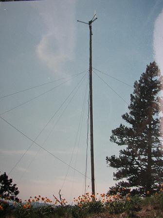

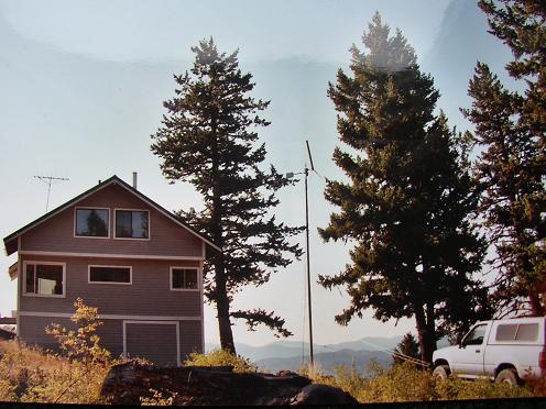

So tell us a little about the set up.
« Last Edit: April 07, 2005, 06:44:53 PM by drdongle »
97fishmt
  • Posts: 231
Re: some pictures of my site
« Reply #2 on: April 07, 2005, 07:23:52 PM »

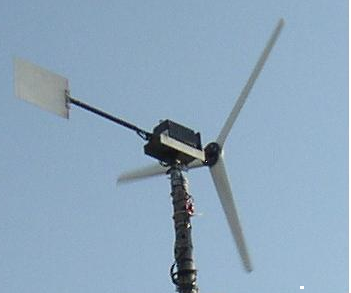

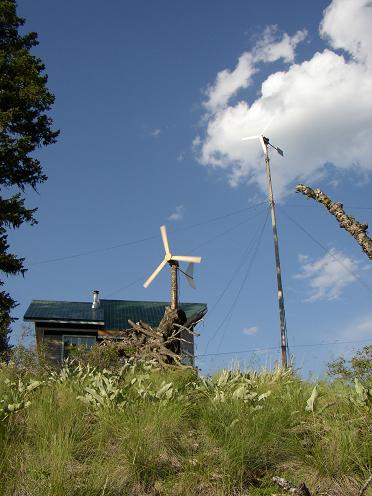

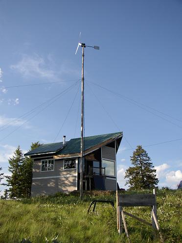

Hi Dr.D nice to hear from you.  I don't know what to say, but I've done all this my-self.  I sure wish I had a folks around like Dan.  I have changed that turbine around some since those pictures.  Larger tail boom and tail surface area and more of an offset for beter furling.  I am working on a new prop right now, I can't wait till I can try it out. I have a battery bank of 8t-105's that feed a prosign inverter with the help of about 450 watts of solar. I have 1 trace c-40 on regulation for the solar and another c-40 on dump for the wind.  This alternator is a little to much some times though for the c-40. I some times have to run around and turn things on. The best part about 3 phase is I can flip a switch and not have to worry about it, not like alot of pm motors I have put up.
