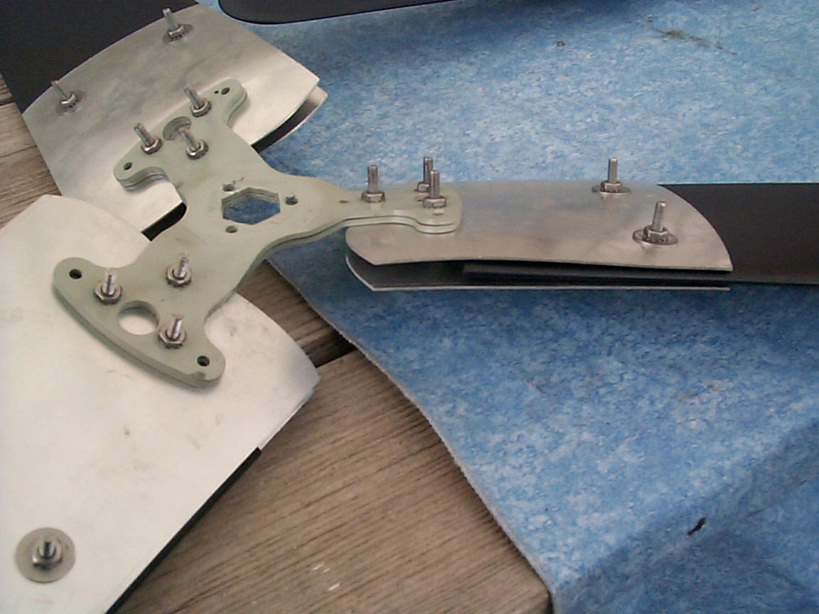

Here saome pix. Some of the parts prep have been covered in earlyer post.

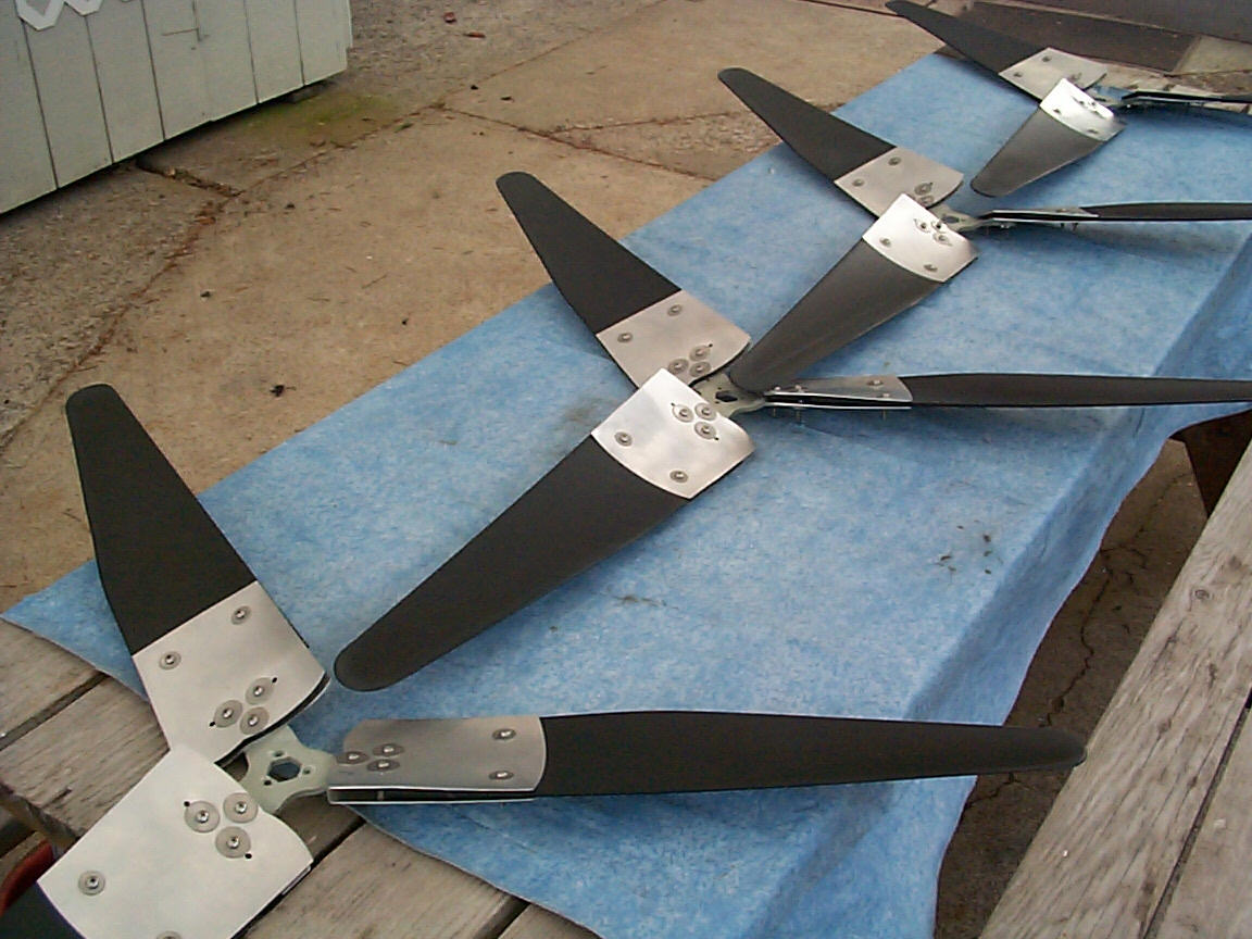

here is a group of 4 three blades at the asemble table.
Parts lined up for count.
Nuts, bolts, spray greese, drill, clamps and hand tolls used during asembly.

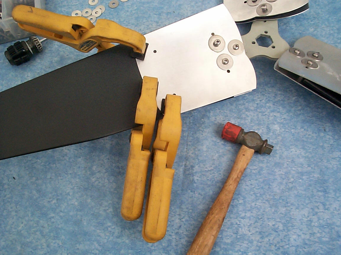

asemling the parts. The littel soft hammer helps in the part alignment prosses. It doesn't bend thing.
Under side. #10 stainless steel machine screws get trimed close with Dremmel tool using heavy duty Dremmel cutoff wheels.
Finnaly got 4 ready to ship. I diasemble for shipping in a 6"X8"X 24" box. Buyer reasembels upon reciept.

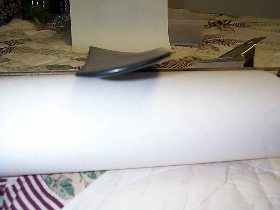

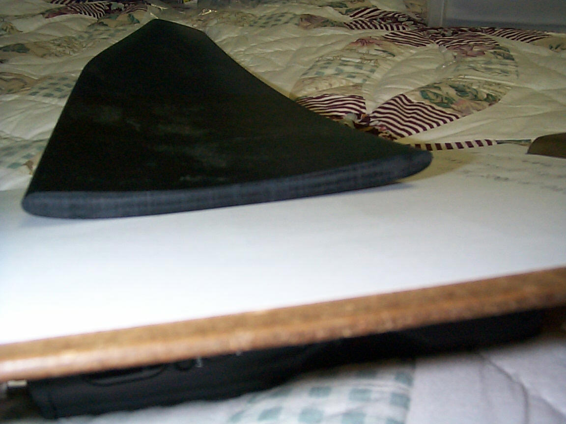

A couple pix of intrest? With the 2"X2" mounting tab cut off the 1/4" thick root end center is visable. Root is 5/16" thick at the edges. Tips is 1/8" thick and all edges are rounded off. Cup and twist gives good stringth along with user added aluminum sheet metal support.
Blade is 5 and 5/16" wide at root and a rounded 2" at the tip.
Twist or pitch is 23 degrees at the root to just a couple degrees at the tip.
