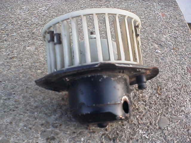

« Reply #14 on: May 31, 2005, 04:49:40 AM »
   Just to get you thinking how easy and efficiently
you can mow a lawn......
this is a blower motor if you make a special blade
where just the 2 inches of the tips are dropped
down and sharpened ...it will cut a 10-12inch
diameter swath with ease!
                  ( :> ) Norm.
