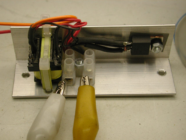

This is basically the fly-back circuit I've used numerous times to power lcd backlights. The switching device is an n-channel mosfet. I used an MTP3055 because I had some handy. The transformer is a small ferrite from a junked ATX power supply. The core is 20x18x5 mm, driving a 15 watt tube. Use the winding with the highest resistance as the secondary. R1 is select on test. The diode should be a high speed type, if possible. The capacitor is also select on test. If you can hear it whistling, you probably need a smaller capacitor.
R2 is required, because when the tube fires, the gas ionises, and becomes conducting. R2 limits the pulse current. Performs a similar function to the ballast transformer in a standard fluoro.
Transformer phasing is important. It will work one way, but not the other.
PDF of circuit
Photos of prototype, and test results with other tubes and transformers coming.

commanda
  • Posts: 731
Re: FL inverter
« Reply #5 on: June 03, 2005, 10:38:14 PM »
Photo of prototype. 1" x 1" aluminium angle, just over 3 inches long. Gets to 45 deg C (in a sealed box) running a 15 watt tube off 28 volts with a dc input current of 0.47 amps.
« Last Edit: June 03, 2005, 10:38:14 PM by commanda »

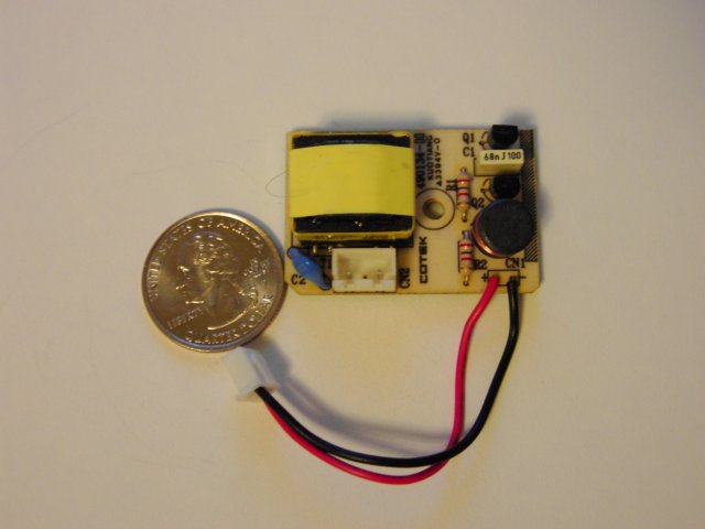

zap
  • Posts: 1107
  • There's an app for that
Re: FL inverter
« Reply #6 on: June 03, 2005, 11:48:43 PM »
Amanda in the past I've looked at every FL inverter post I could find and have always wanted to ask why everyone seems to use the 555 based circuits when smaller less complicated(and I assume cheaper)circuits like yours exist.  Are the 555 type better at handling higher current?  More efficient?  Or is it something else?
I use the inverter and bulb off a scanner like this one and a 12 volt battery for a reading light.
Unfortunately I believe I toasted one of the transistors in this one a few weeks ago when I had a 110v CFL go out so I decided to see if this inverter would light that bulb up.  It did, not as bright as when hooked to 110v.  I decided to hook it to the pedal genny to see how bright I could get it... Doh!  I think it probably gave up the ghost at around 20 volts.
« Last Edit: June 03, 2005, 11:48:43 PM by zap »

Re: FL inverter
« Reply #21 on: July 26, 2006, 09:19:46 AM »
Zap,
Two days ago I took an old scanner apart and it seems to have EXACTLY the same inverter board in it. I only have one question: do you drive it with 5V or 12V?
I'm not sure whether it needs 5V or 12V. Wasn't easy to retrace on the PCBs anyway.
« Last Edit: July 26, 2006, 09:19:46 AM by dinges »

zap
  • Posts: 1107
Re: FL inverter
« Reply #24 on: September 04, 2006, 07:47:18 PM »
Hey Peter, I hope you see this reply.
I have a few of these inverters out of scanners, only one has shown up that wasn't 12v, it was 24v.  I found the voltage listed on the main board for the first one (that I toasted).  I found out the 24v by hooking the inverter to my pedal generator and pedaling till the bulb went to full brightness.
« Last Edit: September 04, 2006, 07:47:18 PM by zap »
