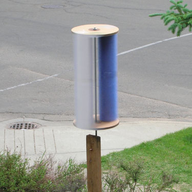

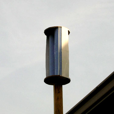

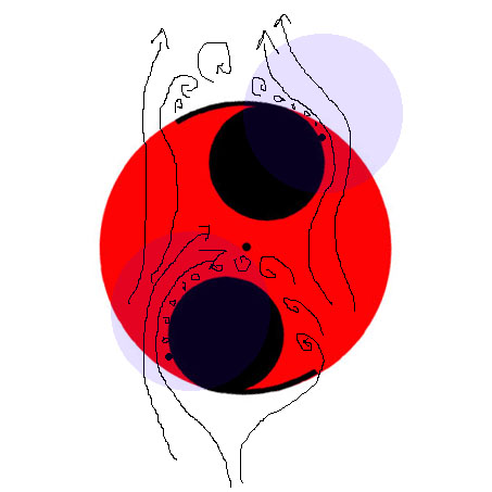

I was googling for info last night to learn more about airflow around cylinders under diff. conditions etc. and I had this idea pop in my head. I was curious to see how well a straight cylinder would work in close proximity to another. I thought about it after reading some structural engineering goop about columns and thier spacings and how it affects lift forces on the columns.
Just goofing around but it works not bad
The tabs/flaps/trailing edge thingies or whatever you'd like to call them are to simply let the unit know which way to turn but I'd bet it woud keep rotating in the same direction without them if you nudged it at the start. BTW, it self starts nicely.

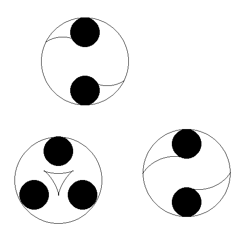

The simple plan
Anyhow, just having some fun.
Mike

slick roto, very slick! do you think your geting any of the venturi effect you've been looking for? if looks fab. from any direction.whats your gut feeling on rpm/torque. if the thingies could seperate and distend from the cylinders you could get a darius type boost. if the next one is shaped like a yin yang symbol...

Funny you should say because the next one is shaped like a yin yang symbol. I'm just trying to work out the space between.
« Last Edit: June 08, 2005, 12:18:46 AM by rotornuts »

What happened to the venturi (Lenz whatever) rotor?
I have seen this before, but the cylinders where rotating creating lift.

This little thing actually should utilize the venturi effect through the center to accelerate the shed vorticies and help them adhear to the opposite cylinder on the down wind side creating additional lift, If it wasn't for the axle possibly screwing that up. That's the theory anyway. I did this thing because I'm trying to understand the airflow around these things better. It's interesting what starts to happen as the rpm increases but it's nearly impossible to predict because of the unusual flow characteristics of rotating cylinders of varying surface roughness. I know the unit as a whole isn't a cylinder but the faster it rotates the more it "appears" as one. With a hole through the center I'd speculate the air flow throught the center simply occilates at higher rpm. I'm hoping to learn something from these kinds of experiments. Also as a rotating cylinder regardless of surface roughness accelerates the angles of the incoming and departing airflows changes as the stagnation points starty to move towards the upwind side of the cylinder. Question is how to take full advantage of that. Another question in my mind is what kind of effect does the boundry layer around the cylinder as a whole have on reducing the drag on the upwind side if any at all. A blunt leading edge like in the above model should present alot of drag but as part of a rotating cylinder it may not be that bad.
I'd give my left...  for a wind tunnel.

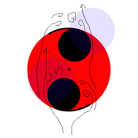

I have difficulties to imagine how lift is created on the down site, actually the hole concept gifs me difficulty's.
I must add it to my long to do list and make a model and use some white smoke in a carton box wind tunnel to see the airflow. I was thinking about smoke from a model train smoke generator. It's a little pill or some fluid heated up creating fat white smoke.

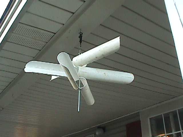

I think the flaps will have an effect on the operation of the device.  When a fluid flow encounters a cylinder, it will tend to double in speed as if goes around the cylinder.  In your diagram a pressure will develop against both the top flap and the bottom flap due to the air flow around the structure.  As the structure turns, both the top and bottom flaps will have a force in the direction of rotation (clockwise as shown).  With increasing speed the maximum force will tend to shift toward the lower flap.  It appears that in principle this could rotate with the speed of the flaps up to twice the incident wind speed.  An obvious thing to check is this maximum speed for a well balanced and designed example.
« Last Edit: June 08, 2005, 10:39:15 AM by finnsawyer »

I have no info on performance. I need to get a wind meter and a small alt to start testing some of these small models. I agree with your assesment on getting the speed up there which is why I made this model with a high aspect ratio. It's only 6.25" diameter by 13.5 high so it's usless for gathering perfomance info.
Like you always say so much fun so little time(and these days money)
Btw, I've seen CL figures of 1.6 for some rotating cylinders. Were talking some high reynolds though.
See below for a small modification

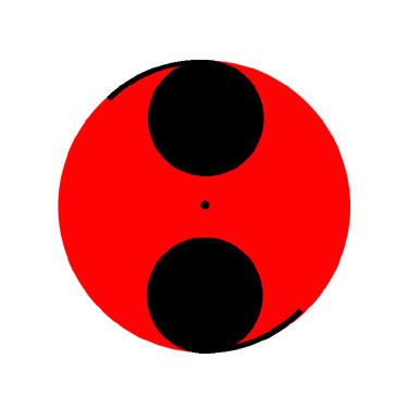

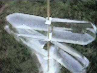

Agreed GeoM, The flaps are needed but I wonder how bad or for how long.
Anyway I made a small modification today. Below is a picture. It'd a trip wire just inside the circumference on the lead edge. Should help with startup and and cruise performance. It acts similar to vortex generators so the boundry layer should stay attached longer over a greater percentage of the rotation. Look for thr little white strip on the lead edge.
So far it seems to be working as planned. Startup is smoother and I'm seeing better and smoother rotation at lower windspeeds(visual).
Still having fun and learning lots.
Mike
« Last Edit: June 08, 2005, 06:10:00 PM by rotornuts »

Rotornuts, can you explain the relationship between the cylinder diameter and the gap between the cylinders?
This strip looks a bit big, I thing a tiny sharp strip will do the job. It will become a negative drag component when tsr>1 I think?
I must be creasy not have seen the lift part of this funny rotor.
While the cylinders are rotating on their common axis they create lift, see this nice online simulation tool from nasa:
http://www.grc.nasa.gov/WWW/K-12/airplane/foil2.html
Choose input -> Shape/Angle
Choose Shape-> Cylinder
And adjust Spin rpm, Radius, Span.
Greetings,
Ray

I've noticed even these days I'll read a paper that was published on a subject pertaining to turbine modifications to improve performance and realize the individuals involved didn't really understand the the working conditions of the turbine or they will have operated off previous assumtions. This of course leads to a distorted picture of reality and inaccurate results. Alone it wouldn't really matter but I'll then see the same information repeated again and again as though it is gospel by folks who rather report on others work rather than do thier own and voila, a myth is born.
If I told someone, ok, mount two cylinders on a rotating disk with a small flap to distort airflow and you'll have something that spins not bad, I'd get funny looks. I tend to forget the common you can't do that stuff and forge on thinking, well it may not work when you do that but what about? Of course I'm known for not knowing when to give up.

I've used the Nasa sim. before. It's very helpfull at first. Now you have to try and visualize what irregularities such as the two cylinders and intermitent pressure drops and spikes might do to the flow. The size of the strips reflects the size of the model. The lower the Reynolds number the larger the features need to be. It's kinda why you can get away with crude models like the ones I've been doing. The airflow at these sizes is responsive but forgiving. I'm very curious have this will scale. I didn't use any hard theories on gap to diameter ratios I just made the spacing half the cylinder diameter. Too much space and the flow off the upwind cylinder may not adhear to the downwind cylinder with enough energy, too little space an you needlessly restrict air flow. I don't know yet how to properly calculate spaces to manipulate the airflow the way I want but I'm looking for info. I almost forgot, the stall strips(Trip wire) are just within the circumference of the unit so as the rpm increases they fall out of use, almost. I may want to move them inboard a touch more, we'll see.
Mike

you've added a small dia. tube or wire to the cylinders just ahead of the flat flap thingie? this creates a vortex in the air which moves over the surface of the flap as it rotates? this is an improvement over a smooth surface displacing the air as it rotates? i don't understand enough about fluid dynamics to appreciate what your doing. i would have thought a fast smooth air flow over the exterior surface would increase speed/ reduce presure , and increase lift. turbulent air on the inside of the "wing" creates pressure. have i got that wrong?
« Last Edit: June 09, 2005, 09:47:04 AM by electrondady1 »

Ok, heres how I'm looking at it. I did a couple illustrations with crude streamlines added to show the effect I'm hoping for.
As I understand it it's kind of an energy thing. As the air flows over or around a surface it loses energy and it's ability to remain attached to the surface. A trip wire/slot/slat or vortex generator creates vorticies or eddies which are energetic and will share some of thier energy with the airflow allowing it to stay attached longer thereby increasing lift and reducing drag and stall. Trip wires are probably the worst of the above devices for delaying separation(higher drag penalty) but they are the easiest to make.
So you may ask yourself if there is a drag penalty to these devices how can there be a benefit? Because the increased lift and reduction in drag is greater than the drag induced by the device.
The first illustration shows the flow without the trip wire with the unit in the stall position. The unit will not start to rotate untill the lift on the lead edge is greater then the drag on the trailing edge but as the unit starts to move clockwise the drag initially becomes greater on the trailing edge and defeates the lift on the lead edge so the unit slips back again. at 3-4 MPH the unit weathervanes and rocks back and forth untill the wind speed increases to about 5-6 Mph at which point the lift on the lead edge is strong enough to defeat the drag on the trailing edge in the stall position and voila, off she goes spinning nicely. The action I just described told me I wasn't generating enough lift on the lead edge and it was likely due to seperation on the lead egde(see first diagram blue areas) because that's what cylinders do at low airspeeds so the fix was a device to impart some energy into the airflow hence the tripwire.
It's questionable what the overall benefit is but at startup it helps alot.
Without trip wire
With trip wire. Note the areas in blue and how the air follows the curvature of the cylinder
Mike
« Last Edit: June 09, 2005, 12:46:51 PM by rotornuts »

Re: 2 cylinder VAWT
« Reply #26 on: June 09, 2005, 06:19:12 PM »
    Oh...Wow! what a neat use for a bunch of
2 liter plastic pop bottles! The flaps could be
the labels.
    2 pop bottles, bottom ends hot glued together
makes a nice long cylinder....
    (trivia)...probably a little known fact that
the bottom ends mesh together!
    I'll just have to try it tomorrow!
    Just goofin' around too...but Hey...if it
works..   coffee cans....pop bottles...maple seeds....whatever huh ??
              Havin' fun in NE Ohio..tho'
           hot!       ( :>) Norm.
Was doing it like below ..but maybe your way will work better and simpler.
« Last Edit: June 09, 2005, 06:19:12 PM by Norm »

Somebody tell me if I'm crazy or not.
What if you increased the number of cylinders to 3, and put the centre triangular section from the Lenz turbine in the middle?
« Last Edit: June 09, 2005, 09:13:48 PM by commanda »

Re: 2 cylinder VAWT
« Reply #31 on: June 09, 2005, 10:05:17 PM »
Looks a lot like mine
I think yours would work better cause the ends are cupped.
« Last Edit: June 09, 2005, 10:05:17 PM by wooferhound »
