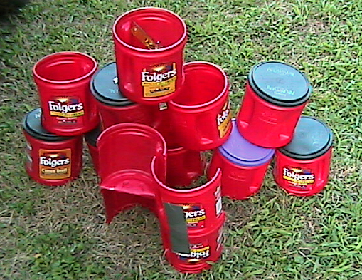

  Are those Folgers red plastic coffee cans?....
if they are...wise choice....if they're not ..
I urge you to switch....LOL!
  (last count I had 10 of them) (2lbs. 7oz) back
in about 1960 they were 3 lbs. and cost about
$1.50 a can.

 Bruce,
Here's the plastic ones.....
Would make one about 6ft. high and about 1ft.wide. (thats a lot of coffee mostly my wife
and I...about a years worth.)they won't rust ..
edges can be scraped round with a pocket knife.

Great Idea about the coffee cans, I'll have to give 'em a try.

Question about stability on those cans. Any flexing in high winds? I can see the bottom, now middle section as a good cross piece but would be a little worried about the end to end during gusts.

   No problem with the ends...  just drill a 5/16 hole in the corners. Take a 3/8 wood dowel rod a foot long and run it thru the vertical shaft 1/2 steel conduit 5/16 thread onto the ends of the dowel rod. Metal screws and washers
on the inside edges of the cans to the metal conduit shaft. After you get it all assembled you get in the back of a pick-up and
'road test it'...should be good for at least
70mph.

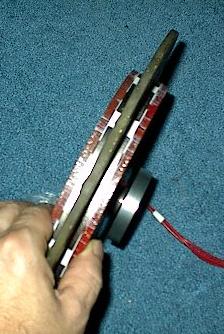

    It's basically a 12 pole 9 coil layout.  The lower power units used #20 wire, 45 turns per coil.  The higher power units used #18 wire same amount of turns.  These are for some small VAWT's where the rpms aren't a big concern. Cut in is at around 100 rpm for 12 volt charging.
    I used my wedge shaped magnets on these also.
