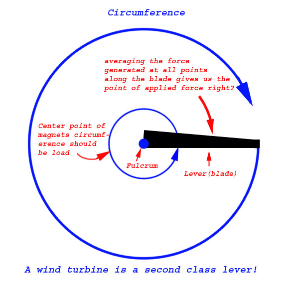

Devo's recent post regarding placing the magnets around the circumference of the rotor got me thinking about when I was thinking about doing that a year ago. At first I didn't remenber why I abandoned the idea but then it dawned on me. I remember now I realized a windmill is just a lever and the farther away from the fulcrum you place the load the more torque you require to do the same amount of work, granted at a higher rate.
I reasoned that placing the load on other side of the applied force would likely require require too much torque. It's funny how we can forget the reasons we come up with different ideas but this way of looking at rotors led me along a twisted path to the single blade thing.
Anyhow, I thought I'd kick this can into the circle and see what happens. It raises questions about alternator diameters and the importance of the root section in overall torque production given the root is so close to the load. Other questions arise as well.
See image below
I guess these days I wonder if maybe this line of reasoning is flawed as the total amount of work done may remain the same and only the velocity changes. I'm inclined to keep thinking it's relevant.
Give it a kick.
Mike

This is an excellent subject that leads to the question where is the optimum point between the centre & the tip or is it just a trade off?
I am thinking farther out could use less wire because of the speed the mag passes the coil which should decrease coil resistance ,adding again to output. I guess experimening is the best way to answer.
What did you use to draw the diagram above? I often wish I could draw or create an image of my idea to show others what I am thinking but I don't know what to use to accomplish it?

The 'average force' is all from the wind. There is more wind area in the outside half than the inside half.
So wouldn't the 'point of applied force' average be much closer to the outside?

Probably closer than shown but the above is just to illustrate the point.

  The way I see it... its the same.  If you have a turbine producing 100 watts at 200 rpm in a given wind then its making approx .134 hp. Lets assume the lever is 4 ft.  If the magnet center radius is at 12 inches or 1 ft then the "lever" would see 3.52 ft lbs, If your drawing power from the outer edge the torque would be .88 ft lbs.  Basically you would have to change the alternator to react the same at a different torque level to match the power.
  The only reason you need to increase the diameter of the alternator is to overcome certain limitations of a smaller diameter.  Such as magnetic area, more room for wire etc.  If you simply move the magnets from a small diameter to a larger diameter you will overall decrease its output.  For instance a 12 pole on an 8" disc, then moving the same 12 magnets to a 12 inch disc.  Granted the magnets will be moving faster but the timing is altered as well as making the coils larger and increasing the resistance.  If, on the other hand, you increase the diameter and add more magnets this reduces coil size, adds more magnetic area as well as other changes in variables that will increase your output, still having to match the output of the turbine at a given rpm.
  Overall, If you can make the alternator smaller and still achieve the power required then this is the most efficient way.

  A lever yes....which is why the old pumper
windmills had many blades near the outside edge
...they didn't the shaft to turn fast, they wanted
something that had a lot of torque instead of
high speed even at that they needed gear reduction
to slow them down even more and increase the torque.
                  ( :>) Norm.

I guess I'm just thinking about the trade off here.
If you have a windmill that can produce a torque of 5ftlb at 6' and is doing so at 200 rpm then you have 2.28 hp available at .5 'radius for a 12" alt but only 1.95 hp available at .583' radius for a 14" alt. So then can I assume that the increase in velocity of the flux lines crossing the coils offsets the decrease in available power to yield an increase in overall work done or efficiency?(I do realize that there is a limit to the work potential dictated by the power produced by the rotor)
I must be missing something with regards to the velocity component.

  Looking at it that way it sounds like smaller is better.  If you had a 6" disc then the power would be doubled ( 4.?? hp).
  In reality the 12" disc is 3.14 ft in circumference and the 14" disc is 3.66 ft.  At 200 rpm the 12" is traveling at a speed of 628 ft per minute and the 14" is moving at 732 ft per min.
  So 5 lbs on a 6 ft lever = 60 lbs of force at .5 ft and only 51.46 lbs for the .583 so...
  1. lbs x 628 ft = 37,680 ft lbs / 33000 = 1.14 hp
  2. 6 lbs x 732 ft = 37,668 ft lbs / 33000 = 1.14 hp
  Ends up being the same...

Seems like I was missing something, namely the right equation for calculating horsepower for this application. I used rpm which remains constant for both scenarios. The equation I found says HP = torque x rpm/5252. Our torque calculations were the same but our horsepower fiqures differ. Why are there different equations and why do these two differ?

  The lever formula ( L x W / l = ft lbs) is what throws it off I think.  If you place 5 lbs on the end of a 6 ft lever with a .5 overhang from the center point then your balancing the weight with 60 lbs.  It doesn't actually include the amount of work it's actually doing.  It seems logical to use the number in "ft/lbs" as if you were cranking it 200 times per minute but the actual work done is different.  You would end up putting the 60 lb weight on a rope that was 628 ft long.  So your raising the 60 lb weight 628 ft in one minute.  The same with the 5 lb weight at the 6 ft radius.  The circumference being 37.7 ft per revolution with 5 lbs or 37.7 x 200 x 5 = 37700 / 33000 = 1.14 hp.  So by hanging the weight on the center .5 radius and running it backwards so to speak is the same as well.
  If you have a spinning machine with a prony brake or dyno showing the force in ft/lbs and measuring the rpm then the HP=torque x rpm is correct.  The difference, one is the measure of force and the other represents the amount of work done.
  Fun stuff.. I actually confused myself while calculating and came up with some real odd numbers...
