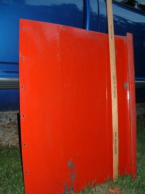

I've been following your trials with great interest. I've got some plastic panels that I thought would make a good Vawt but didn't want to cut them up and waste them.  These panels are 38" x 30" x 1/4" with a 3 3/4" diameter curl on one end. They look like your wings. So how big did you want to scale up and what do you think the weight limit of the wings would be? I'd love to see these put to use.

  Wow, pre-made wings!  What was its original use?  You could make some fine machines with that stuff.
  The weight limit would be determined by the strength of the material and structure holding it as well as the rpm.
  The 3.75" curl would be great for a tall small diameter machine... good rpm... they'd work well in a 20 inch diameter turbine.
  I've been thinking of going to a 3ft diameter using the same alternator.   The wing (nose) diameter would need to be about 6.75" and the length would be a total (including the nose )14.6 inches long.

They were bumper pads off of industrial dock doors. Some had significant damage, but quite a few are in good shape. I cut a couple of panels into 6" strips and used them for blades on a TDM mill. Where are you located? If shipping isn't too expensive would you like to try a few? I can cut the wing length down to approximate size first.
