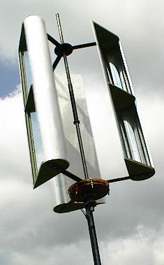

  Well once again I'll bore you with some details of the 2nd genration in larger form.  It scales up very well indeed!  Although its still fairly small being 3 ft in diameter and only 4 ft tall it performs magnificently.

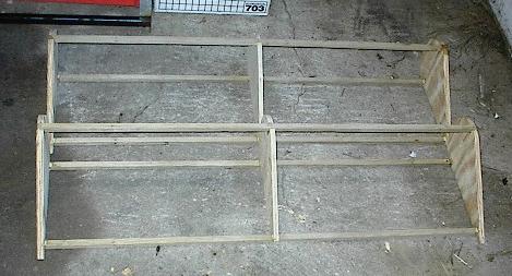

  I wasn't sure how I was going to make the larger unit but I wanted it strong enough to put up on a more permanent basis.  I decided to build them similar to aircraft wings with ribs and stringers and cover them with some .020 aluminum I've been saving.

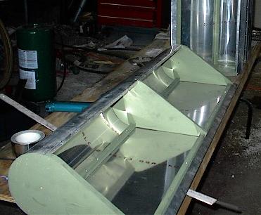

  Built the wing frames....
  Then cover'd them...
  I had some concerns about not using the discs on top and bottom and actually started making them out of plywood.  After drawing out the circle and seeing how much material it was going to use I decided on a lighter/stronger system.  I wasn't really sure if the discs helped funnel air through the wings, enhancing performance on the little one, or possibly hindering it a bit.  I wanted to know and I figured I could build a lightweight disc to add later if it didn't seem to work as well.  The main unit with the alternator weigh'd in at around 60 lbs.  The 6ft 1" solid steel shaft is 20 lbs of that weight.
  Below shows the finished unit mounted once again on the loader of my tractor.  Makes it easy to get it up in the air....
  Still not real windy we were getting between 2 and 12 mph.  I started as I did before sitting on the bucket watching the meters... amps, battery voltage, and wind speed.  I only spent an hour outside today and took 15 samplings while watching it run.  I must say I am impressed.
  I used the same alternator that was on the small one so I was concerned about the cut in speed moving up to a 3 ft dia from the 2ft although I suspected the unit would over run a bit making up some of the differences.  I no more that put it in the air and it was spinning, the lowest reading on my wind meter was 1.5 mph she was running.  After a small treck to an open area where the air was moving freely things started getting fun.
  It starts charging in a 5.5 mph wind, almost the same as the small one.  At 6mph its doing 4.97 watts, at 8mph its running 13.3 watts and the highest reading at 12.5 mph she was doing 52 watts.   I'll let you do the math.  The average efficiency from the lowest wind to the highest was 36.5% of total area.  My reading in real low winds were low, I believe, because it was simply over running and hanging on the edge of charging which showed around 25% efficiency.  Its been sitting between two buildings out of the main wind with the clips locked together (shorted) and it has yet to stop spinning very very slowly.
  I guess its time to build another one... only bigger!  After this one is mounted of course....

  Thanks all for the kind words.  For the next one I have my eye on some cardboard shipping drums that are 18" in diameter and stand about 29" tall.  I recieved them when I ordered some NOS 3kw generators and saved them for some odd project... I think I found a use for them.  This would make an 8ft diameter machine about 7ft tall with 39" long wings.  Could be interesting.  I doubt I'll have time to build it up this year but it sure sounds like a fun project in the near future.
  Oh, I forgot to mention... I built up a 2 bladed unit to test out... It was quite poor.  It produced 1/2 the power of the 3 blade.  After tinkering with it for a few hours I decided it simply wasn't worth the effort.

    If your building it the same size, a 6.75" circle and a straight line from the tangent of the circle forms the wing shape.  Total length of the wing is 14.5 inches which includes the nose. Then simply draw a straight line from the trailing edge to the tangent of the circle for the open side.  I took a piece of treated lumber to make the stringers.  Ran them through the table saw making them 1/2" thick by 3/4" wide.  Notched the ribs to fit snug and glued them in place.  Bend the sheet to fit on the inside of the top stringer ( 1/2" ) and rivet it to the stringer using 1" long aluminum rivets.  I spaced them 3 inches appart.  Once its attatched its fairly easy to pull it around the nose and clamp it in place to run the next row of rivets on the next stringer untill it's all attatced.
  With aluminum that thin ( like flashing ), it will make a tinny noise as it rotates when the metal flexes and will cause fatigue fracturs over time.  You may want to coat the aluminum with some spray on undercoating or something similar to reduce the fatigue ( and noise ).   I'll see if I can come up with a drawing showing how the ribs are laid out.

  I had put some thought into making an articulated blade system for it and your right, if it was well worked out I believe you could squeeze some power out of it.  If the down wind blade moved outward, adding more area to the unit,but it's possible it might actually hinder its performance.
  Consider for a moment what is actually going on with the wings.  If the incomming air is moving at 11.5 mph and the machine is extracting power at a TSR of .8 ... what are wings actually seeing?
  Lets consider the downwind side firstly.  If the blade is moving at a TSR of .8 this means the blade is moving away from the wind at 9.2 mph so in reality your only collecting from a 2.3 mph wind... ( 11.5 - 9.2 ).  Any significant increase in rotor size won't make a lot of difference on the downwind side.
  Now, on the upwind side the blade is still moving at 9.2 mph but into the 11.5 mph wind or a total speed the wings sees is 20.7 mph so it only makes sense to collect as much as possible from that side of the turbine.  You could, however, articulate the upwind blade enough to enhance the amount of time it carries maximum lift which would definately help.
  Once you start thinking of what the two sides are actually doing it makes it easier to see what can be changed to make it better.  I chose not to articulate the blades in order to keep it simple.  At this point it performs well enough to continue developing the basic unit.  I'll get bored with it soon enough and will attempt other changes as time goes on.
  There is a point to any project which it becomes more expensive, elaborate or difficult to eek out fractions of increases.  Similar to building a race engine.  You can do alot of cheap things to a stock engine to get major power increases,  beyond that things start getting more expensive for smaller gains.  You simply need to weigh the benifits over the cost or in this case the intricate workings of a cam/tail based system... could I get 2 more watts out of it? sure I could !  Would it be worth the extra labor and complexity?   not sure.
