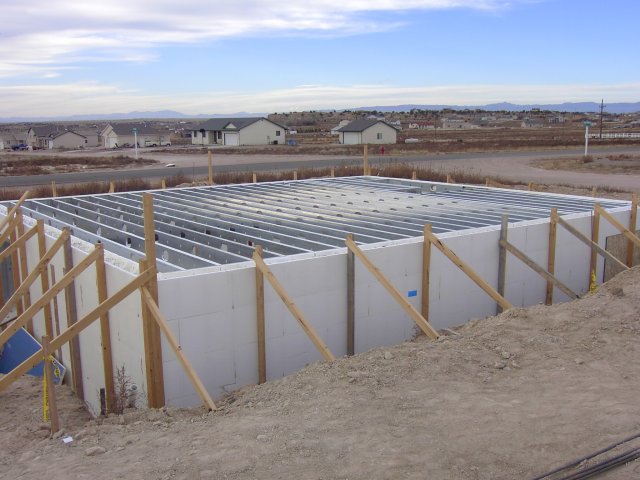

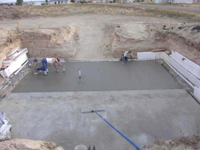

We decided, after watching the ICF distributor build a house nearby, that pouring the basement floor before assembling the block for our foundation was the better way to go.  It offered better support for the 1st floor framing which was basically poured in place while we poured the foundation.

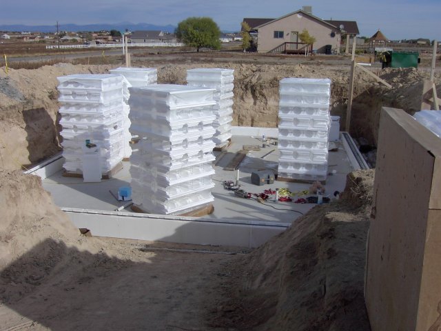

Here the basement slab is poured and the first row of ICF's are in place with rebar installed.  If you get the first row spot on... the rest is pretty easy.  The ICF's we used required either construction glue or foam for assembly.  The distributor we bought from builds up panels in his shop for many of his projects and then trucks the panels to the job site, making for an even speedier build.   Note the vertical 2x's in the corners which help to keep things true.  The foundation ended up 1/4" out of square and 3/4" out of elevation... not bad for a first foundation AND we did not have one single blow out.
The floor joist are Dietrich TradeReady® joist and I was very impressed with the system.  The only problem was that the distributor was new to the system and ordered and shipped almost every joist the wrong length.  They weren't too tough to cut with the sawzall and the package was cheaper than using wood.  You can't see it from this picture but foundation bolts were placed through the rim joist and block every 2' before pouring concrete and in this picture the whole floor is resting on 2x4's running down to the basement slab about every 3 feet around the inside perimeter.  After installing the subfloor, this gave us a nice platform from which to pump the foundation full.

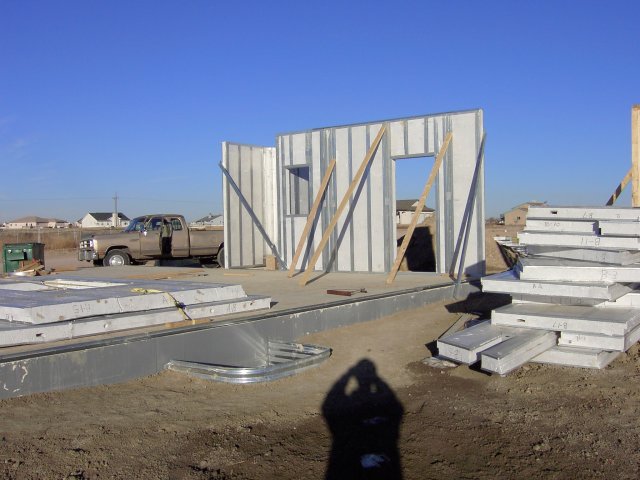

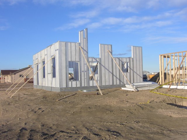

The walls arrive from Virginia and erection begins.  The walls come as a complete package with every piece marked and drawings to show where each one goes.  This house is 1500 sq. feet and the whole package fit in about 1/3 of a semi trailer.  The panels weigh next to nothing, I think a 4'x8' panel weighs around 42 lbs. which is less than one sheet of 1/2" OSB.  We lost part of the front wall to high winds when we left it over one weekend... not enough bracing.  One panel had flown maybe 40' but only one of the panels was damaged and it only required a little foam-in-a-can to repair it.  All in all these panels proved to be quite strong.
Here's a good shot showing how the wall panels interlock and stack.  The Thermasteel panels incorporate a shiplap overlap producing a very strong and air tight structure.  Some of the more complicated panels come preassembled.

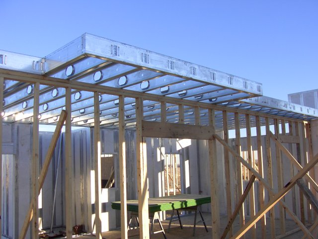

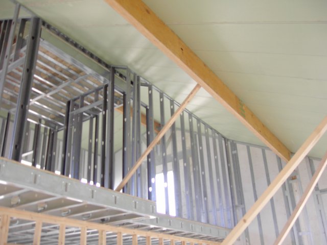

Here's the 2nd floor framing.  Except for the main support wall you see here, OSB flooring, and the roof beams, everything is foam and metal.  If I would have been on top of everything, even this wall, would have been metal and just the few studs that went into this wall required culling and even some cutting and straightening before the drywall was hung.  Vendors should really be ashamed of what they try to pass off as lumber these days.

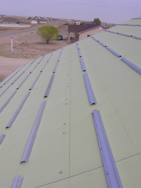

Here you can see the roof panels where they have been stitched together and down onto one of the roof beams with 10 inch screws.  The hat track on top of the panels was added because the city wouldn't let us install a membrane roof.  OSB was screwed onto the hat track and then roofed as any typical roof.  This added cost/time to the construction but also added an air space which most likely added a bit of R value and keeps the roofing a little cooler.

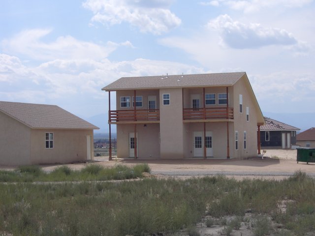

The finished house.
