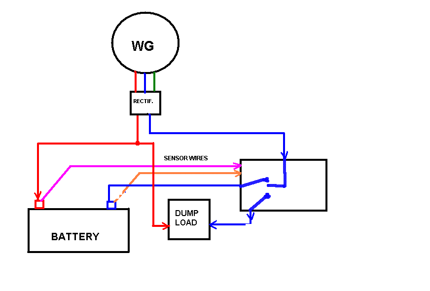

Here is my system as configured now. It's not very good schematic, but I hope you'll understand it.
Two wires that are directly connecting battery and the regulator are "sensor wires", which "tells" the regulator what's the batt voltage. If the battery voltage drops below some point ( e.g. 11,5 V), regulator switches on battery charging option, and switchess of dump load. If that voltage rise above some voltage ( e.g. 13,8 V), the dump load connection is switched on, and battery charging connection switches off.
If I understand you, I can connect one more wire to charge the battery even when dump load is connected to wind gen. Only, I have to put one large power diode in that line, so that dump load don't drain the battery.
I tried to figure that on other pic.
Is that good? If I missed something again, please point me to some schematic or so.
Thanks!
« Last Edit: September 18, 2005, 02:03:21 AM by amiklic1 »

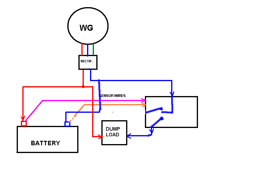

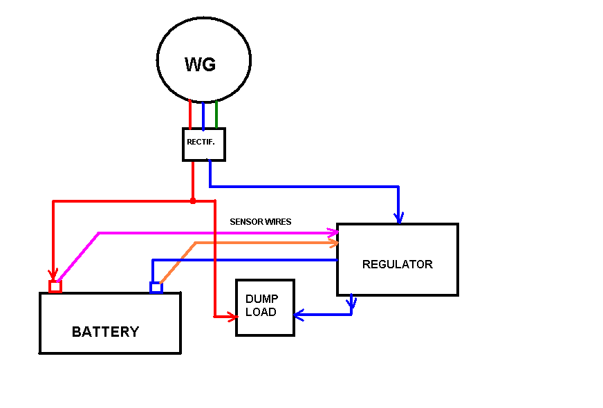

Re: Piggot's design wind generator 4'
« Reply #6 on: September 18, 2005, 02:23:11 PM »
I assume your relay is connected like this.
If so change to this.
« Last Edit: September 18, 2005, 02:23:11 PM by Flux »
« Reply #8 on: September 19, 2005, 12:49:49 AM »
Your batteries can float indefinitely at 13.8v. If they are down at 12.5v they are still charging and will rise slowly to your dump voltage. If they don't there is a problem with them .
Normally for wind I would dump at a bit more than 13.8, perhaps 14v is a good compromise. Batteries will not boil until you exceed about 14.4.
I think you said you were testing with an old battery, if it has a bad cell then it may start to boil below 14v if one cell has a partial short.
« Last Edit: September 19, 2005, 12:49:49 AM by Flux »

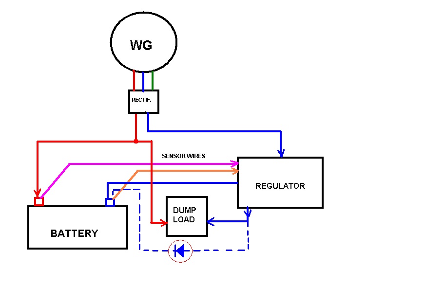

 I find that connecting the circuit this way would cause dump load to drain batteries to 11.5 volts ( regulator's switch-in voltage). My regulator is connected so that it starts charging when voltage comes down to 11.5 volts, and quits charging when the voltage comes to 13.8 volts. I place the line in the picture to show the connection between battery positive and negative.
I mount one diode close to the battery positive connection, to prevent current leakage from the battery to the any kind of electronics and the dump load. I hope this is good. I think that only way would be to increase the switch-in voltage to some higher value, as my regulator is working at the principle of high and the low voltage to keep battery between.
Let's say that I change switch-in voltage to 13.5 volts. When the voltage comes to that value, the regulator would switch-on the battery charging. At 13.8 voltage it would switch-on the dump load, and keep it switched untill the voltage lowers to 13.5 volts.
I can see that battery voltage is about 0,6 volts higher when the generator is charging the battery. I can use that information to fine-tune the regulator. So, when you mentione d 14 volts, maybe that would be the right deal.
Also, if I short-circuit the battery for a second after charging stops, the voltage goes even lower. I'll try to measure that info and use it all to make some tuning.
« Last Edit: September 20, 2005, 08:19:50 AM by amiklic1 »

Sorry for the bad picture, here is what I meant to send:
« Last Edit: September 20, 2005, 08:27:36 AM by amiklic1 »
« Reply #12 on: September 20, 2005, 09:19:55 AM »
The diode is a good idea to prevent draining your batteries if the dump load fails.
You are right that 11.5v is too low. For lead acid batteries you can run down to about 12.4 v without taking any significant charge from the batteries but cut off dump at 12.6 and cut in at 14 to 14.2 would be better.
I seem to remember that you are using NiCd batteries so you may have to change the figures a bit. You need enough difference between on and off to keep the relay from cycling too often, but you need it to be off before you discharge the batteries more than a few %.
I think Nicd's drop voltage quicker than lead acid so that off at anything above 12v may be ok. I really have no experience of NiCd under these conditions and don't know if they exhibit surface charge. I was under the impression that voltage was no indicator of state of charge and you may have to work with a close ratio of on to off.
I forgot that you were not using lead acid.
« Last Edit: September 20, 2005, 09:19:55 AM by Flux »
