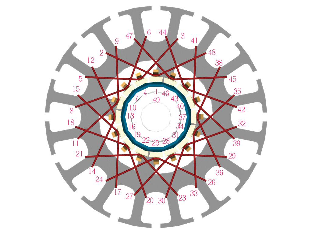

here you go-----
                scootersupport.com/motorrewind.htm

The wiring shown in another message for this thread is not right for a 3 phase wiring.
