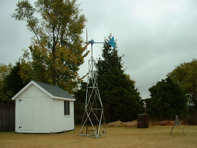

Well this is my time killer!  As you can see, the location is very bad.  I'm in town and don't think I can go much higher than I am now(20') without using neighbors yards. It is a .75 hp motor conversion with a 5' diameter carved prop.

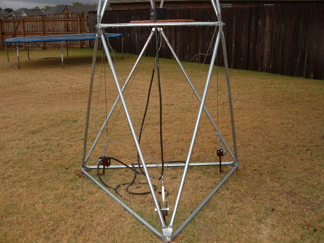

I didn't want to have to deal with tripping over and mowing around guy wires and so I internally guyed the tower.  Should be OK at this low height.
Don't have any numbers yet.

Sweet! I would be interested in some details on the tower. It looks like it is built from EMT. Also curious on the "internally guyed" aspect of your setup.

The tower is built from EMT. This one is 3/4" and is built from a design that I read about several years ago in a book by Michael Hackleman.  I believe the book is "Wind and Wind Spinners", might be different book though.  I would read any of his books on Wing Gennys as they are a hoot to read. His design is for a 44' tower from 1" EMT.
My guy system is simply eyebolts at the top of the first section and mobile home anchors in the ground, and very hard clay ground it is! I hope the pic is clear enough to show some detail because I seem to be having a hard time explaining it!! lol.
