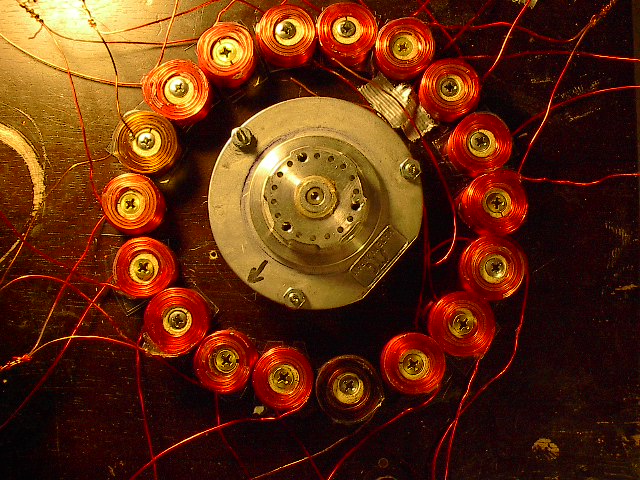

These are the coils on my little genny ..

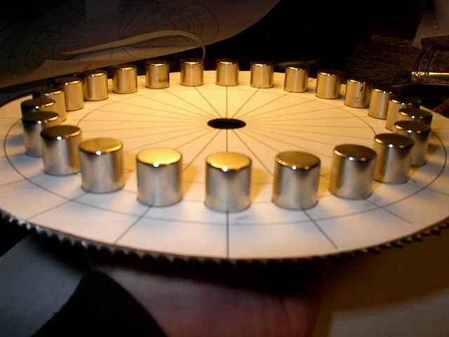

there are 18 coils and 24 magnets as keeping with the coil to magnet ratio of 3/4 ..
the coils are wound with # 20 gage wire  and are 0.96" inches in dia ,  well most are anyways, some are 1.020''..
i had origionally wound them with #17 gage wire , but wasnt getting the voltage i wanted..
these are much better..
they give an open circuit rectified three phase voltage of 22V..
the short circuit current into an ammeter ,is 5.34A @ around 2V..
although i havnt got the room to install it outside , i do have it hooked to an excercise bicycle , and use it to charge NiMH batteries all the time..
the magnets 1/2"dia. x 1/2" cylinder neo magnets ..

it's a pretty design is'nt it. I build one much much bigger then this about 3 years ago. Here are my suggestions. Your not completing the magnetic path for your screws. You need to consider a bolt that connects to metal backing. This would increase your output 100 fold easly. Your amps and volts would go through the roof. The problem is cogging, but if your magnets to coils on your rotor which I assume is metal as well then you should'nt have any problems, though you will notice it anyway, however the power output will more then make up for it. (you can also stagger or sku the magnets) Good Luck.

The magnets are stuck to a 8" saw blade..
The screws in my generator are brass and stainless to avoid cogging.
Because of the thinness of the blade , vibration is a problem..because it bends..lol

delta ? or double wind?
« Reply #4 on: November 05, 2005, 11:47:51 PM »
Which would be better ?
i have some new magnets on order, 7/8" dia. x 1/2" long , supposedly 37 lb. pull  , so i gotta make some new coils ..
I've been running some numbers and the resistance  of each coil is bothering me a bit..
I've calculated that a 1.75" dia. coil of #20 gage wire , with a 0.855" hole and 0.49 thick , will have a resistance of 0.558 ohms.( about 55 feet).
with a 12 coil geny it comes to 2.23 ohms /phase.
so the Line to line resistance for Y (or star)is 4.46 ohms , kinda yucky.
but the line to line resistance for delta is only 1.51 ohms, much better..
so i think that i'm gonna go with delta because even if i double  wind each coil the line to line resistance ,of star connection ,is still 2.23 ohms .
any thoughts?

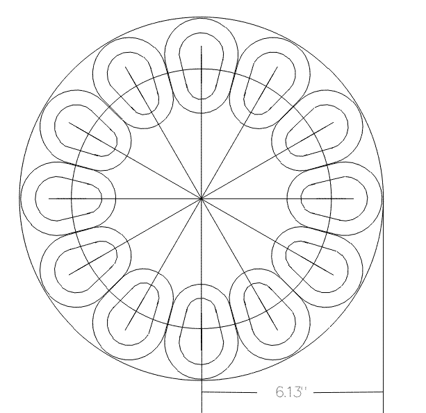

Re: My little genny
« Reply #7 on: November 06, 2005, 09:24:12 AM »
hiker this is a better design for your 12" dia saw blade..
it is designed for 16 , 2" x 1" neos.
the outer dia. is 12.266" but that is the stator the rotor is obviously within your 12" limit..
this design
as you can see there is very little  wasted space between the coils..
if ya want i can post all the dimentions..?
« Last Edit: November 06, 2005, 09:24:12 AM by willib »

Re: My little genny
« Reply #10 on: November 06, 2005, 06:10:26 PM »
They dont necessarily have to be bigger , just closer together, ie 12 instead of nine..
