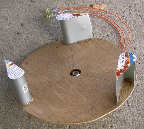

Seemed simple after I saw your upwind .mpg.
Like I said, I had 2 hours start to finish. I thought it be a cool spinner, and would keep turning or at least turn longer in the wind.
The base dia is nearly 10", the height is 2.6", the dia of the leading edge(?) is 1", blade leading to trailing edge is 2.8". The angle is 9 degrees.
The tin edges are a little cleaner than they look in the photo. Only one blade has a stamp mark (far blade). It seems well balanced. And that is genuine hot glue!
Thanks Ed.

I looked at the pics on your site for the lenz2 again now. I see how it's made and understand it better after looking at the picture again. It had been awhile since I saw the picture and I was thinking a bit off. Now I see the extension and wing more clearly.
And that's the Stirling I was wondering about also. Mighty nice work your doing there.

  I see now.   Ain't that cute !   Actually the wing width should be 1.875 inches and the total length of the wind should be 4 inches.  You don't have alot of area exposed to the wind with the smaller wings.  You want to cover no less than 38% of the circumference.  10" diameter would be 31 inches circumference x .38 = 11.78 inches exposed to the wind so each wing length (chord - leading edge to trailing edge) would be 11.78 / 3 wings = 3.92 or an even 4 inches.  I use the diameter as a function for both width and length:
width = diameter x .1875
length = diameter x .4
so on a 10" disc you'd end up with...
  1. x .1875 = 1.87" width
  2. x .4 = 4" length
As a base to work with, I'm getting 5 watts per sq ft in a 15 mph wind average.  So if you built a 1/2 sq ft unit you should see about 2.5 watts in the same wind.  That would be a 10" diameter by 1.4 ft tall ( or a 12 x 12 ).  The 10" diameter should run about 168 rpm loaded in a 6 mph wind.
If you build another one let me know how it works out !

Yikes!  I sure missed something earlier.
I didn't figure the circumference made such a difference, this is the exact diameter of the Wife's strainer
The blades 'looked OK', and were as big as was here for decent metal (HD and floppy cases).
I will build another, maybe 5" high x 10"D. And maybe for fun I'll put these blades on about a 5" disk, I'll have to check the cookware.
The 168RPM will have the LEDs glowing easy enough (it's non rectified 3 phase).  More than 0.2W (7Vx0.025A) will cook the LEDs anyway.
Afraid it won't look a lot different though.  :/
