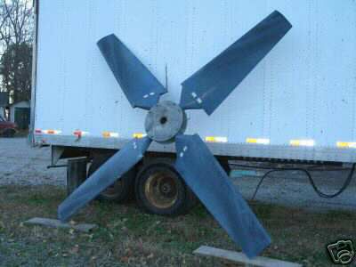

I want to go the low-prop-speed/high-torque route and use gearing to run a shaft at speed where I can "easily" connect whatever rotor or generator head I want.  As such, here is my first step.  Maybe it takes me down the path to success, or maybe it is my first big mistake.  But, good or bad, I did it.  I bought a set of 4 big fat daddy blades (14' diameter on a 100 lb. metal hub):
                          Will need a sturdy tower indeed.
At first I thought I could simply buy a 10kw head at HarborFreight.com and start cranking.  But, after doing a bunch of reading on this forum, me thinks again.  With the expecation of widely-ranging shaft RPMs, it sounds like the homemade rotor is the way to go.  (help me here, what is the proper term for the entire generator?  Generator?  Rotor?  Head?).
If each blade is 33 lbs., then we're talking about a 230 lb. propjob ( oh my gosh!  What am I thinking!?)

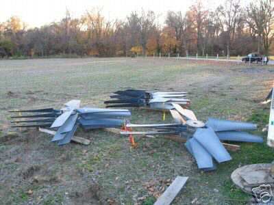

After seeing your "first" set of blades, I think I'll take back the little project I suggested from Ed at windstuffnow. I think you should search diary's by zubbly (click the search the board on top right). He has a batch (3) of motor rewind how to's. You could spend quite a while just absorbing that data... just a thought. Gary D.

  Wow Stephen !   Where did you find those?  Must be from some ventalation fans for a large secret underground complex.   They won't spin fast but they'll give you an enormous amount of torque.   Mount them on a hillside into the prevailing winds at various positions just above the ground and you'll power your neighborhood.. I count 12 of them laying there.  Thats about 1850 sq ft of wind collection or 5000 watts in a 12 mph wind total.  That will keep you busy for awhile!

looks just about like my old four blader[unfinished]--lots of tork low speed..
had it hooked to a small motor alt[geared up]..
heres my latest 4 blader[untested] the angle is in the hub --so it saved a little carving..
whats your planes with all those blades? real heavy weights-no dou"t.....

Hey Windstuff Ed, Yeah, they are from some cooling fans with "advanced aerodynamic design", or something like that.  I "won" them in an online auction.  I wish I had all of the sets int the picture (I think I wish that).  Good news for you and everyone else, there are more where I got mine!

Hiker, glad to see another 4-blader.  Would love to compare notes (or rather, just copy yours - he-he).  Am still trying to figure out my plan.

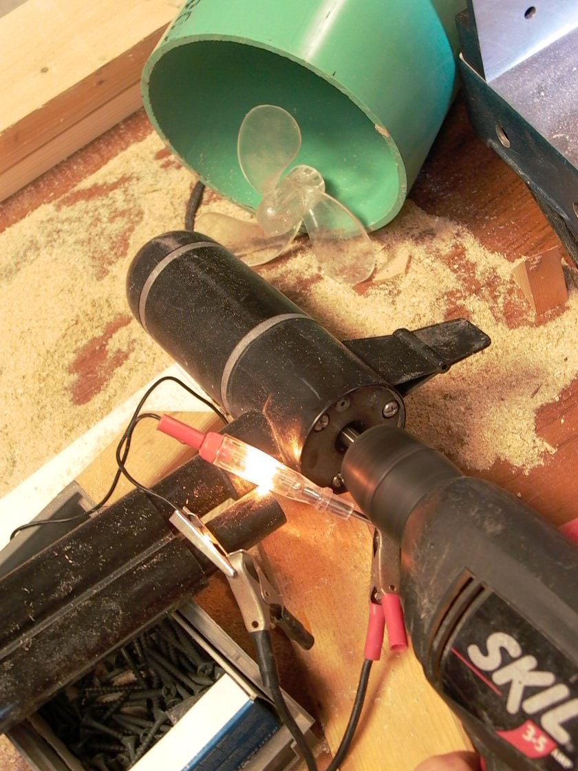

Real quickly, I came across some posts on trolling motors late last night.  Then I remembered I had a little old one of my own, so I ran out to my shed to experiment.
Using my 2900 rpm drill I was able to light up a little 12v tester.  But using a slower viarable speed drill, it did not light up.  I'll have to get a multimeter from Harbor Freight to get a full read on the output.  I though about putting a small wind prop on it.  But regardless of whether air or water, if the shaft has to achieve 2,900 RPM to produce anything, then it looks like I'm "shafted". (chuckling to self.  he-he).

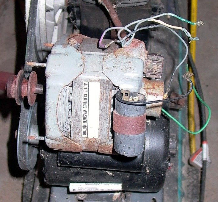

About your suggestion for using old A/C motors, is this one good for anything?

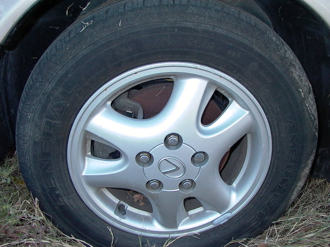

Not knowing anything yet about winding my own rotors, would the 4 rotor discs off this car be something I could use?  Also, I guess I could use the alternator and anything else I want since it won't be doing anything else with a blown engine.

   Naw I dont think you can get the washmachine motors apart.I get all my motors and metal at the scrap yards.In this area they sell them back priced by the pound.
   You can get a good motor that way for not much.Take the rotor out of a smaller motor.Knock out the center shaft and drill out the center.Then use allThread for the new shaft and glue mags on.And away you go.Look for the higher volts & amps A/C motors with lower rpms..The 230/460 ones can be used with stock windings...I am still working on getting mine right but I think ole Zubbly can advise you well.
                                 Happy motoring.          MelTx

Big blades: my secret is out...  You can find the fatdaddy blades by going to eBay and searching for WINDMILL BLADES.  They are in Illinois just northeast of St. Louis.  I'll be picking mine up on the way to Michigan for Christmas vacation.  I had this great idea about buying all of them and launching my own windfarm.  Unfortunately, one set was all I could afford at this time.  - Stephen

texwind- i think maybe you should start with something a bit smaller, like 6 to 8 ft diameter :)
most folks here seem to build a relatively 'slow' speed permanent magnet alternator first, then try to build a prop to connect that gen to the available wind conditions in their area. your setup might be more complicated by having the prop first. (though it appears the blade angle can be changed? that helps)
  1. can you make new hubs and make it into a 3 blader? this might be advantageous when it comes time to furl.
  2. this is going to need a serious tower and guys. expect to spend more on that than on everything else put together :(

toss the 100lb. hubs and make some out of plywood..[check out the photo on my 4 blader]
« Last Edit: November 20, 2005, 01:46:20 AM by hiker »

Kitno455, you might be right about my starting with something smaller.  However, I already have my mental energy committed this direction, so we'll have to see.  Having read your diary entry, I found your auto thoughts interesting.  I have a big old 1980 RWD Caddy and a 1994 Lexus FWD at my disposal.

seriously, if you plan on using that big prop, i think you need to make a smaller version of the same basic thing, and try it with your little trolling motor. be aware that aerodynamics is such that things dont scale linearly (google for reynolds number).
and seriously consider making a three-blade lighter-weight hub, as an experiment...
if you end up having to use a gearbox, one of the planetary (or both!) from the th350 in the caddy works just great, with a little welding :)
