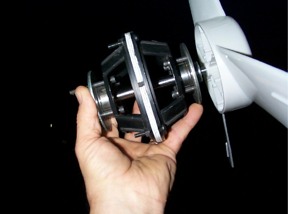

About the speakers. Yes that is two 5 1/4" speaker baskets, magnets removed. I havn't got around to finishing this littel project yet but it will be a very small dual rotor. I've use the box fan blade on a small motor conversion. That littel blade spins up real fast.
I did a diary so time back that used two 12" speaker baskets. It is a 10" dual rotor genny with Lowes ceramics.
Still working on the NEO version. Being in the audio industry scince the 60s and as my curent ocupation I've collected so many speaker I've lost count (100s).
The large (8") magnet backing plates make nice rotors.
Heres a couple pix of speaker to wind genny transition.
« Last Edit: December 04, 2005, 01:22:57 PM by Jerry »

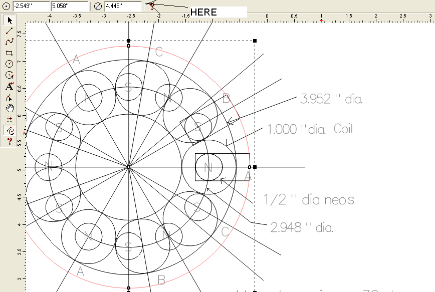

Yeah i started with HomeDepo magnets myself.
What size rotors are inside that 5 1/4' speaker basket gen.?
This is a possible gen to use in there..
http://www.otherpower.com/images/scimages/2965/9_coil_12_magnet_for_jerry.bmp
i had this one on file for 1/2 " dia neos x 1/2 inch long.. thats all i use is round magnets ,and round coils ..This site sells , or used to sell , not sure , the magnets i used ..I am wondering whether or not you have the room in there for a rotor with 1/2" x 1/2 " dia. magnets ?? You could allways use spacers in there.
anyway round coils are simple to make..
Oh , the hole in the coils is around 1/2 " , but that isnt as important as the outer dia. ..I can give you some data on the performance of using (1 inch x .480 width coils ) -20 ga. wire if you like ? i still have my older one set up.

Hi Willib.
Well no rotors in there yet. Thats one of the parts thats not done. No magnet rotor, no coils.
I'm thinking 4" diameter also. Thats realy awsome. A dual rotor at 4" with the 12 magnet 9 coil arangement.
I have some 1"X1/2"X1/8" NEOs. I havn't even layed them out to see how many will fit.
It may only have room for 8. If so I'll do the 8 X 6 arangement (Hugh P).
If I can only get 6 in there I"ll make 6 pole single phase. I think 8 will go though?
Yes I would love to see the preformance #s on the littel genny. That would be great.
I thought I was building the smallest dual rotor but you got there first.
The rotors are made from speaker magnet back plates. There easy to tap for shaft set screws and there made of very good flux material and there free.
This one uses a 1/2" shaft. Then I machined it down the match the small cheap box fan blade.

« Reply #10 on: December 05, 2005, 12:19:50 AM »
How many have ya got ? because if ya double them up , or tripple them up, it really increases the flux.as someone said before your magnets are the bread and butter of your generator
i can give you voltage and current readings for various RPM tomorrow if thats ok.?
i never built one that small so you are still the first , my old setup is described somwhere in one of my first posts , i have 18 coils 24 magnets , and just a single rotor .
http://www.otherpower.com/images/scimages/2965/jerry_2.bmp
great news !! Your neos will fit !!
my cad program says that the outer dia. of your neos placed as in the pic, will be 4.448 inches !! i cant beleve i'm still up !!

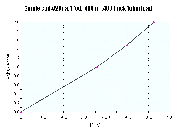

Jerry this is  the data  it is for just one coil
the data is in AC peak volts , and also Amps because of the 1 Ohm load
Divide peak value by sqrt(2) to get RMS value.
http://www.otherpower.com/images/scimages/2965/jerry_data.jpg
also the data is for a single rotor  , a dual rotor ,with same magnets, will double the values.
say for example at 2v peak = 1.414V RMS   if you multiply The rms value by 3 coils per phase = 4.242V
and multiply 4.24 times sqrt(3) = (7.34V Rms at 625 rpm)
if you multiply the phase current (1.414 A)by the rms Volts (7.34) the little gen should produce about 10.4 Watts at 625 rpm , roughly..
so if used in this configuration your dual rotor will make a nice NiMH battery charger..
Using your rectangular magnets  you would have to change the coil shape of course , but i think everything should fit in your speaker basket generator..

How many turns in the coil?
« Last Edit: December 06, 2005, 08:18:08 AM by ghurd »
Re: E-Car update.
« Reply #14 on: December 06, 2005, 06:43:39 PM »
there are about 91 turns.
its a pretty thick coil 0.462"  width
id is .48" , od is about .956
about 19 feet of #20 ga. wire is about .19ohms
