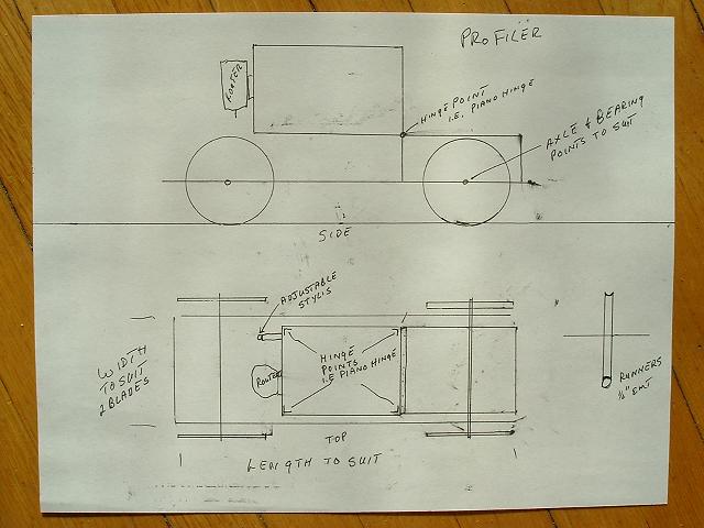

I don't know where to put this sooooo i'll stick it here.
I saw something like this a long time ago, I think it was at a gunsmith shop.
Made large enough it should copy rotor blades very uniformly.
Don't know if anyone has done something like this before.
the box that the router and stylis mounts on MUST BE KEPT SQUARE, the wheels have to be the same size, the work surface has to be flat.
to use, clamp the piece to be coppied in the stylis section, put blank under router,gotta have center lines for both, the wheels have to run on some kind of rails, ie. tubeing , wood, just keep it straight.
with the copy box corners hinged you get side to side, rear bottom hinge lets it rise and fall, stylis keeps everything uniform, what ya put in should be what ya should get out (demensoin wise)
Frank

  Hi Frank,
   Yes, I brought this up, some time ago -- had thought about building one, and affering to loan it to members of this forum !!
   BUT, never got around to building it, and My thoughts are --
     Unless you plan to build "many" blades -- the time spent building the "copy machine", you would have a set of blades built !!
    Again though, I helped build one many years ago, and it really worked great to rough out nearly identical blades, every time !!
    The plans are available on Ebay, in the aircraft section !!   Bill H......

It really works the same way as my duplicator on my wood lathe does. Wouldnt not thing it would be too hard to build.

No wheels. You're just introducing the possibility of sawdust/chips getting under the wheels and lifting the ... car ... thing.
T-Track would probably be simplest. Pretty cheap too.
« Last Edit: December 09, 2005, 09:31:49 AM by Chagrin »

I was worried about that too when I build mine I'll use 2x2x1/4" angle iron standing up (L), I have 12 bearings (5/16 ID x 3/4 OD From a flea market - $2.00 for all), I'll use 3 on each corner of the caridge, One to ride on top and one on each side to keep the top one inplace. As the edge of the angle is rounded the sawdust should'nt hang up there (with the vibrations iduced into the unit by the cutting edge of the router). If it does a side grinder can be used to dress up the edge like this ^ to make the foot print area smaller.
I had thought of using pipe and C shaped rollers. But don't have a lathe to make rollers with, and the foot print is a lot wider.
Will also mount a shopvac hose as close as posible to router bit to keep sawdust from flying around so much.
