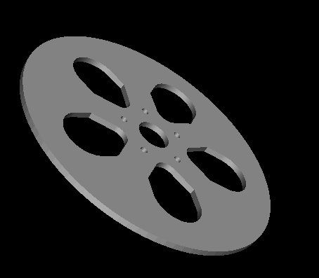

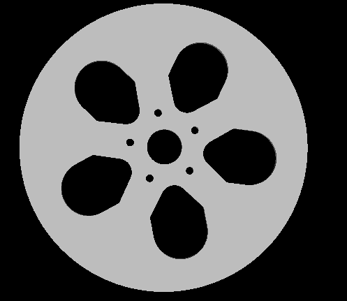

i've done some more design work on my ultimate gen rotors ..they are 21.359 " dia..
maybe i'm just dreaming here , maybe not, i've ordered the wire and know where i can get a hub /spindle , anyone know how much it would cost to machine two rotors of the stated dia?? using plate steel about 7/16 thick.?
http://www.otherpower.com/images/scimages/2965/New_rotor.bmp
http://www.otherpower.com/images/scimages/2965/rotor_1.bmp

 you might be able to get someone to waterjet or plasma cut those for a reasonable price.
but to machine those with conventional (or even CNC) machines will take a big machine; and time on those doesn't come cheap.  if you can supply the program, it'll be a little cheaper, but the guys that own the machine will still want to charge you to check your code before they run it. . . . downtime and repairs on those suckers is a killer for jobshops trying to compete with the far east.
  maybe check the kind of shop that does custom wheel fab?  the machines that make 22" billet wheels could knock those rotors out pretty fast.
I could probably manage to cut the OD with the manual equipment available to me, but those cutouts would be a pain. (extra setups)  Round cutouts would be simpler to cut on a manual machine.
yours are pretty, though. . .
(7/16 / 11mm  seems a little thin for a disk thats going to be carrying a heavy axial load at the rim . . .)

i'll try looking for a custom wheel place ..Thats what i was thinking , using a waterjet machine.you maybe right about the 7/16 dimension. 1/2 " may be better.

Definitely water jet.
If have access to Autocad, (looks like you are using some type of cad to draw your pics) providing you can make dxf files with the program you can save a little bit of $$.
Locally here I can do up a design and email it to the shop. They use the dxf file directly in the waterjet machine. It has software for cutting paths etc.
Sending the dxf cuts down the machine shop's time and that can save you some money.

well my machine shop charged me $100 for a plain 24' dia. 1/4" thick steel disk!  So it could $300+ easy
