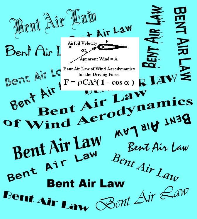

The fun of this little branching off from the rest of wind energy is that it is something that is making tracks. The "new" in "Newtonian" is apt. The physical limitations of wind energy devices are, to be honest, more about the blades than they are about the rest of them since, once working, attention always focuses on the rotors as a way of gaining more performance. Usually it is then too late to do anything about them. I always liked the PVC pipe blades and other blades of this general design but how is it possible to make these blades longer than just a foot or two and yet capable of standing up to strong winds? Answers to this are scarce.
Here is the "Bent Air Law" of wind energy aerodynamics:
Makes a nice T-shirt iron on transfer. Better, perhaps?, than "I'm with STUPID" or even images of rock stars. Pretty girls would be quite curious as to what the heck this is all about and the times are favoring interest in energy. This formula is readily derivable from Newtonian principles and the best thing about it is that it still needs more of everyone's input. The constant "C" needs to be found for different blade designs and it also needs to be extended to the entire lengths of blades by means of digital software. As it stands it is general in scope for every blade segment everywhere.
The apparent wind vector, A, like the wind seen by the sails of a sailboat, is deflected to point back in the direction of the trailing edge. In going around this corner the wind remains at the same velocity but creates a force on the blade, a part of which, F, points in the forward direction as shown. The blade and the sailboat are moving. When the wind velocity is viewed from the standing-still position in the air or water, the wind velocity is seen to be having been reduced, not to zero, but reduced to a smaller value. No drag of any kind or vortex generators or anything else are needed. The wind is slowed and, as it is slowed, it gives up a part of its kinetic energy to the blade or sail, propelling them forward even if they are moving faster than the wind.
More detailed talk about how this works can be found on the www.integener.com website in the chapters on the home page and in the booklet mentioned, available for free as a special deal if anyone seeing this so requests a copy! A contribution of 99 cents for using PayPal as a help for doing this and for the mailing costs is welcomed. If anyone wants to help in making up the T-shirt transfers, that is welcomed also.
Anthony "Knucks" Chessick

« Reply #7 on: January 01, 2006, 03:57:07 PM »
This follows up what was said earlier in my posts above on the "Bent Air Law" about the wind flow having been reduced in velocity after deflection by the blade.
Naturally the question is "what is the new, lower velocity?" The answer is that the wind velocity after deflection by the blade is reduced to a value equal to the apparent wind velocity approaching the leading edge of the blade minus the velocity of the blade moving forward as shown in the graphic, i.e. (A - V). For a blade velocity, V, of zero, i.e. when the rotor is not moving, this reduces to the original wind flow velocity, W, but the wind has turned a corner to flow at right angles to move parallel to the trailing edge. In this case plenty of force is seen by the blade from the wind turning this corner but the wind's kinetic energy remains intact and no energy is converted nor is any work done on the blade.
When the blade is moving at a high speed this vector difference between the apparent airflow velocity, A, and the blade velocity, V, diminishes and so the resulting velocity after deflection is reduced to a low value. It is never equal to zero but can become quite close to it and in such cases for all practical purposes the kinetic energy of the wind is almost all transferred to the blade.
The strangeness of all this and being able to say with such assurance that the airflow is this or that comes about because it is based on physical laws that relate to it, in this case, Newton's Law. Why must the world continue to be left in a mind haze about how aerodynamic forces are generated when deductive reasoning such as this from known science can be so readily made available?

« Reply #8 on: January 02, 2006, 09:33:39 AM »
So, you're coming around.  No one is saying you can't use Newtonian Mechanics.  But if you do, you need to make an honest effort, and that includes using Newton's Calculus.  As you like to point out, the velocity of a mass is a vector quantity.  The time rate of change of the velocity is the acceleration and is itself a vector quantity.  This is the acceleration you need in your force equation.  The acceleration vector can point in any direction in space depending on the forces involved.  As such, it can be resolved in a component at right angles to the velocity vector and a component parallel to the velocity vector.  The component at right angles to the velocity does not change the magnitude of the velocity.  If that were the only component of the acceleration it would mean the energy of the mass would not change (0.5xMxV^2 doesn't change; V is the magnitude of the velocity vector).  Only the direction of the velocity vector would change.  The component of acceleration parallel to the velocity vector causes the mass to either speed up or slow down and is what allows energy to be added to or extracted from the mass.  In the case of an air flow which is distributed in space you need to break the air flow into small units of mass and consider how each one contributes to the overall effect.  You need to integrate all these little effects over the entire air mass.  You have a great deal of work to do.
As far as your "bent air" equation is concerned, your coefficient C is conceptually the same as the lift coefficient Cl, as it must be determined for each air foil.  The equation itself describes the "average" behavior of the airfoil, and you hope C will prove to be a constant over some useful range of angles just as Cl is.  In fact, this is beginning to look more and more like the lift equation rehashed.  I wouldn't be surprised if your C was related to Cl by a constant multiplier.  Deductive reasoning?  When it leads right back to where we already are?
In the real world an integral part of the behavior of air foils involves drag.  You don't consider it.  Not doing so means any results you obtain will overstate the efficiency of the systems.
« Last Edit: January 02, 2006, 09:33:39 AM by finnsawyer »
finnsawyer
  • Posts: 1565
Re: Newtonian Mechanics Of Wind Energy
« Reply #9 on: January 03, 2006, 09:07:22 AM »
I took another look at his equation.  His force is not the lift force but is shown opposite to the drag force.  So, C is related to the drag coefficient Cd?  Well, not quite.  Drag is pretty much constant over a small range of the angle he calls alpha.  The problem is that 1 - cos(alpha) goes as (alpha)^2 for small values of alpha.  In other words his force goes to zero dead on, which is is not supported by physical evidence.  It's time to put this "theory" in the garbage bin where it belongs.
« Last Edit: January 03, 2006, 09:07:22 AM by finnsawyer »

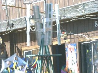

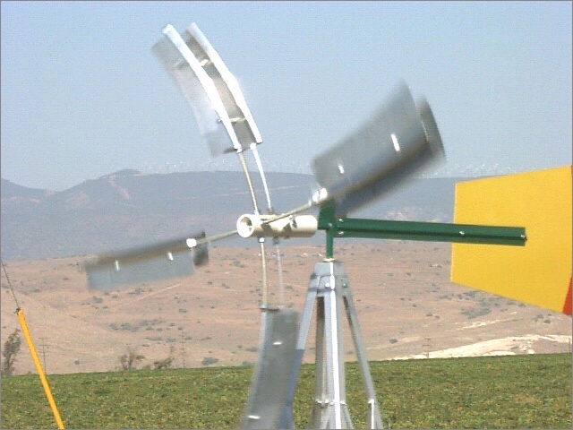

« Reply #10 on: January 03, 2006, 11:44:59 AM »
This belated reply to the question of "showing something that works" is probably going to meet further skepticism. Suffice it to say that I am convinced of the need for a better understanding of how wind turbine blades interact with the wind and that is all that matters to me. I write my words slowly and they are invariably read quickly, requiring much patience on my part, surely something needing tolerance in return. Here is a closer view of the same wind rotator shown on my website:
The blades here are seen as twisted due to their speed of rotation and are nothing but insubstantial sheet metal, doubled and offset so as to assist the Coanda Effect in gaining additional airflow deflection, with a long, flat trailing edge pitched to zero, even slightly negative. No one has been able yet to tell me what NACA profile this is nor why it isn't susceptible to stalling.
There is always the 30 page booklet on the Lift Principle mentioned on my website, offered specially right here and right now for free upon sending an e-mail message with an address for the mailing of it, even outside the States. (The address information is deleted from our files upon completion of the shipment.) It is a good start in seeing the Newtonian Principle as described in some detail and really quite worth while. No need to click on the PayPal button but send off your message soon.
See comments made elsewhere on this thread and also on the recent "How to avoid stalling" thread for more detail. It is not so difficult to understand that it is airflow deflection and only airflow deflection that creates a driving force on a blade moving faster than the wind and made amenable to calculation with straightforward equations such as the Bent Air Law (as is described in some detail in the booklet mentioned above).
Does anyone need to see how I clamp the aluminum sheet metal pieces from the 4 inch (100 mm.) wide rolls of roof flashing in the hardware store to a counter edge corner and back it with a 5/16" diameter wooden dowel in order to start the bending of the leading edge? It isn't fair (and often quite persnickety) to tell me that I am doing something wrong when what I am doing works so well!
Thin blades for lift-based rotors rule!

Re: William James and Essays on Pragmatism
« Reply #11 on: January 03, 2006, 11:50:17 AM »
Anthony;
I do like the look of those.
However;
I made some PVC blades that spun like crazy in the slightest breeze, very fast and smooth. Right up until you attempted to extract any power.
I see you only have these on a "bearing". Have you tried pulling any power from them yet?
« Last Edit: January 03, 2006, 11:50:17 AM by TomW »

« Reply #12 on: January 03, 2006, 08:23:56 PM »
The purpose of this work is to apply for a state grant from the energy commission and no one seems to want to commit themselves quite yet to calling this is a bummer. It is easier to put a generator on a verticals device and so this has been done (see below). The blades are of the same ultra-thin, sail-like, doubled, and offset design. The one has been used to reconfigure the other with good results for both. I pursue this with great vigor. For 10 mph winds and above (measured with a Kestrel 2000 hand held wind meter) the three phase 3.5" diameter axial flux generator mounted on it just below the platform lights the LED lights. It also has enough power and startup torque for me to consider connecting instead a small 6 watt bicycle generator that I have to the shaft without mechanical advantage.
Within the context of 3 foot diameter blades near ground level the above horizontals rotor certainly outperforms the well known 22" diameter decorative old time farm windmill rotors we often see here in the yards of homes with their 12 blades.
I think all this speaks for itself, something that satisfies small needs for power that people find easy and inexpensive to buy.
