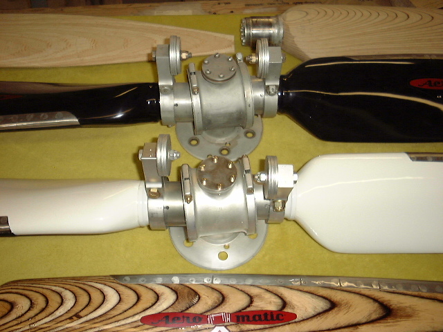

i've been thinking about the furling process.
When it gets really windy the blades of a generator furl out of direct exposure to the wind.
What if we could use a pitch control system , to provide a constant RPM for our generators??
When it is really windy we could increase the pitch out to almost a feathering position , when it is not so windy we could decrease the pitch down to a normal setting.
If pitch control is good enough for airplanes it might be good enough for us..
In place of the hydraulic system, could be a lead screw connected to a servo to change the pitch of the blades..
As the piston moves in and out ,the pitch of the  blades ,increases or decreases.

Pitch control works fine but it requires excellent engineering to be reliable.
If you have the facilities and ability, go for it, but don't attempt a backyard engineered solution.
I see no advantage of the electric servo over direct centrifugal weight control that others use and if you use the servo approach be sure to incorporate a furling mechanism to protect things when the servo fails ( as it will one day).
I have started 3 pitch control mechanisms but only ever finished and tried one.That was a small one and worked fine.
The others were for larger blades and ended up becoming so heavy that I never finished them. Here we never get the sort of winds that would make it worthwhile and a properly designed furling scheme still produces good power in high winds, although a pitch control would do even better.
A badly engineered pitch control will be a disaster but if you can do it properly then there is no better.

These use centrifugal weight control , but there was no internal diagram of how they worked, so i did'nt include them in the origional post.

Flux i would really like to see a picture of your centrifugal weight pitch control mechanism ?
