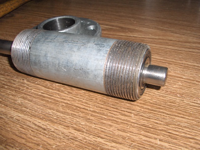

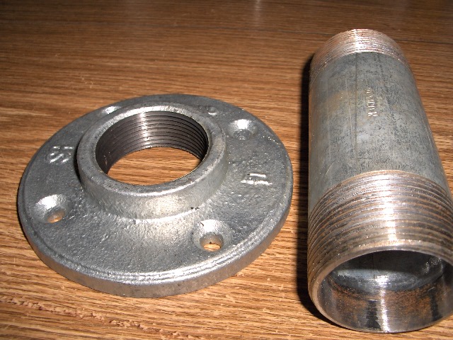

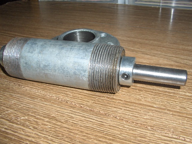

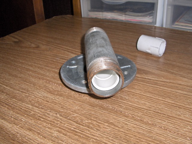

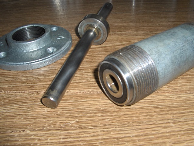

This is a 6" pice of 1.5" Galv. pipe. I've used a dremmel to make the ID accept a bearings. The flange part will hold the stator mounting plate.
« Last Edit: January 08, 2006, 04:10:31 AM by (unknown) »
OK more pix.
« Reply #1 on: January 07, 2006, 09:17:10 PM »
This pix shows the plastic pipe inserts used to keep the bearings in there place, a spacer.

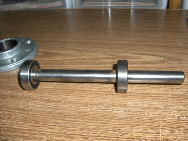

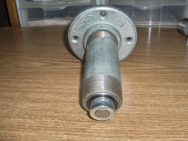

This is the shaft and its bearings.
This is a bearing partialy inserted into the pipe.
« Last Edit: January 07, 2006, 09:17:10 PM by Jerry »
Re: OK more pix.
« Reply #2 on: January 07, 2006, 09:26:19 PM »
This is the shaft and bearings installed into the pipe.
This is the front shaft collar installed. Theres 1 on the rear also. These collars keep the shaft secure and in the right position.

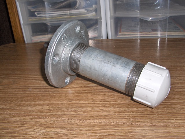

This is the rear shaft collar and stator mounting flange installed.
This is a plastic cap. It keeps the rear bearing dry.

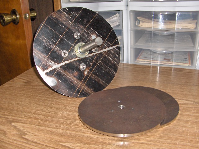

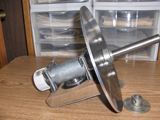

So far in all of the above pix the only tools used were a dremell and an alin rench.

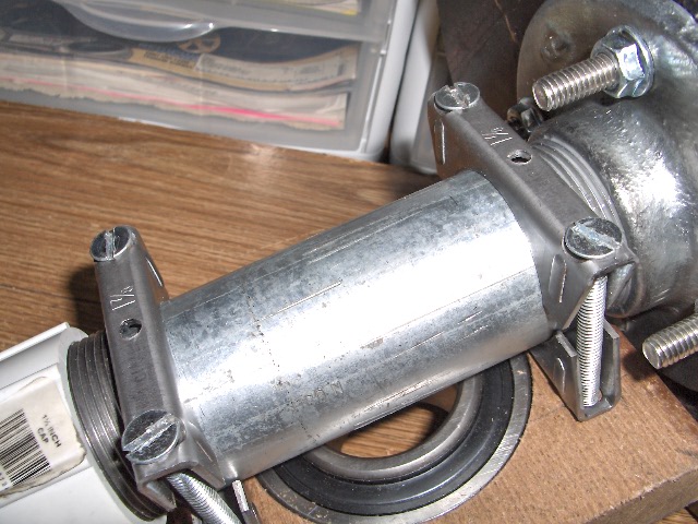

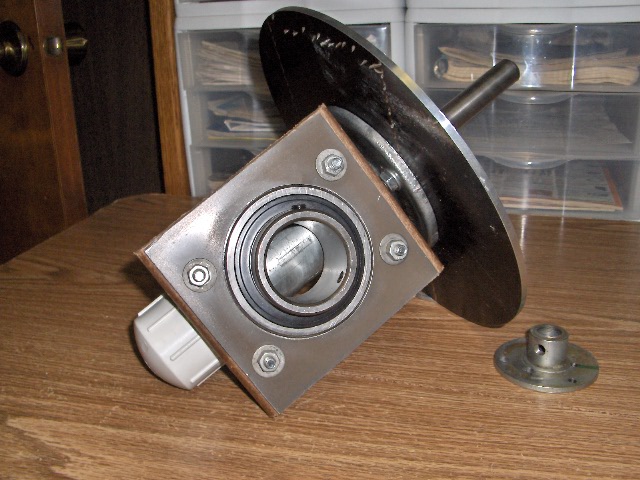

After some further assembly. The yaw bearing and stator mounting plate. Small muffler clamps were used to hold the pipe assembly to the yaw bearing.
This is the yaw bearing. No furling on this genny.
This is the stator mounting plate. It doesn't look it but it is 1/4". It just has an ugly coating of powder coat of somthing that didn't want to come off. Also the 8" steel discs 1/4" thick. I'll shine the up befor I install the magnets.
The littel hole in the muffler clamps are for the tail wing boom. It will be bolted on top of these clamps.
Thats all the pix for now. I have started the stator. I have more work to do on the magnet disc also.

« Reply #4 on: January 07, 2006, 09:53:29 PM »
A couple notes. After everthing is cut, drilled and sized the unit will get a good coat of paint to keep the rust down. The yaw bearing mounting board it that composition plastic wood. Weather has no effect on it and it will last forever.

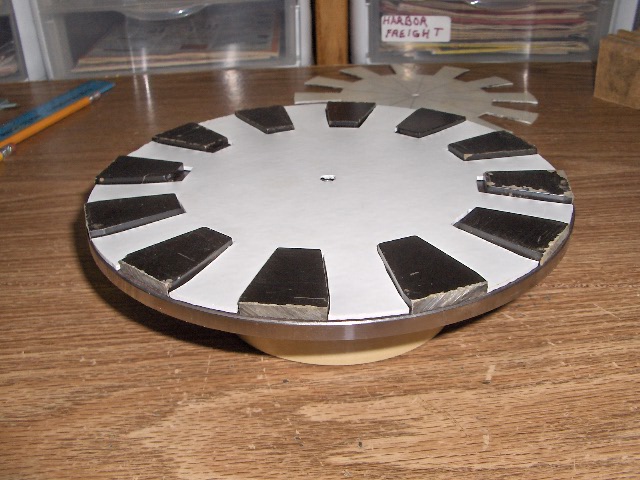

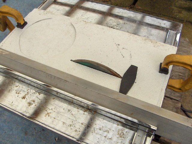

A few more pix. Stuff I did today.

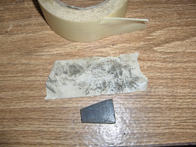

This is the $59 Harbor Freight wet tile saw. I had to space the magnet away from the steel table with a few sheets of shower fiberglass panel stuff. The magnets didn't want to slide on the saws steel deck.

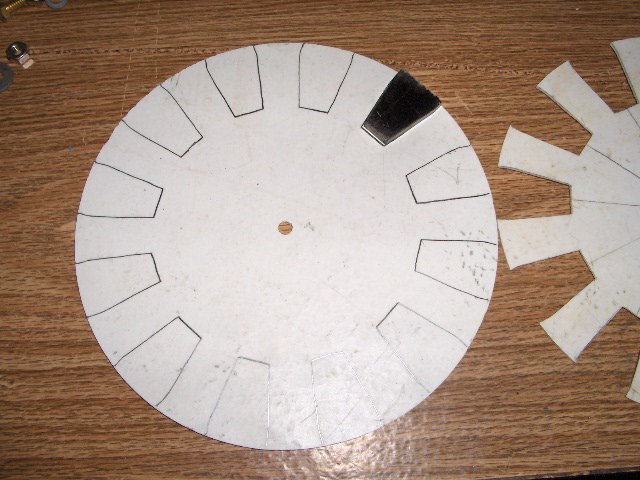

Here the coffin shaped NEO is cut.
Its easy to clean the magnet chunks and dust of the magnet with duct tape.
Magnet templates and 1 magnet.
Magnets on 8" steel disc with templates.
« Last Edit: January 08, 2006, 08:36:06 PM by Jerry »
Re: New dual rotor project.
« Reply #12 on: January 08, 2006, 08:56:24 PM »
After cutting the magnets some of the paint chipped of. These magnets are cheap $1 each.
A littel more work on the discs then build the coil winder form. The actul magnet size after cutting 9/16"X 1"&1/16"X 3/16" thick. The coils will be small for a littel magnet like this. Because of this I'll be using the same 20 or 22ga. wire I used on the Lowes dual rotor. That worked quite well.
